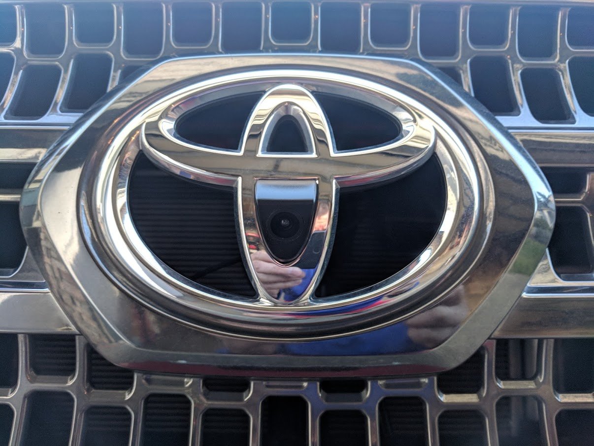

    I had some daylight and the Taco was in the driveway, so I had a chance to snap some pics of the front camera:
    It sticks out a more than I would like and I wish it would point downward a bit more as I do not have any bumper in the view. But, I really like it otherwise.

    Which camera is that? I got a regular round bullet cam and I can't make it work w angles etc. Im thinking about ditching it and going to a mirror box for the AV in haha

    It is the one from this post:
    https://www.tacomaworld.com/threads...-smartphone-mirr.501617/page-10#post-16496915
    I was a bit nervy before I ordered because the grille pic showed a different camera shape in what I assumed was a Camry, and I guessed the Taco logo would be larger. But, the width (22mm) and height (25mm) shown in the last pic on Amazon matched the opening.
    Later today, I will post a pic of the view on the head unit. It is a great camera, esp in motion as there is no jittering in the image. But, no part of the bumper shows up. I need to get a ruler at bumper / license plate height and see how close the bottom is.
    Also, there is no fish eye to the lens. All lines in the camera view appear straight. I would have liked a bit of fish eye, but again, I am satisfied enough as is.
    The camera is noted to be IP67, but I did squeeze some RTV in rear wiring hole just in case and around the connector that had to be in the engine bay due to length. There is not enough of a pig tail to get it into the cab. Thankfully, the mating side was just long enough to get through the grommet.

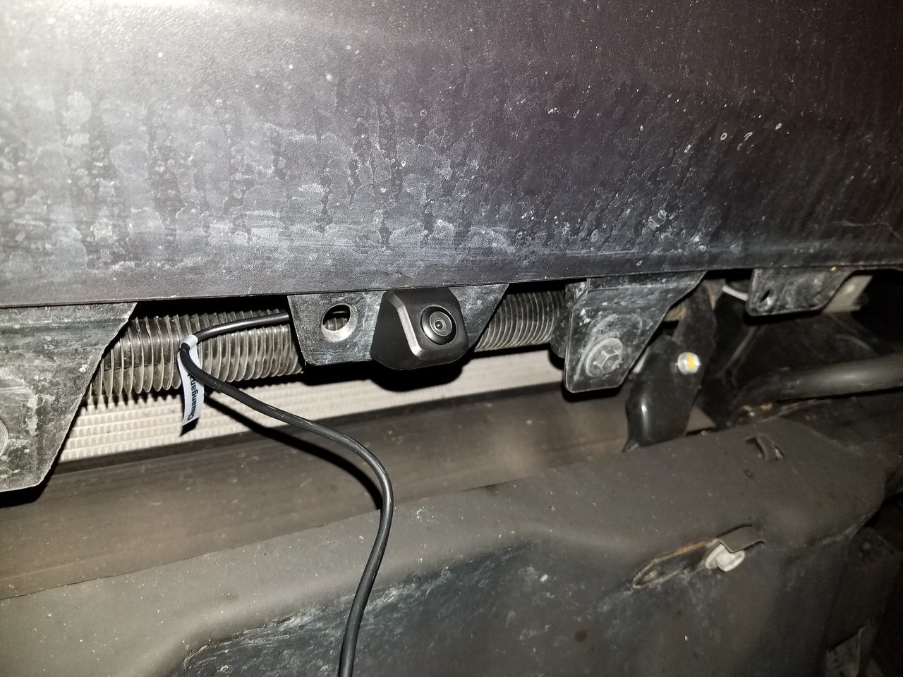

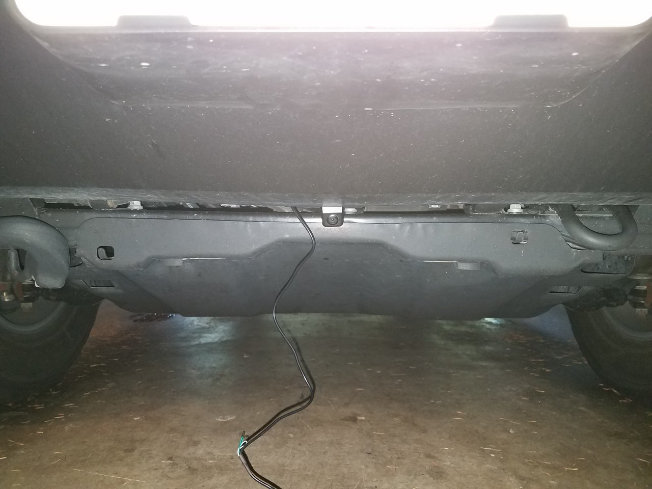

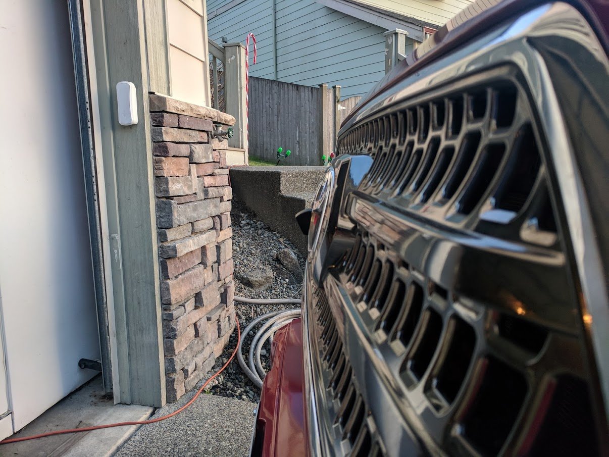

    Here some pics.
    This gives a good view of a car ahead:
    The ruler shows a bit less than 4in to the license plate:
    This is to the right side of the lower valance:
    Need moar fish eye. Hahaha!

    Dang that's crazy. It looks like it's aimed down so much too

    IMHO, down is good. Needs a bit more down or fisheye. The spec sheet says 170deg view angle. I think 190 or so would do it.
