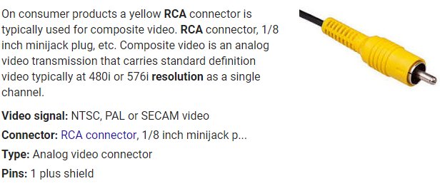

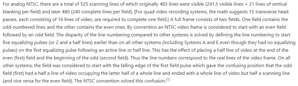

    What resolution does the media player do anyway?
    I went through the thread and didn't see anyone mentioning it. Does RCA have a max ability? I saw something about 576i
    CAMERA OPTIONS
    1. This one does 1080x720 - https://amzn.to/2EOdvyc
    2. While this one has nice controls and is 976 X 592- https://amzn.to/2EQShQ9
    3. But this is the one everyone seems to get - https://amzn.to/2JUB2Bv
    "it is maximum Pixels 1280*720, and effective 960*576 pixels at 25 fps"
    I think the one with options (#2) is cool if it's not gonna be any better picture quality.

    The camera sensor IS...the method of transmission (RCA Composite/Yellow) IS NOT. Marketing. Check out their wording once more. You cannot transmit HD over a single video signal. NTSC and PAL are limited. Your Entune screen is not an HD screen. However, the picture will be crisp as you're not doing an HD to Composite down conversion, you're coming straight in, so the video feed WILL be crisp because of the low noise, good processor they're using.
