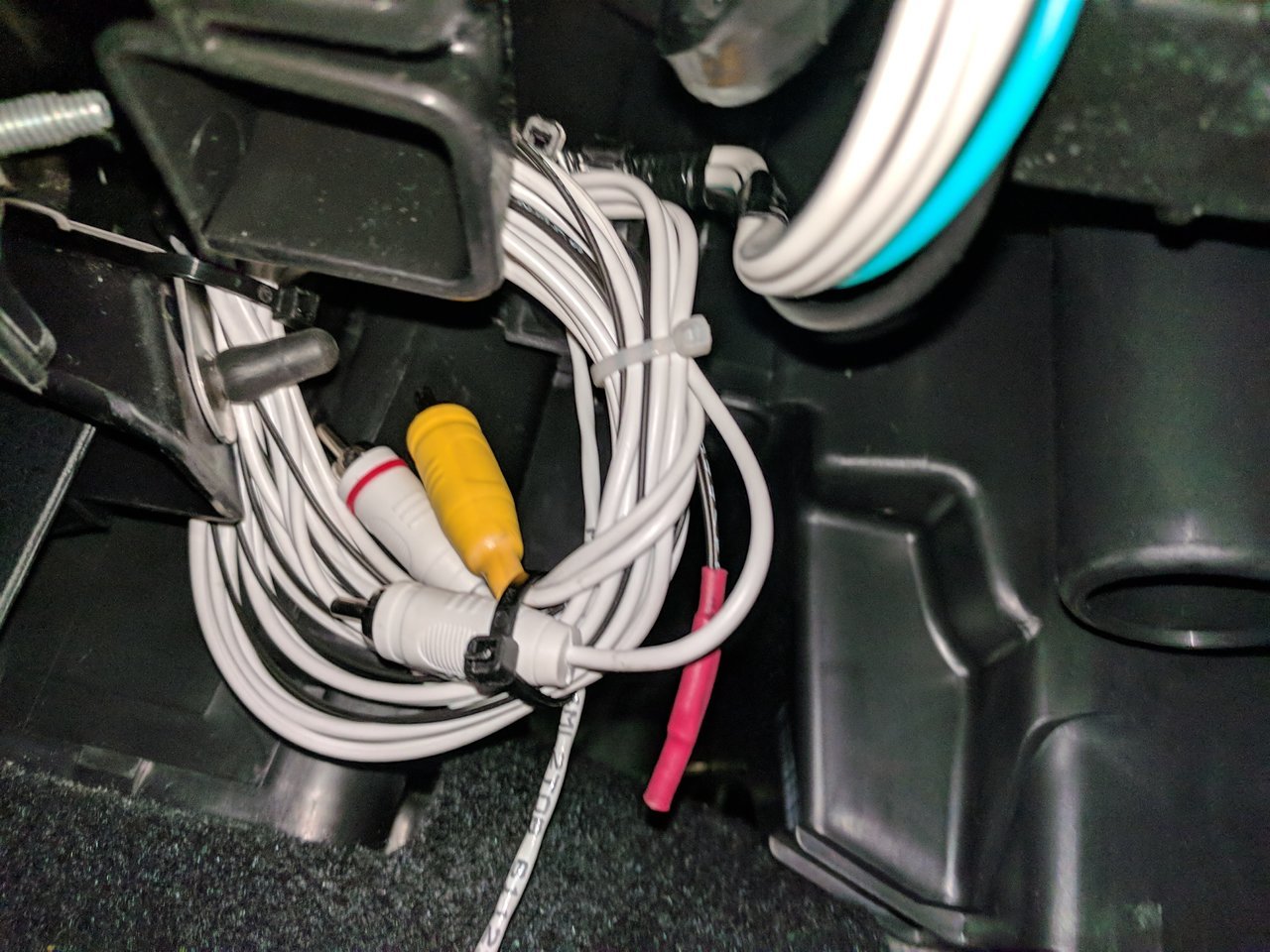

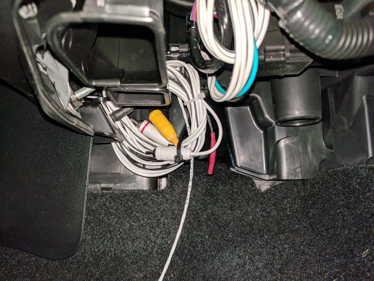

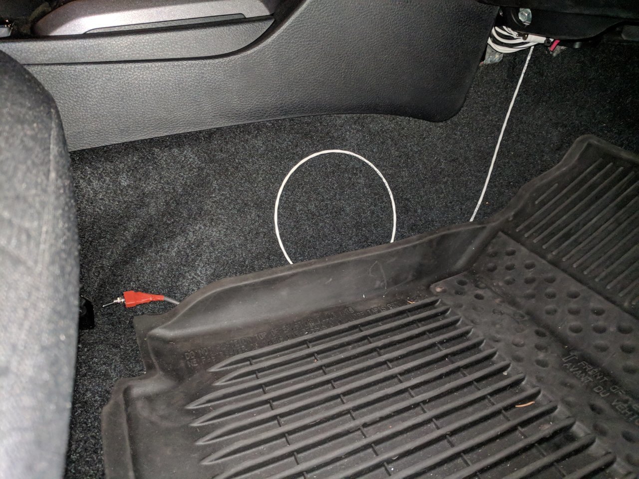

    Here are the pics as I have the cable now.
    The switch:
    I need to route that to a better spot.
    Camera wires stowed:
    They are away from the heater outlet and I put a rubber cap on that screw so that the wires won't chafe.
    I will get more once I get the camera and switch.

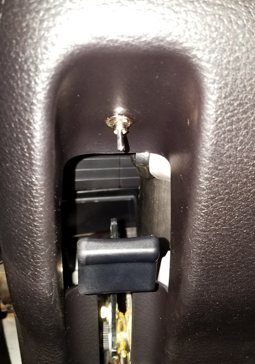

    Some observations after driving with the cable installed.
    • With the override switch flipped, the GPS Nav screen and the Compass in the gauge cluster no longer update.
    • With the rear camera turned on, the Compass in the gauge cluster no longer updates.
    • It takes 20 seconds or so for the GPS to figure out where you are and update after you turn off the camera or turn the override switch off.
    These are minor inconveniences for the functionality added by this mod. My next step is to install the front facing camera.
    My switch locations:
    taco 16, Hoangde[OP] and tonered like this.

    Great spot for the main switch! Thanks. That is ways easier to get to than the area above the charging mat.
