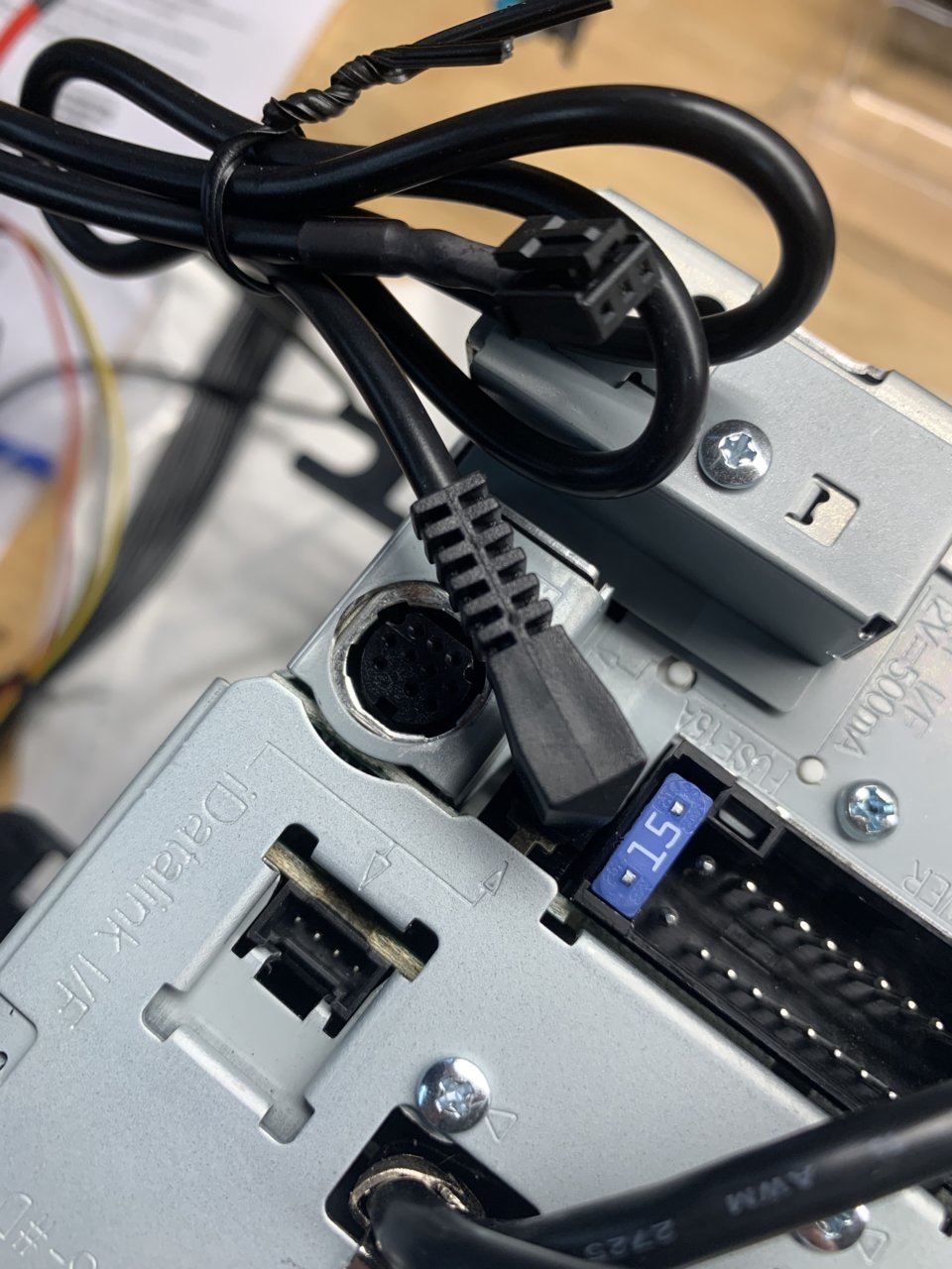

    IndyTac
    IndyTac Well-Known Member
    Jan 29, 2020
    #317607
    334
    Indianapolis
    2019 TRD OR DCSB w/JBL
    Total Chaos bed stiffeners CaliRaised bed tie-downs CaliRaised 0-degree, bolt-on rock sliders Meso Customs Gas Hole JDM console and dash organizer Ceramic front tint Ceramic windshield coating Ziebart underbody and rust proofing Taco Garage Dashtop Multi-Mount (DMM) Black SR5 Grille Surround Swap Tacos4cheap Grille Badge Redarc Tow Pro Liberty Brake Controller Car Solutions Anytime Camera Mod TacoMods Radio Knobs Desert Does It Seat Jackers
    Update: Installed this with the 15 amp in-line fuse on a Kenwood Excelon (OP recommends against this, so I did this at my own risk). Spliced into the red accessory wire from the Kenwood harness. Also spliced in my Germes Lab camera controller interface. I went in the following sequence of connections: OEM wiring > Germes Lab > Tombit > Maestro > Kenwood. After some troubleshooting (Kenwood has a camera override feature that I didn’t know about, which keeps the camera from showing), everything works. Thanks @daveeasa for providing loads of help and for talking through the project and trouble shooting with me.
    Edit: On install, the 15 amp add-a-fuse might have worked if I had trimmed the plastic of Kenwood harness, which covers the head unit fuse. The Maestro connection directly next to the Kenwood harness input is not needed with the Tacomas bc that is for steering wheel controls, and the Maestro’s data cable connection takes care of the steering wheel controls, so that input (a 3.5mm) is not used.

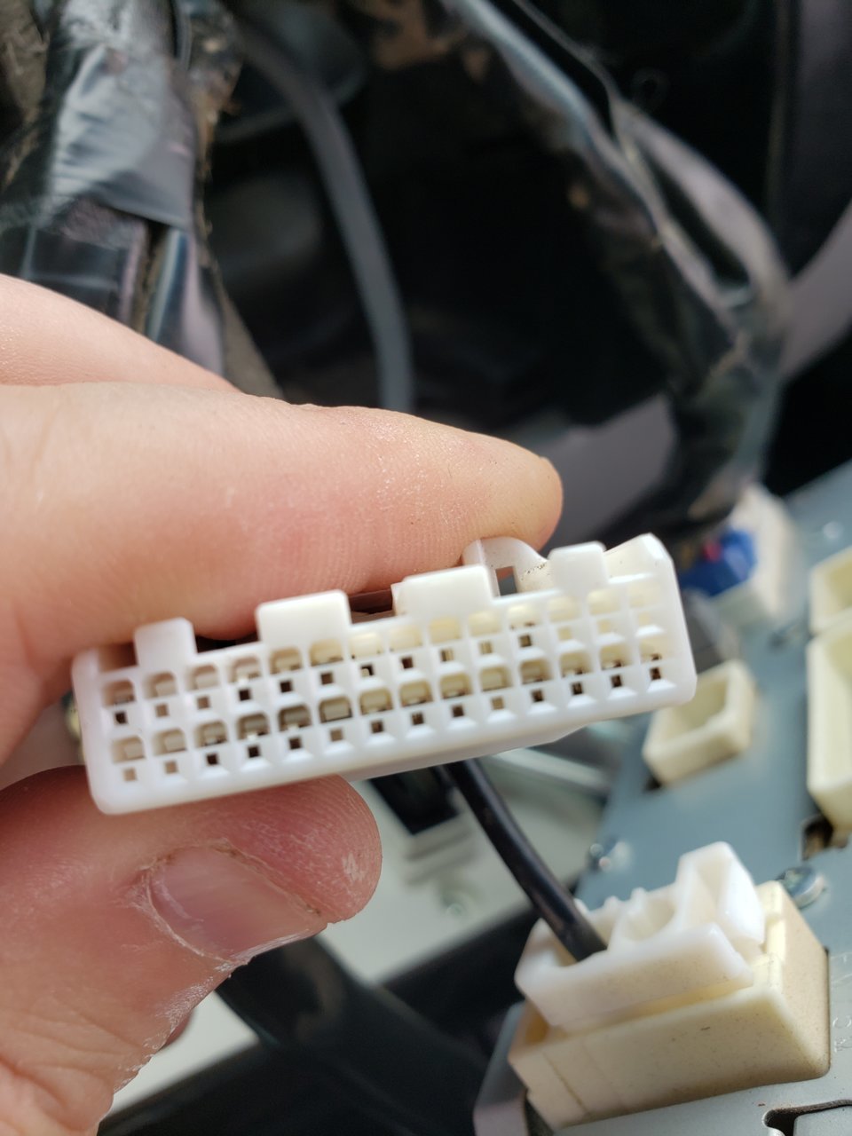

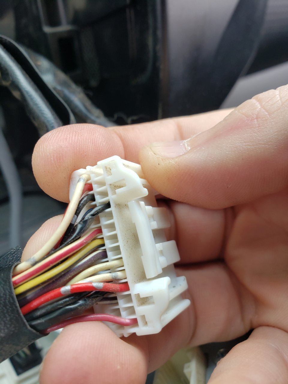

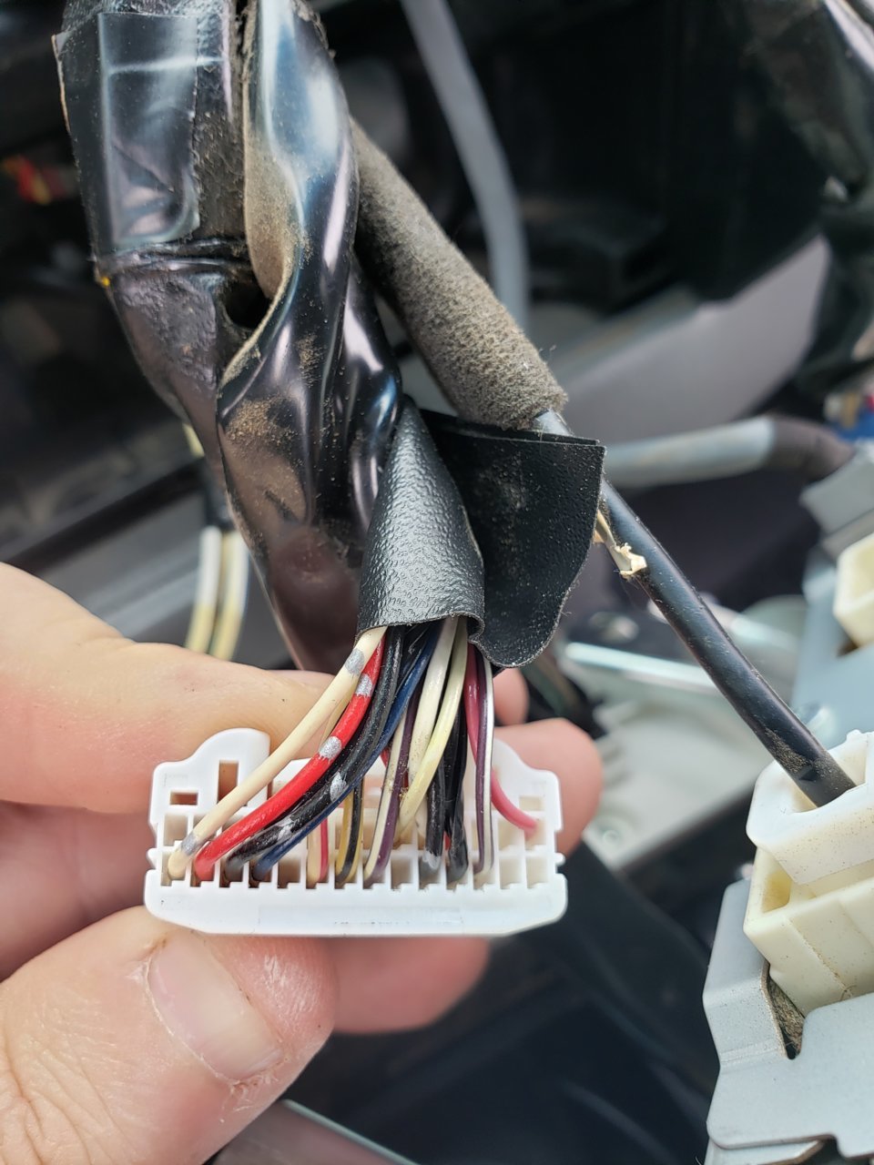

    Hideki
    Hideki New Member
    Jun 20, 2019
    #296955
    3
    Silver 2013 Tacoma Double Cab V6
    Aftermarket Sideskirts, 3inch lift
    @WickedAx I saw this other thread https://www.tacomaworld.com/threads/oem-microphone-wiring.514166/ about a potential solution for a 2nd Gen/2013 that you directed to this thread. I have a 2013 Double Cab and a Joying HU that should be delivered sometime next month.
    I understand that you have your hands full with life as well as getting another batch of adapters out and testing for a 2020+ version, but I would like to buy one of these from you so I can attempt to modify it for use with the 2nd gen harnesses.
    I figure that since condenser mic technology hasn't changed, the same +5v, MIC+, MIC- and DET leads are likely being used between the 2nd and 3rd gen OEM mics and that the major differences are in the harness plugs and their pinouts.
    My intention is to put the right plugs on and test it out and give you the details so maybe you can add a 2nd gen option for those who are interested.
    I would not be asking for any credit or a discount or anything like that, the joy of tinkering and a potentially working OEM mic in my truck are the only rewards I need.
    Are you interested?
    EDIT:
    I decided to do a little detective work. Based on comparisons between post #19 on the thread I linked above and post #3 on the following thread: https://www.tacomaworld.com/threads/2016-stereo-wiring-diagram.429679/ along with my own investigation of my 2013 wiring harness, I think it could very well be compatible already.
    The 2nd gen harness R15 uses pin 4, 5, 6 and 19 for 5V, MIC+, DET(SNS2) and MIC- in that order.
    The 3rd gen harness R31 uses pin 4, 5, 6 and (unknown since the page is cut off, but I suspect it's 19) for 5V, MIC+, DET(SNS2) and presumably MIC- will be the unknown pin.
    Below is my harness, it appears to be the same 28-pin used in 3rd gens and this adaptor.
