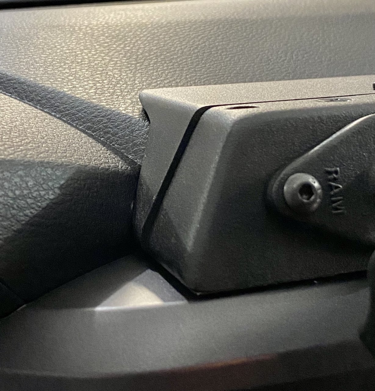

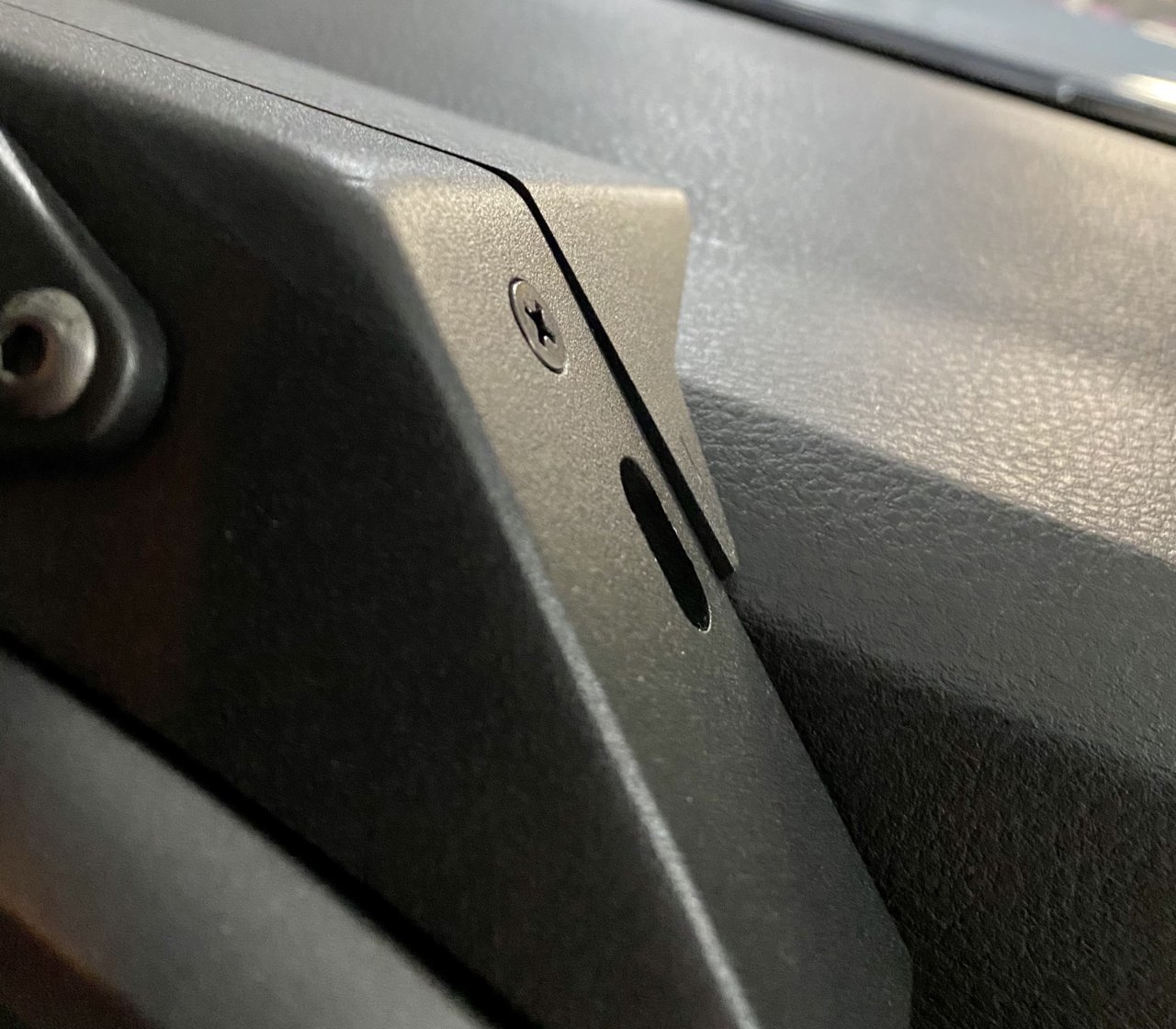

    I recently installed the new version of the 3tpam in my 21 Taco, followed the installation video linked on the Expedition Essentials web site. I ended up in a situation where the wiring cover didn't fit well:
    I tried shifting the wiring cover side to side, but couldn't get it to line up properly. I reached out to Expedition Essentials by email.
    In less than a day my phone rang and it was Jeff. He spent some time talking to me and gave me instructions to fix the fit of the wiring cover. I also called him back with some follow up questions. I ended up with a perfect fit and was very happy with the support I received.
    Here is what I had to do (embarrassed I didn't see it on my own):
    • Remove the wiring cover
    • Loosen the screws on the main body, shift it slightly towards the rear of the Taco. Re-tighten.
    • Slightly bend the ends of the wiring cover down (it's aluminum, just a small tweak. Got out of whack when I tightened it down too far forward)
    • Re-install wiring cover
    Also really liked the Posi-taps included to tap the power. I purchased some extras for future Taco projects.
