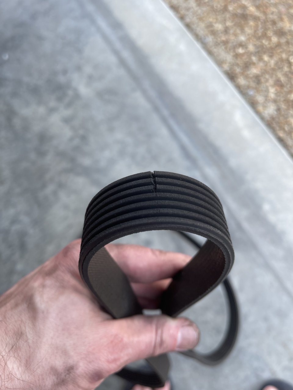

    I found I had 2 chirps going on after replacing my belt yesterday... One was apparently from my belt that had the crack in it, but there's still another chirp that seems to be tied to the A/C compressor. Only chirps intermittently sometimes louder than others when the A/C compressor kicks on and this chirps doesn't seem to be coming from a pulley on the serpentine belt. After seeing some earlier 3rd gens w/ locked engines I'm going to have to dig deeper to see where it's coming from. A/C / fans / truck still seem to be running just fine, just noisy - likely bearing related

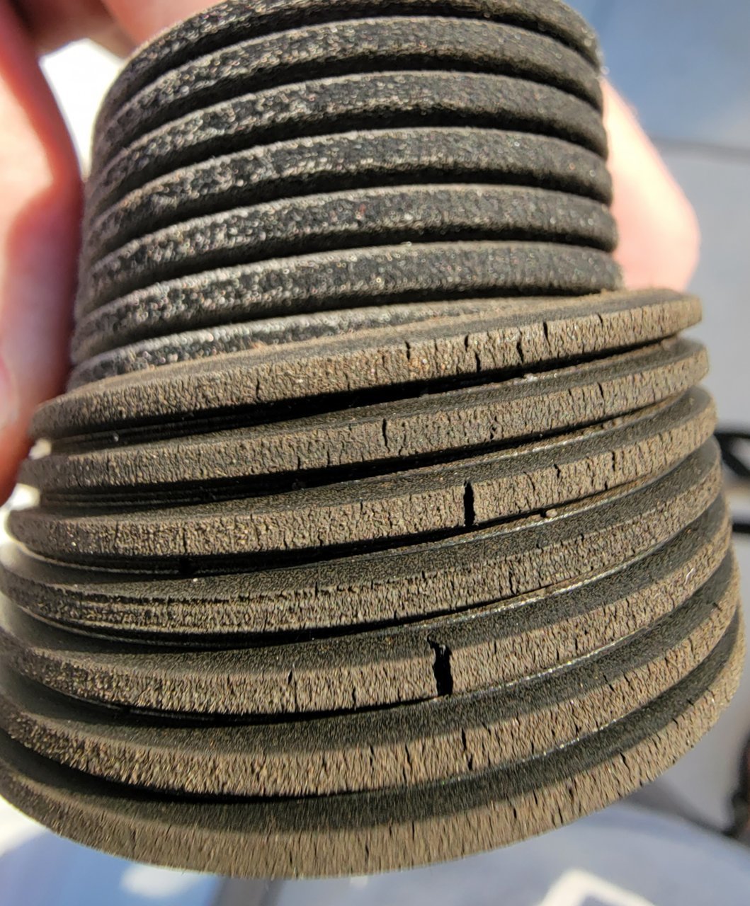

    ~112k hard miles on a 2017. Probably could have gotten a lot more miles out of it but good peace of mind for $45

    Note the old belt has much wider grooves than the new one. That's how modern serpentine belts wear - they lose material and the gripping area with the pulleys is reduced, resulting in less traction.
    Normally I'd recommend replacing the idlers as well, but in this case the lowest idler (most exposed to the environment) is behind the oil cooler, so it's a lot more involved.
