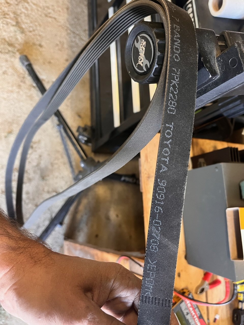

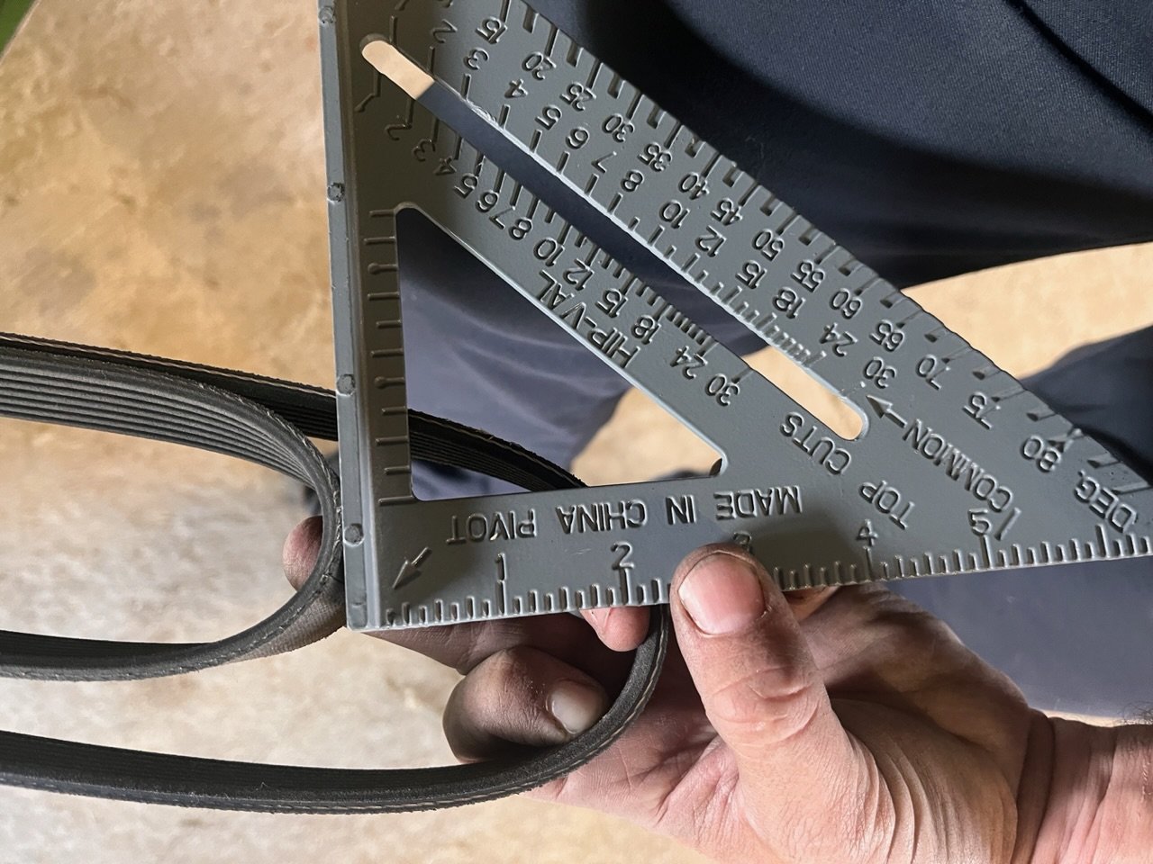

    Well I got my belt changed. Thanks OP. But not without issue.
    the dealership gave me part number “Bando 7PK2280 TOYOTA 90916-02707” and it’s about 2+ inches longer than the one that came off. I called them and they said it supersedes some older part number and that I had the right part.
    Being the sceptic that I am I went down to Autozone and they gave me a Continental belt Part Number 4070834 and it’s exactly the same size as the original.
    It fired right up and isn’t squeaking anymore. Replaced at 65K on a ‘17 TRD OR because of a squeak that developed after a mud infested trip that had multiple water crossings. I really need a snorkel so I can seal up the underside of the truck but that’s a story for another day… see photos.
    PS. The dealer belt was $80 ish bucks. The Conti was $34
    Cheers!
