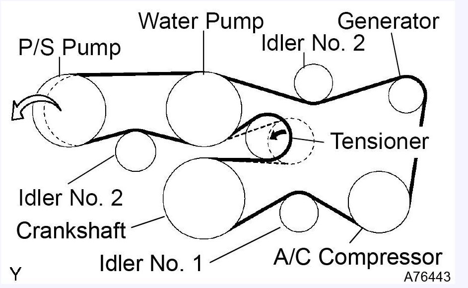

    Thank you OP and everyone else who has replied to this thread. I read every post and knew it would be a challenge to replace given the tight work area. Took me around 1.5 hours and replaced it with an OEM belt (part# 90916-A2037). My truck is 2016 and has 92,000 miles, the original belt was replaced under warranty at 10,000 miles and still looked good so I kept it as an emergency backup.
    I struggled getting the tensioner over enough to get the allen wrench into the keyhole. I managed to put a 1/2" pvc pipe on the end of my ratchet which gave the leverage I needed to finally get the allen wrench in. Keeping the tensioner in place makes routing the belt easier.
    I also removed my skid plate which helped verifying the belt was routed correctly.
    One thing I did initially was route the belt over "Idler No. 2" between the Water Pump & Generator instead of under it. I caught my mistake and had to restart again. Seems like it could be an easy mistake to make so double and triple check your work.

    The diagram shows two "Idler No. 2" locations. The belt goes under the top one and over the bottom one. Kinda confusing, but that's the diagram I used too. :rolleyes:

    Why are there 2 "idler no. 2" on that diagram?
