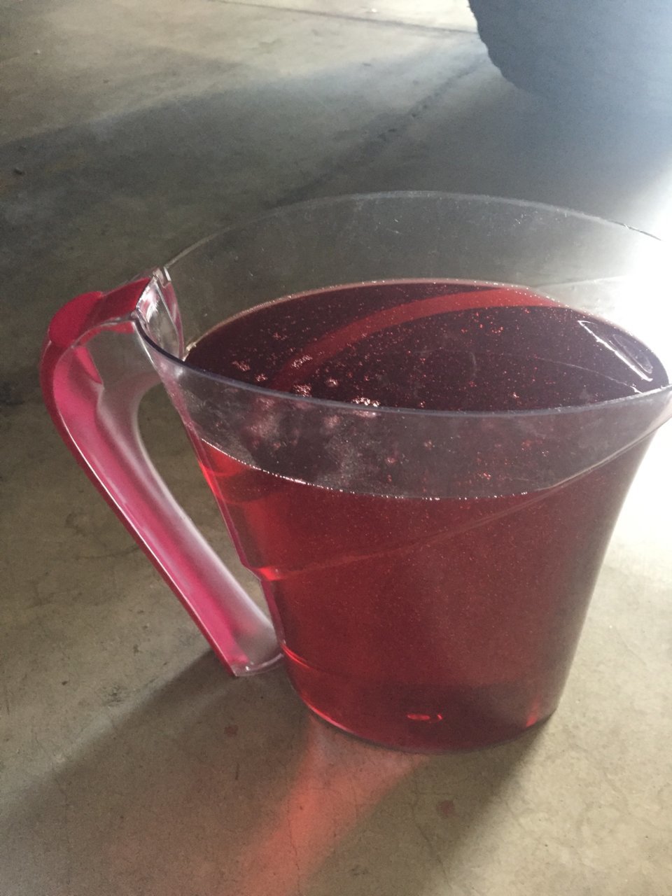

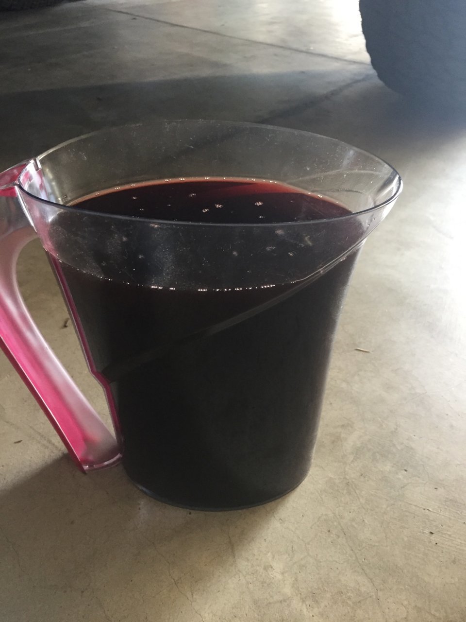

    I switched to Valvoline Maxlife. It shifts well and runs smoothly with no clunks or thunks.
    Old WS fluid looked decent with no burnt smell at only 22,000 miles with some towing, a large aftermarket cooler for the fluid, and the transmission thermostat pinned open.
    Old and new:
    25FDA6A1-3301-4370-833C-DF76FD2EE27B.jpg 3B8E3AD9-D78E-4562-93CD-73A303EBEDF7.jpg

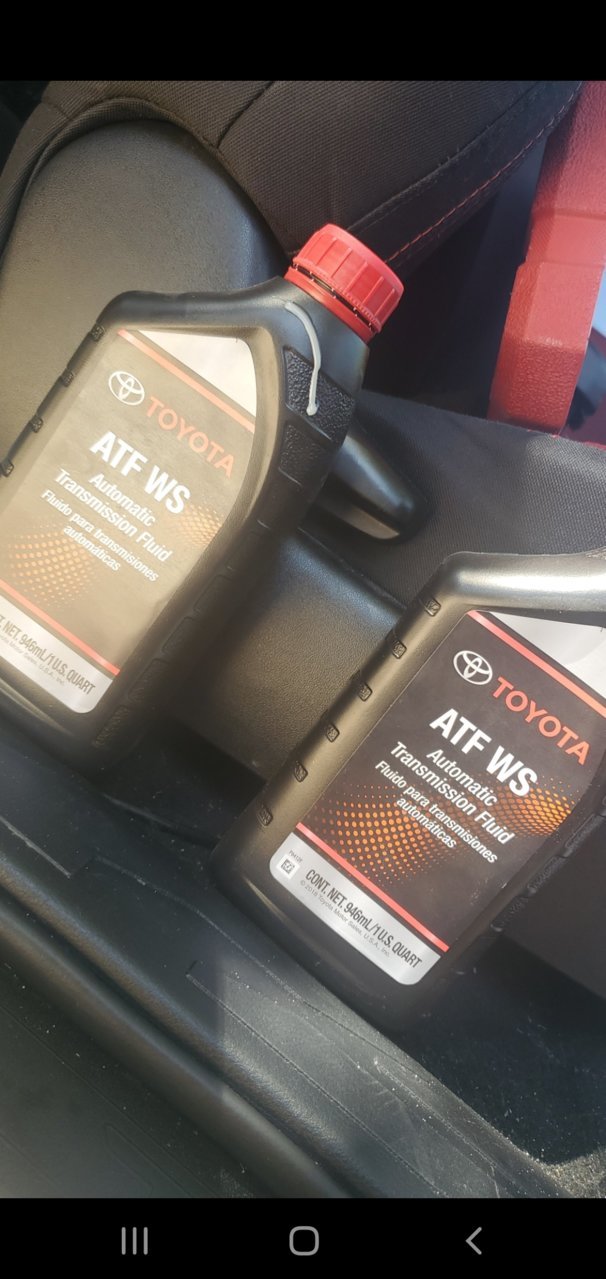

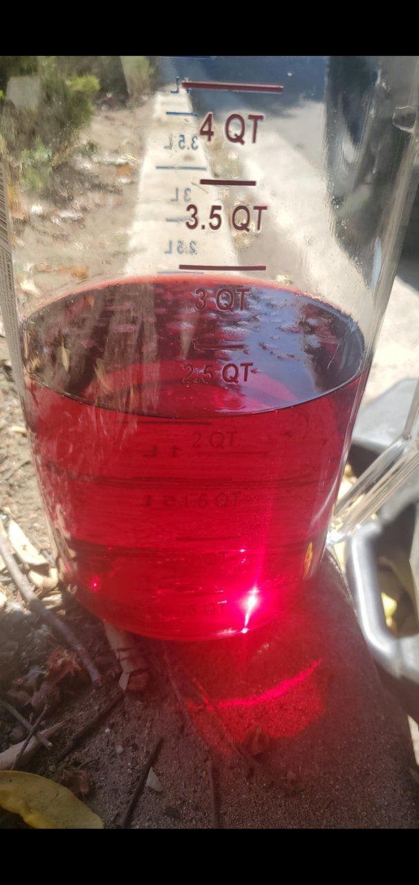

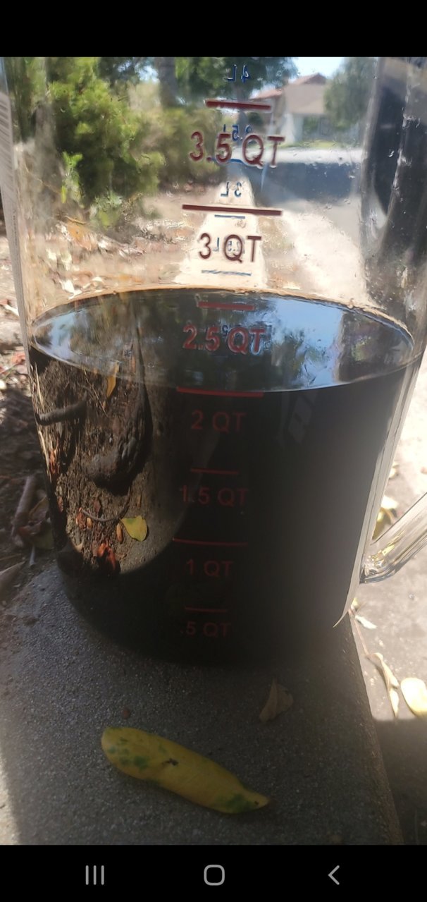

    Screenshot_20200917-103925_Gallery.jpg i7Screenshot_20200917-103918_Gallery.jpg Screenshot_20200917-103933_Gallery.jpg
    I drained the transmission fluid, 2 quarts came out. Filled it back up with 2 quarts of new fluid, then turned it on and shifted through gears then turned it off. Did this 4 times for a total of 8 quartz. Truck runs buttery smooth. Remember to replace the 2 crush washers and o ring. It will leak if you dont replace them. That's what 80,000 miles looks like on the tranny fluid.

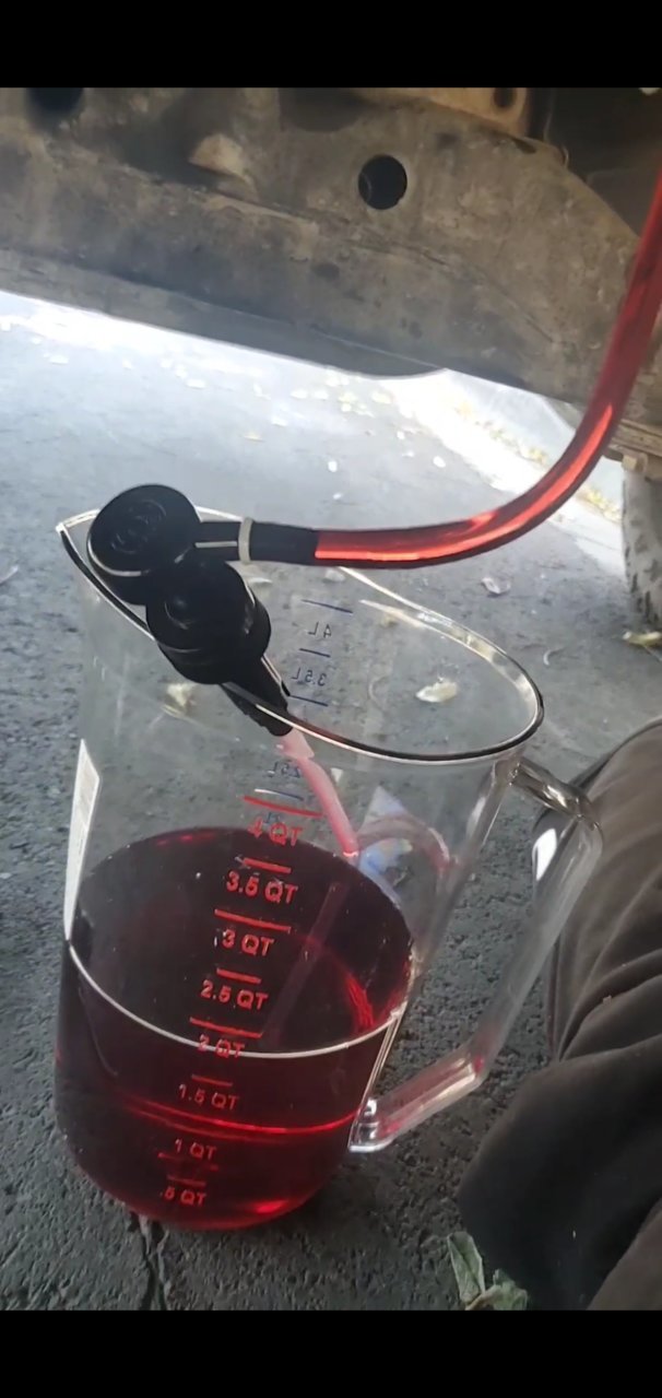

    The fluid pump and quart pitcher can be found on Amazon along with the fluid.
