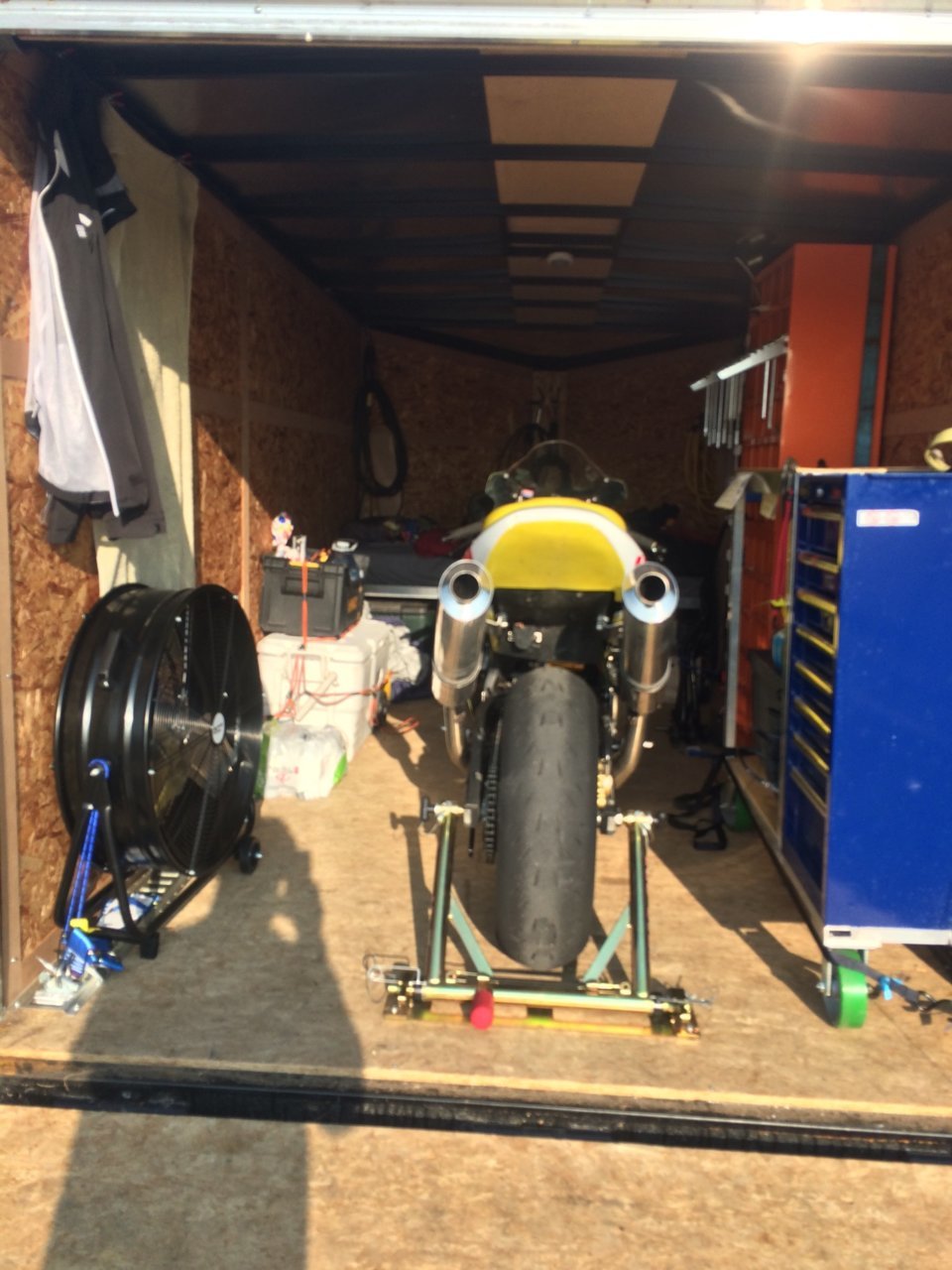

    Mine is a tandem. I haven’t checked to see if both axles have brakes as this isn’t always the case. I know my flatbed tandem has brakes on both axles. As far as dialing in brakes on a single axles vs tandem with brakes on both axles the single axle will be easier with lighter loads. You want to work within a certain load range. Too much braking capacity with a light load means you will always be at the extreme limits. No different than a heavy load with minimal braking capacity. You will always be trying to get it to perform properly yet always out of the “zone”.
    I haul my motorcycle to the racetrack along with my sleeping and camping gear. For the size of the trailer I am always on the lighter side but I have yet to put it on the scale at work to determine the loaded weight.
