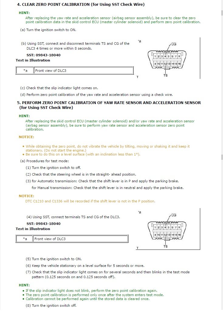

    Does anyone know if the published Gen2 VSC reset procedure works on Gen3. Slip light is on constantly after some beach driving.....

  13. Mar 18, 2018 at 9:40 PM
    #193
    Groovyspuds
    Groovyspuds New Member
    Mar 18, 2018
    #247682
    2
    Well damn, thank you very much! I will give it a go in the morning and post back!
    UPDATE: Worked perfectly on a 2017 4cly
