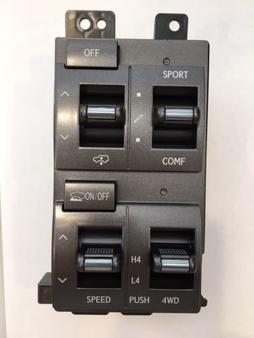

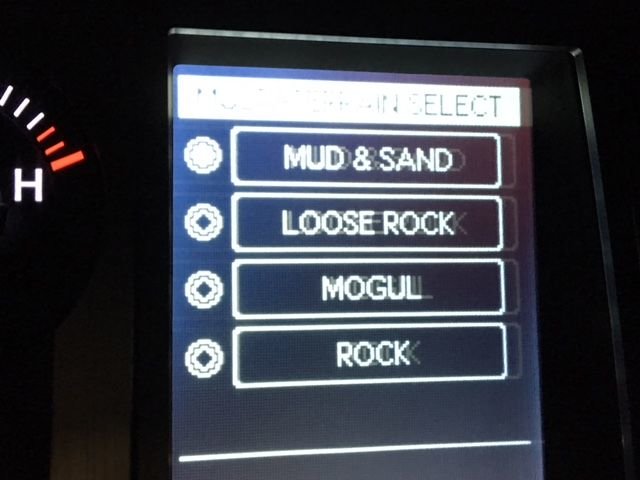

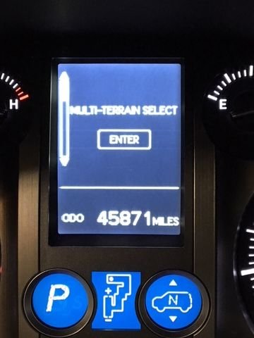

    Guys... great thread. I don't own a Tacoma but just reading about your different traction settings and use.
    I have a '12 GX 460 and last month added crawl and MTS with just a module replacement, a new console switch and zero point calibration for the crawl to go live. All 460's from '10+ at any trim level can be converted with both for less than $500. MTS can actually stand by itself without adding crawl if one wants. The MTS module for '10-'13 runs less than $150 from Japan and the '10-'18 console switch for crawl can run between $275-$350. The '14+ MTS module is around $190. Here is the kicker on crawl... one can probably do that one for $10-$20 in toggle switches. Wiring schematics show just different connections being used. I originally thought skid control ECUs mattered but in the end all 460's have necessary hardware for crawl and MTS to work. MTS is actually only available in Canadian GXs in North America. No 460's sold in US with MTS.
    https://www.clublexus.com/forums/gx-2nd-gen-2010-present/859762-dac-versus-crawl-control.html
    I wonder how hard to convert Tacoma? If ABS actuator... probably a non-starter but food for thought.
    Work is being done on the FJ and certain model 4Runners can be converted.

    So in a few minutes research, it looks like on '12 GX 460 it only comes with hydraulic brake master cylinder. (And the later FJ too I think)
    The Tacoma 3rd gen OR and Pro (which have MTS and Crawl Control or A-TRAC) come with hydraulic brake master cylinder, and all other trims pneumatic. The master cylinder also includes the skid control ECU. So for the Tacoma, a new hydraulic brake master cylinder (and the associated wiring) would PROBABLY be needed.

    BigWhiteTRD: Good info... I wondered what the limitation was. I gleaned a lot of info from Russian Prado threads from a few years back.
    EDIT: The 460's do have "crawl only" as an option but it is on a special order fully loaded top tier model.
