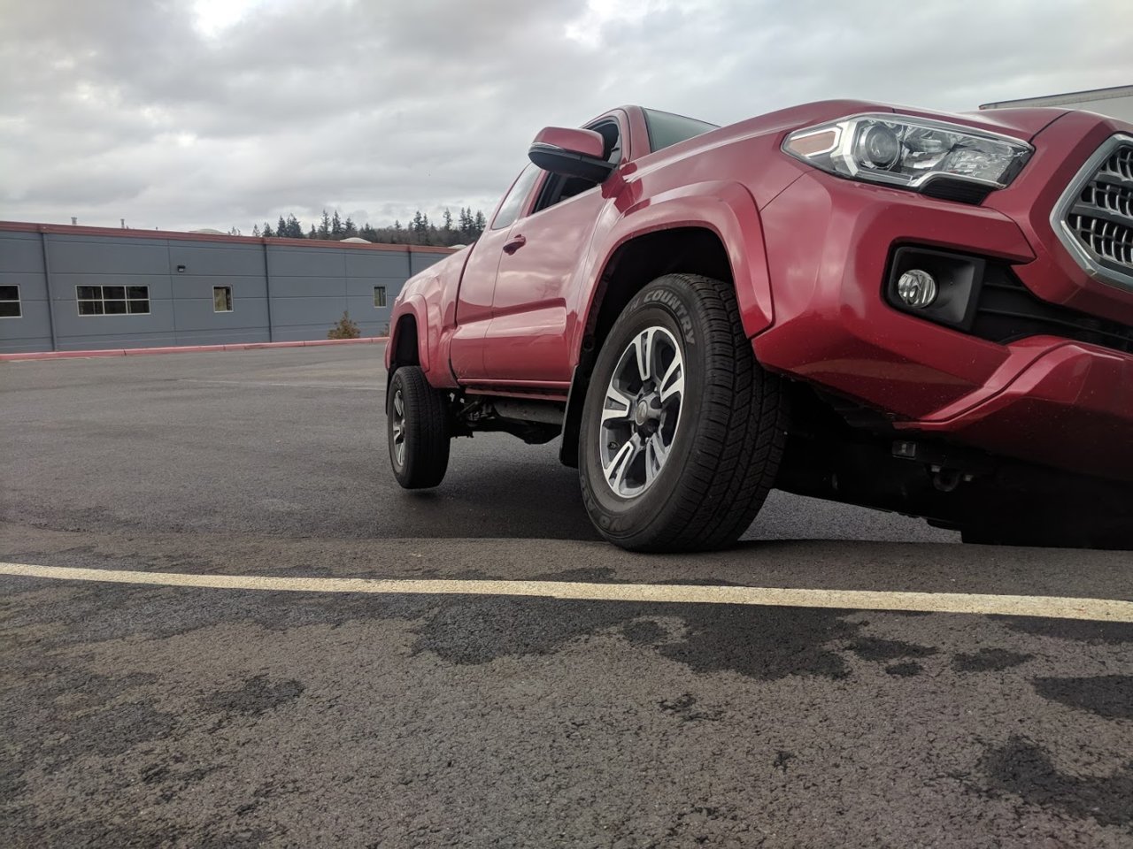

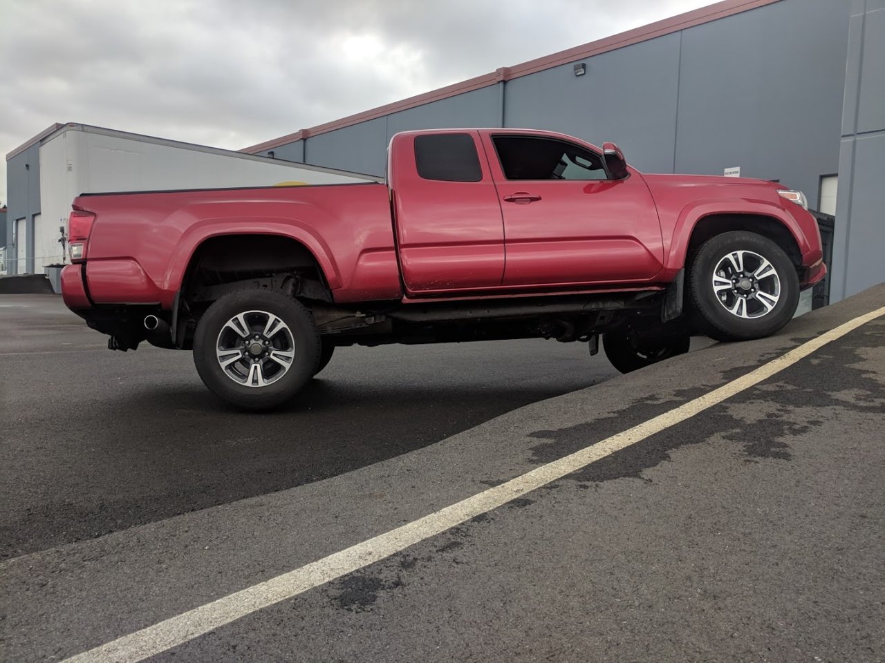

    Very true, but as we have seen in some videos and my own experimentation, the SR / SR5 / Sport / Limited seem to have an upgraded TRAC system also. Still limited by the pressure of the vacuum boost though.
    This took some driving around to find, but all modes other than 2Hi default and TCS Off got me up the side of this dock ramp:
    I think I posted these in the pre-sticky thread. The rear lifts first, but the front was barely one the ground also. Zero issue getting up over the side with just a bit of throttle above idle.
