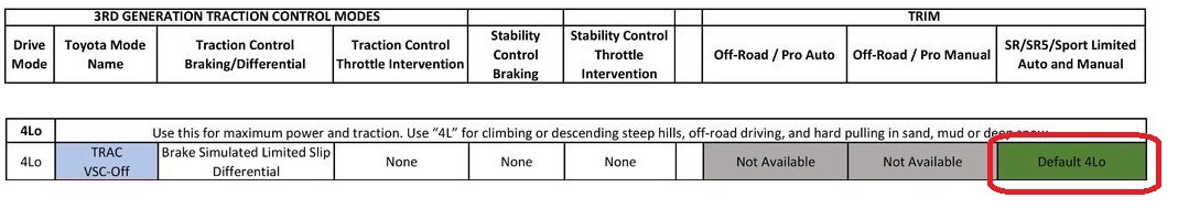

    BigWhiteTRD
    BigWhiteTRD Official thread killer (only crickets remain)
    May 24, 2017
    #219848
    1,673
    Ted
    Treasure/Space Coast Florida
    2017 AC TRD OR Auto 4wd, 2012 AC SR5 4.0 MT 4wd
    The results observed by @PB FAB matches what we had previously found precisely and is represented in the spreadsheets. In fact I believe the PB FAB actually contributed to the data we have. On the SR, in 4Lo the default behavior (no button presses) is:
    TRAC ON, VSC OFF
    (you wont see any lights for the TRAC ON on the dash, until the system decides to react).
    You get the VSC OFF to indicate that stability control is off. Stability Control is separate from the Traction Control
    When TRAC operates you get the squiggly.
    The VSC OFF light is 'squiggly' with an 'OFF'
    Note, TRAC operates with the standard vacuum brake booster.

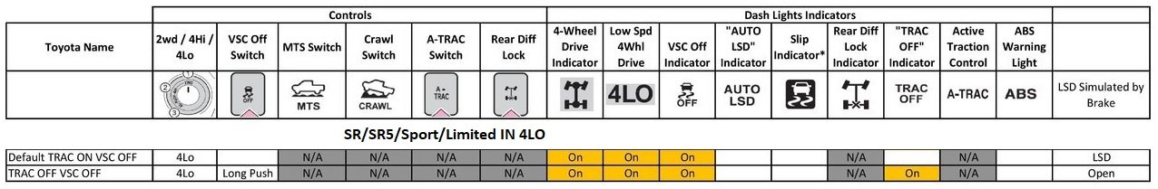

    There are (2) options for the SR/SR5/Sport/Limited in 4Lo.
    TRAC ON, VSC OFF (Default)
    TRAC OFF, VSC OFF (Long Press VSC Button)
    Here are the Dash indications you get for the two modes.
    Notice, when the TRAC OFF light is On, then there is NO traction control.
