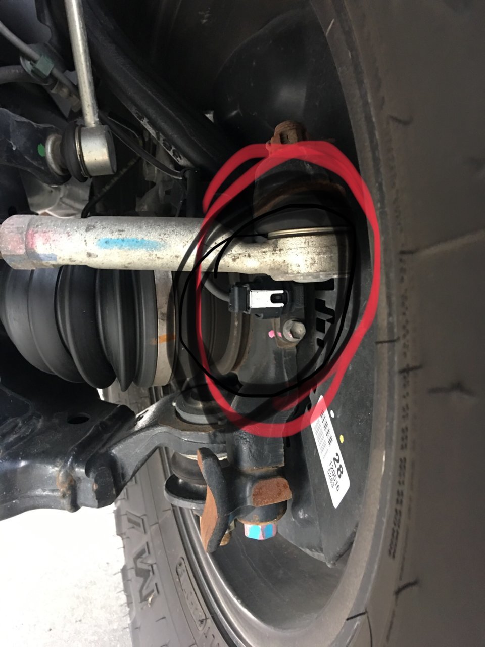

    The systems are voodoo and work well with less abuse to the driveline. I saw it with my own eyes when I was stuck in the same snowy incline as an OR. I was able to work my way out. The OR could not until MTS / CC was engaged. Then, it just walked free effortlessly.
    Also, there are a couple companies that make shields for the ABS sensors. If you can't find the threads, lemme know and I will see if I can dig them up.

    I’ve since purchased SDHQ’s ABS guards. However, the funny thing was that the ABS itself wasn’t damaged, it was the wiring harness. The dealer said it was pulled out of its socket.
    OK, so would I use MTS and/or CRAWL instead of the locker while off-road?
