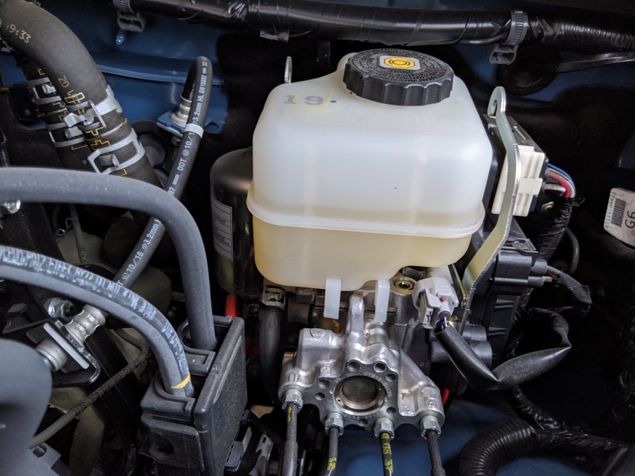

    Is this the hydraulic boosted brake for my '19 OR 4x4 MT?

    Yes, it is the electro-hydraulic brake master that is on the OR and Pro tacoma currently
    rubiconjp[QUOTED] likes this.

    Makes A-Trac possible!
    rubiconjp likes this.
