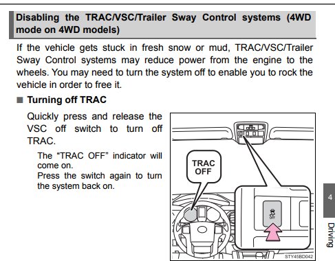

    It's TRAC and yes it is very good at doing it's job. These systems have indeed become very advanced in the last few decades. The system as a whole is on par with ABS in terms of driving assist systems. Stability and Traction control, if not already, may become mandatory for all manufactured vehicles just like ABS did.

    I don't necessarily disagree with your logic. Is what it is though. I would trade that mode for 4Hi ALSD that operates the same as 2Hi ALSD but that's not what we got or so everything seems to indicate at this point. By all means, prove us wrong if you can.
    And I'll add that it does make sense if you take it at face value. When you compare it to 4Hi ALSD it maybe leaves a little to be desired.
    The purpose of that mode is explained by Toyota.
    If TRAC is failing to get you out because it's cutting to much power, you turn it off and try to rock the vehicle free with unlimited power open diffs. That makes perfect sense. VSC is not left on to help out. It's left on because there's no reason to turn it off in the above scenario and Toyota would rather you still have it on. If you don't want VSC on you have to stop the vehicle hold the button down and turn everything off.

    BINGO!!
