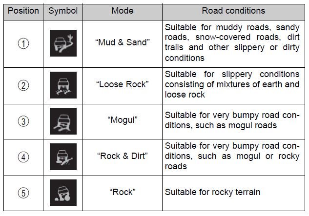

    Ok. But the Manual says MTS can only be operated with Crawl Control OFF. I understand that when in Crawl Control it includes the wheel limiting slip of the brake induced traction control. So in a way Crawl Mode includes the MTS feature. However, MTS alone allows you to select the amount of slip allowed before the brake induced slip control operates. Using the knob there are 5 selectable values. That same knob is essentially the speed control (cruise control if you will) for crawl mode. You can’t actually turn on MTS and Crawl using the 2 push buttons. If I hit one of the buttons , say Crawl, while in MTS, the instrument panel message says that mode is not selectable, I’m almost sure. Have you ever been able to select both MTS and Crawl simulataneosly?

    CC may operate with MTS functionality BUT it must assume some allowed (pre-programmed slip) associated with each speed on the 5 position knob. Again, when in MTS mode the 5 selections proceed from position 1 Mud (allowing much slip before intervening with brakes) To position 5 rocks not permitting much slip before intervening with brakes. When in Crawl mode the selections are just speed with 1 being slowest and 5 being fastest. You can’t select a slip limit (1-5) while in Crawl, only the speed at which you crawl. I’m guessing the permitted slip in Crawl is very low , perhaps the least slip associated with Rock setting (5)? I’m not sure. Seems to me when in crawl there would be very little sip desired.

    ShimStack, I studied this system in February 2016 when I got my TRDOR. My notes say “MTS is adjustable slip version of ATRAC”. I came to the conclusion comparing the Gen 3 Auto Trans version to the Gen 2 with ATRAC. What I am not sure about is how much slip Crawl Mode permits before using brakes to limit wheel spin. As I explained above it is most likely the slip permitted in the Rock setting of MTS (least amount of slip). It has to work on rocks and in mud it would still work. What do you think?

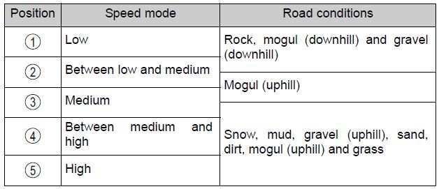

    That I don't know. But if I was forced to guess I'd say CC slip ratio adjusts a little based on speed selection and correlates with the chart in the manual. Notice the CC speed chart correlates to a terrain and those terrains correlate to the MTS settings. This is my guess.

    I would say the Owners Manual implies the Crawl permitted slip is in the reverse order of the MTS selections: In Crawl-Rock it permits low slip which would be the highest MTS setting, In Crawl-Mud/Sand it allows more slip as in the lowest MTS setting. My original comment was referring to the MTS + Crawl reference. After our discussion here, it seems even though you can’t select the MTS button while Crawl selected OR Crawl button while MTS selected, the two are intertwined. When in MTS mode the truck speed is controlled by the transmission selection (D,4,3,2,1) and gas pedal while when in Crawl Mode the truck speed is controlled by the 5 position knob. It appears Crawl has pre-selected permitted slip values in line with conditions described by the MTS/Crawl selection knob.
