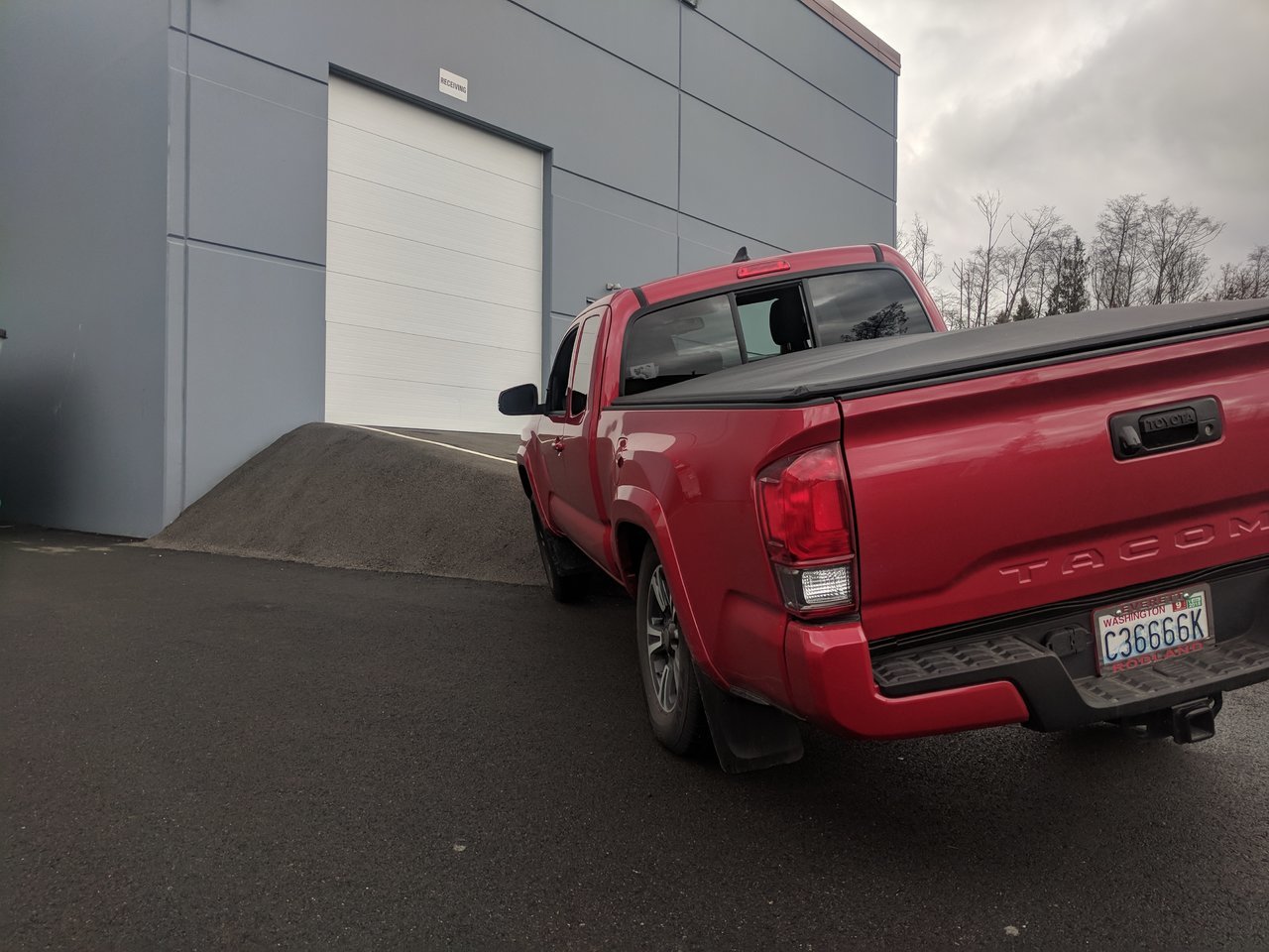

    I finally found a spot to test on a loading dock ramp! It was steeper than ideal and I didn't have a spotter, so I couldn't test any engine limiting inputs.
    I'll post up the updated file in a while .

    I am sorry that I didn't notice earlier. My Sport table was the same as the OR. I have it fixed to agree with what I found.
    Attached is the updated file. @Doggman, can you please update the first post? Thanks!
    When I get a spotter or a good hill climb, I will update it again, esp about any engine limitations.
    BTW, for any locals, here is where I found that dock ramp:
    https://goo.gl/maps/WtyjqJBN1pr
    As noted above, the sides are steep.

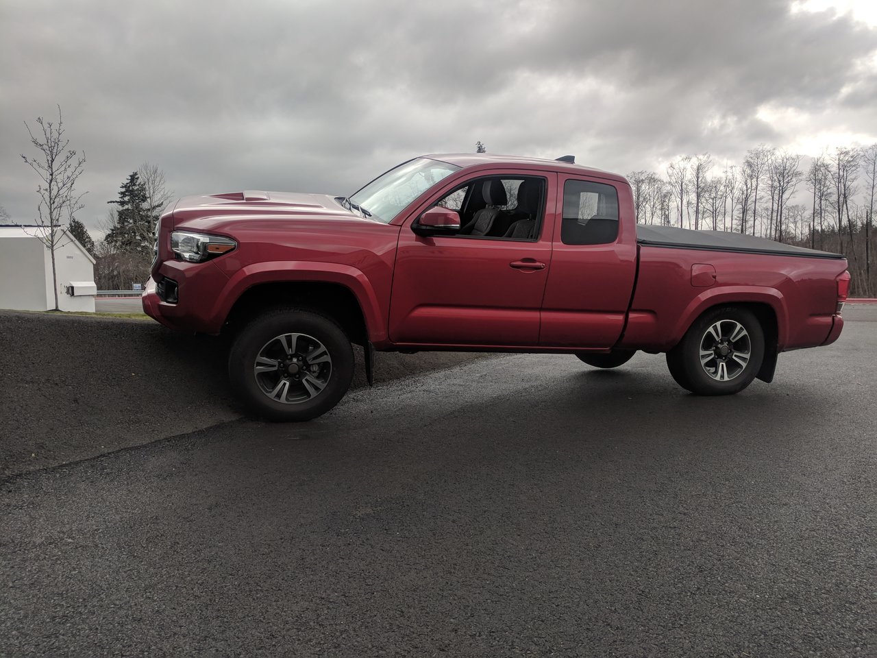

    Here's a pic of the side slope:
    Looks like a bit less than 45deg. I would have liked a shallow 30deg or so to goof off by myself.
