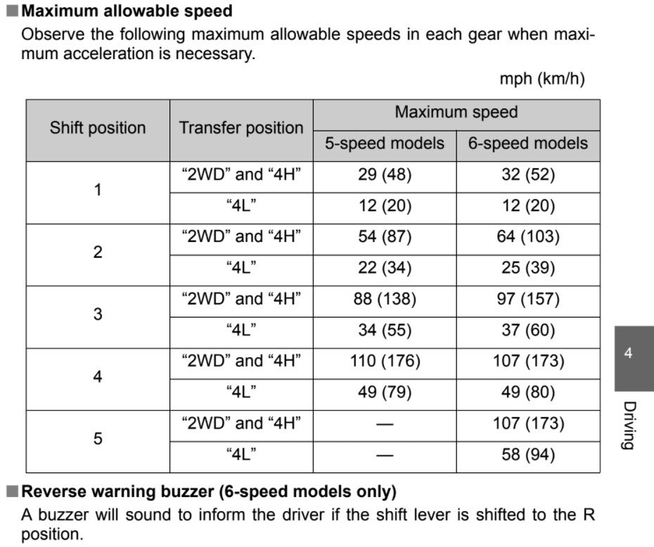

    tonered
    tonered bartheloni
    Sep 25, 2017
    #231055
    31,324
    tony
    Lynnwood, WA
    The OM says 49mph or 58mph depending on transmission:
    I'm not recommending that for either 4Hi or 4Lo, but . . .

  18. Feb 6, 2018 at 1:00 PM
    #158
    PB FAB
    PB FAB Well-Known Member
    Apr 11, 2017
    #215942
    805
    2017 SR DCSB 4x4 v6
    The 107 in 2wd isn’t correct. Speed limited at 114.
  19. Feb 6, 2018 at 1:07 PM
    #159
    tonered
    tonered bartheloni
    Sep 25, 2017
    #231055
    31,324
    tony
    Lynnwood, WA
    Those are the first 4 gears in the 5spd and the first 5 gears in the 6spds (AT and MT).
