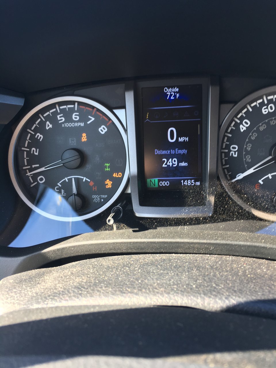

    4LO, no button pushed. What I like about the system is it TRACS beyond the 3mph range. I was about to try 4HI for the full pull up one of the steep hills, but decided to stop right before the top as the moguls were giving me second thoughts. But just like before, I stopped and engaged 4LO. No slip whatsoever. I think 4HI would have done it also.
    I also accidentally went over a somewhat high drop off that I didn’t see. I felt the truck lean big time away from me. I thought I was done and i was totally alone. Not many heads were there. With the right front wheel off the ground, Input it in reverse and gave it some fuel. It moved a bit, heard the skid plate make contact, and all of a sudden it back right up off of it. Damn was I relieved!!! A also got into some deep sand. I’m not skilled in that department, but the system took over and got me out. Nothing but good things so far. Super impressed.
    ‘18 SR5. Did not press VSC button. Same stuff illuminates, minus ALSD. But I’m convinced we have it in 4LO at least.

    I forgot to mention I noticed yesterday that ALSD in 2WD acted the same as 4LO. The back end tightens up big time. Feels like a locker is engaged.

    There is no 3 MPH limit unless you have a locking rear differential and the limit is the A-TRAC being active at the same time... it goes off over 3 mph only if you are also locked... and comes back on under 3 mph (no button pushing). I will guess the MTS is the same if you lock the diff? So, as a rule... don't ever lock the diff until the MTS or A-TRAC is unable to move you... if that ever happens.
