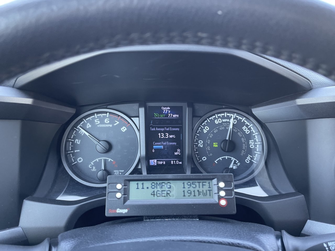

    Agreed. I wish mine was automated, but I just manually turn my fan on w my switch pro when I know it’s gonna be rough on the trans.

    umm how the hell do you only get 13mpg?

    3,000 lb horse trailer as stated in previous posts. I was wondering if someone would ask that question. Over a 1 day 600 mile trip from UT to Central WA, I averaged about 7 mpg. That was the best partial tank average for the whole trip with lots of uphill and head winds.
