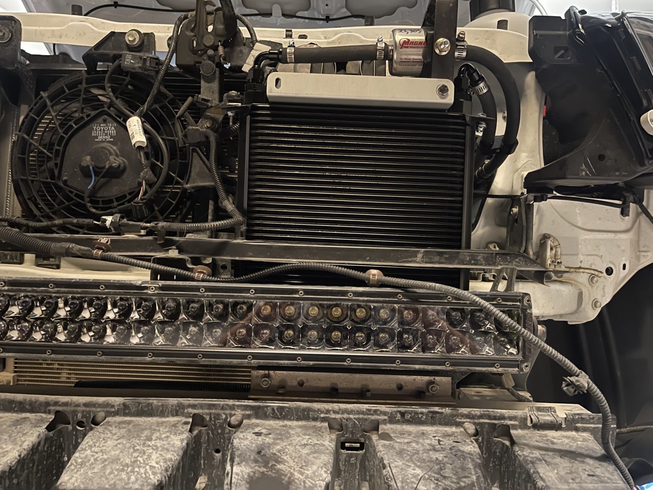

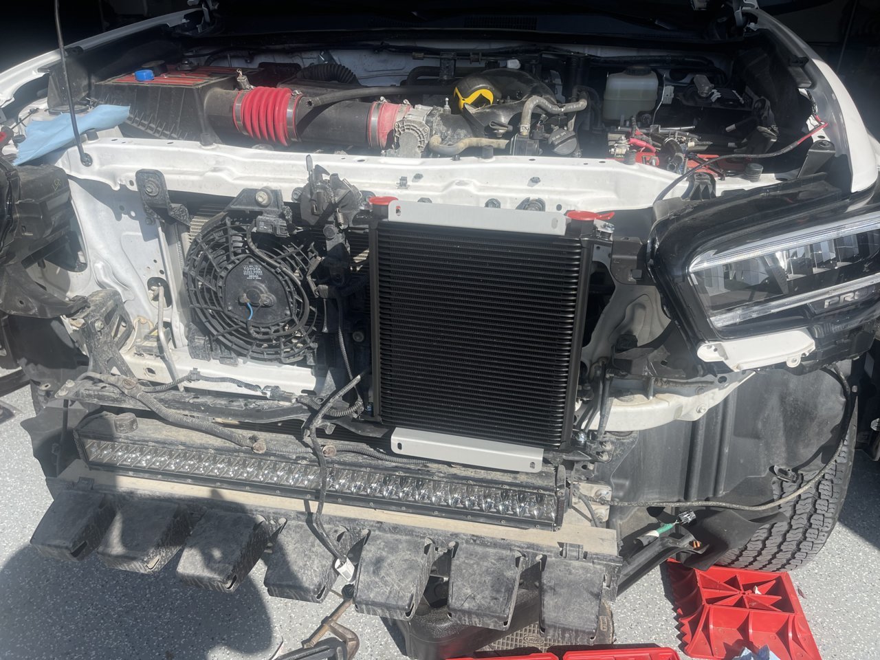

    Finally added my afe 2nd gen rad to the 3rd gen and my derale cooler with spal fan A4FBB53E-C11D-40C9-9F42-366955DA79DC.jpg D19F00EB-8FCD-4A00-82E2-F183CEC95713.jpg 87AD30F3-2004-4EC9-BC10-0C891E71E54B.jpg

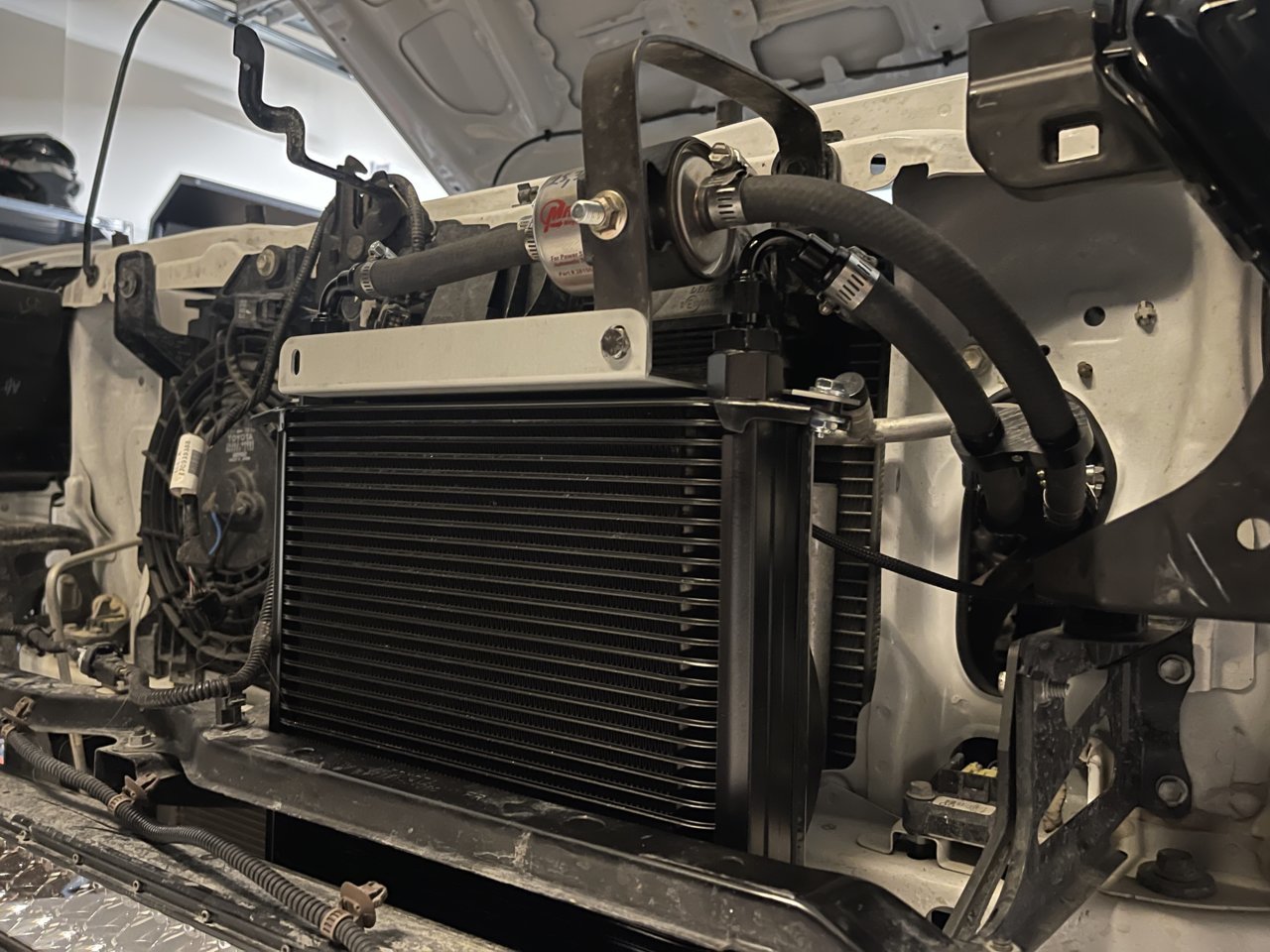

    @Iconic_
    I used a plastic push pin I had laying around on the bottom left... The mount is solid, but it was too close to the hood latch center support for the cooler lines to exit towards the driver side. I had to flip the cooler and run the lines behind it... no biggie and it made for an easy install with room for nice loops in the lines to not restrict flow.

    I ran the upper line by drilling through the bracket and adding a grommet to protect the line, the bottom runs straight behind the bracket cleanly.71A9BFC4-6A25-42B6-AEC6-5AEA4232C69C.jpg 78E025E7-2E1B-4845-AFA0-846692A93D6C.jpg

    @Kane50 that's a super clean install... I like the clamps! I thought about drilling it but once I flipped it over, it's fine for my needs. My routing is a bit different, I used the inlet to the factory cooler over to the new cooler top and bottom back to the old cooler. Essentially backwards from the way you did. I didn't want to mess with that tight radius out of the old cooler... As well as this seems to be working, I may remove the old cooler completely.

    do you have a link for those clamps that you’ve used. I really like those in that location.
    As others of stated very clean, well thought out install.
