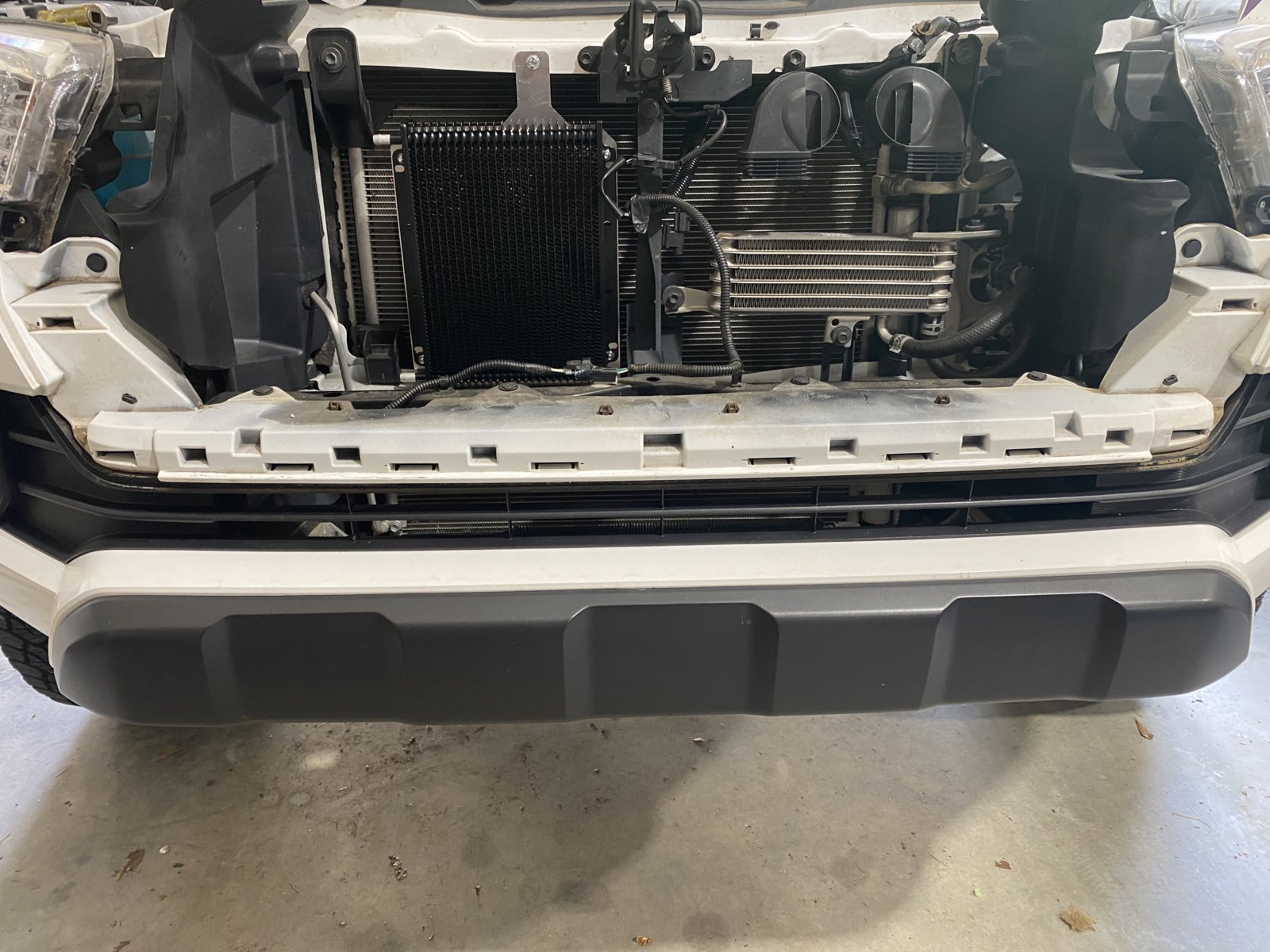

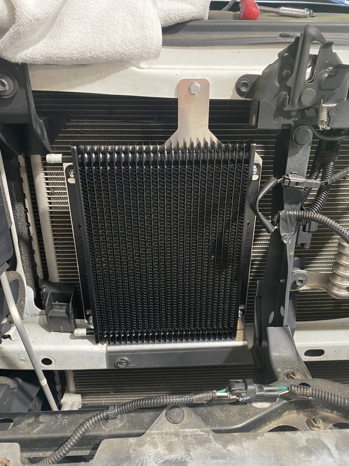

    @b1er and @Kane50 thanks for the install pics! Looks great!

    Hard to tell by photos, but is theres still room to run a fan between the cooler and rad?

    It'd have be a thin one... There's not a bunch of room back there with the cooler... or space the bracket and cooler out some and lose the bottom right bolt and trim the bracket, drill another hole in the core support... it could work.

    Yeah I might have to look at moving it outwards some. I'll be doing towing through mountains, so the ability to run a fan would be ideal.

    Just placed an order for the bracket and Hayden 678 kit for use with the factory cooler. Hopefully this helps with the hot summers in AZ. :bananadead:
    I might try the drill and grommet method here. The install looks clean. :hattip:

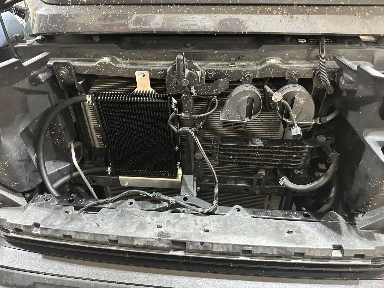

    First off, thank you to all who have posted or shared their experience installing a transmission cooler here on TW. I've learned a ton.
    For those who have later 3rd-gen trucks without the factory aftercooler, how are you routing the lines? I bought the @Iconic_ Hayden 698 kit (thanks, Devon!) and have the cooler mounted with the inlet and outlet pipes facing the passenger side of the truck just like the photos above. I'm trying to keep the factory routing through the radiator in place and am probably overthinking it. After a ton of searching, I've found a lot of pics from owners with the factory cooler, but I haven't stumbled onto any running only the Hayden 698 unit with no factory cooler.
    Any recommendations? I'm still under warranty, so I'm wanting to keep the install as clean as possible (i.e., not take the radiator out of the loop).

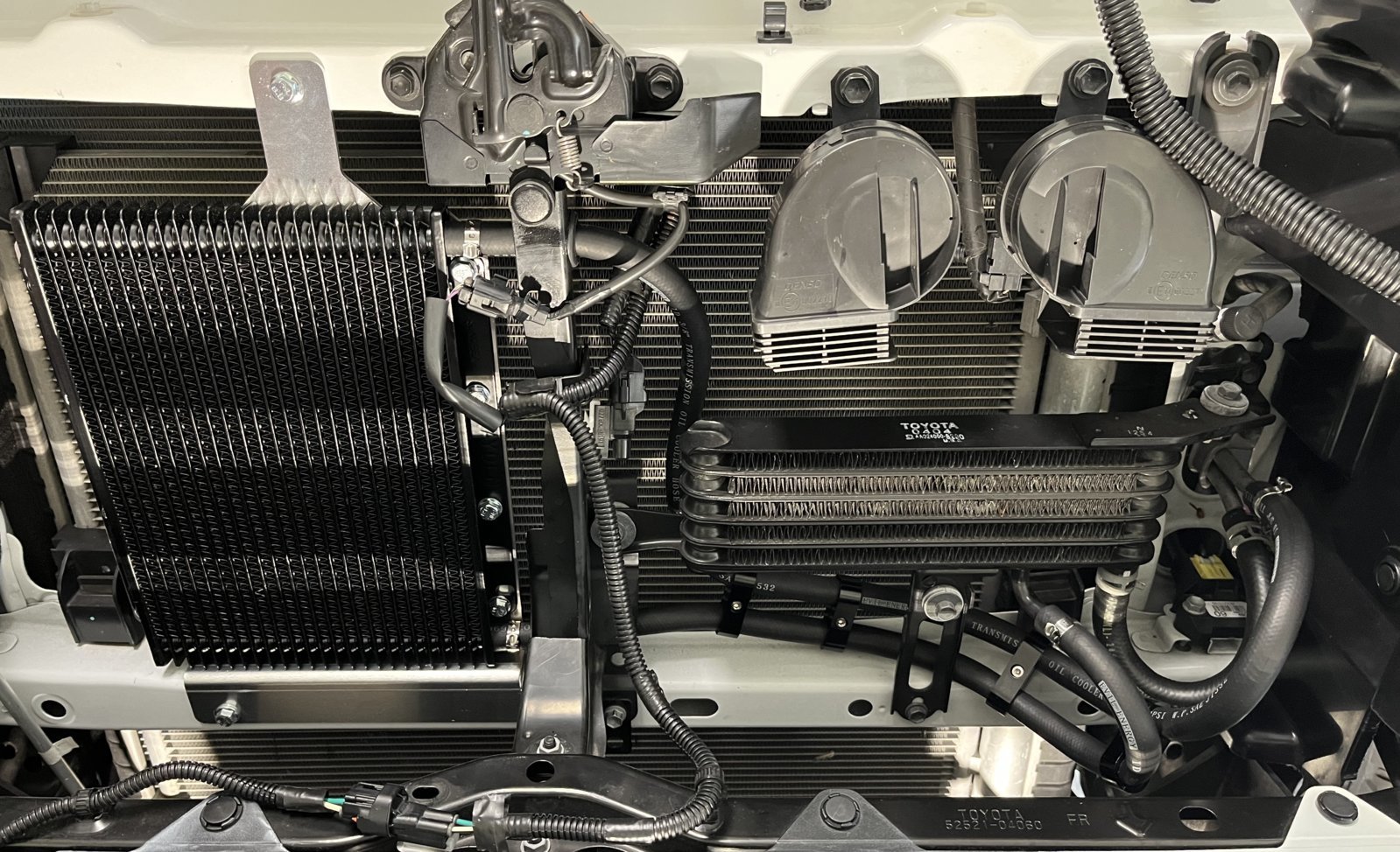

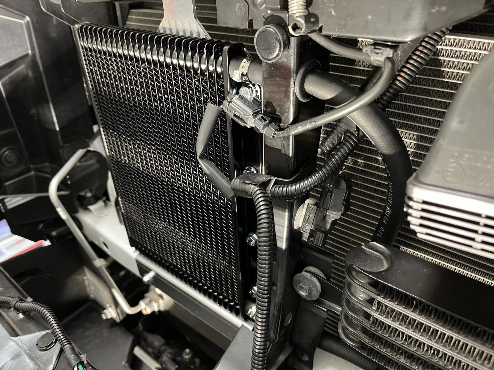

    I got mine installed and it looks great with the bracket. I got the bypass version (698) which I don’t think is needed. It seems like no transmission fluid gets sent to the transmission cooler until the thermostat opens. The cooler lines and the transmission cooler are cool to the touch unless I pin the thermostat open to make the fluid flow or wait till the thermostat opens at 187 degrees. IMG_5385.jpg

    I ended up going non-bypass because I had the same thoughts. Not only does it not flow until the tstat opens, but tow package trucks with an OEM cooler have a warmer at the tstat housing that use coolant to heat the trans fluid. Should be no need for a bypass in the cooler.
