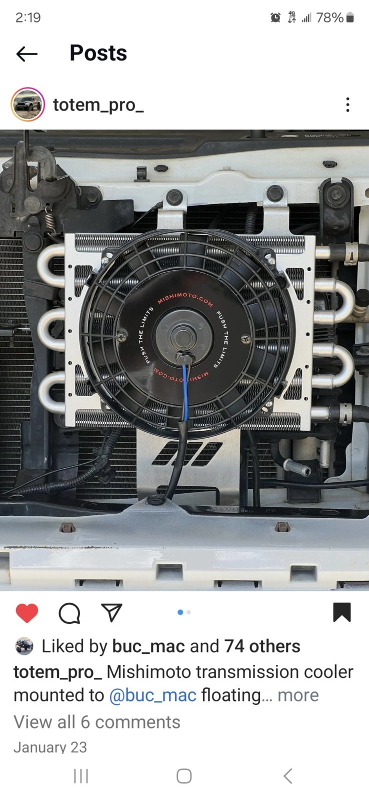

    This mod has been awesome for me. Brings down temps super quick. Total game changer and peace of mind.

    The fan is no doubt a welcome accessory when stuck in stop-and-go slow traffic, especially if towing.

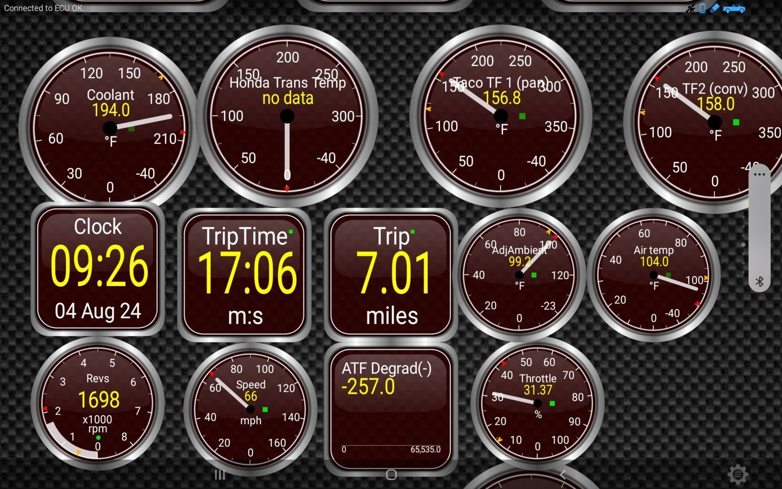

    Fluid routing from Guac at # post 415 seems accurate.
    I have a 2021Tacoma Sport, v6, 6sp, short bed.
    Trans oil connections are on the driver side, in the radiator, and the TOP Trans oil hose was noticeably ALWAYS hotter than the BOTTOM hose at the radiator
    Why would the TOP hose be the return hose if it has the hotter oil returning to the transmission?
    I was concerned about the lack of an additional external oil cooler. In 2023, SE Arizona had 89 days of above 100F temps
    I mounted the Hayden 678, using the Hayden hose, from the radiator/trans oil BOTTOM port to the top connection inlet of the Hayden then spliced with a 3/8" double barbed brass connector, the bottom outlet into the original line (bottom hose) back to the trans.
    -- Radiator bottom port to Hayden top inlet;
    -- Hayden bottom outlet to brass barbed connector to original bottom return line to trans
    I have great results with pinned THERMOSTAT.
    May 5, 2024 -1hr 50 min, 111 miles, Engine coolant 198F, PAN 158F, TC 158F, Outside ambient 86F, Speed 53 mph.
    June this year at Grand Canyon=4 hours driving, 250 miles, Engine coolant 190F, Pan 142F, TC 143F at 66 mph, Ambient outside temp 42F.
    When sitting parked, TC increases 10 F above Pan temp.
    July 12,2024 - 6 miles, 13 minutes driving, Engine coolant 198F, PAN 155F, TC 167F sitting at stop light left turn lane, Outside temp 107 F.
    TC temps will be appx equal to PAN when driving and rise when sitting.
    Seems a pinned thermostat, with an external cooler works well in the desert environs.
    Have many other trips with similar results.
    Its about 100F outside. Engine at operating temp. Freeway driving. Look at TF1 Pan and TF 2 Conv temps. Waiting at a light, TF2 can get 10F hotter.
