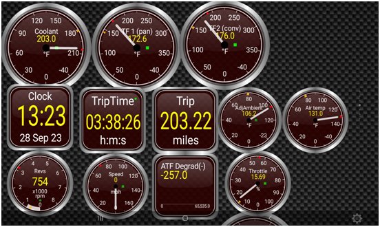

    Trans thermostat pinned or unpinned?
    I assume unpinned, as temps are below 187
    T-Stat PINNED.
    Here's the closest screen shot I could get. 203 miles driven, 3hrs 38min driving, at 106F outside, 203 coolant temp, with 173F in the PAN and 176F TC at about 1:23 PM. Car at freeway rest stop. Coolant seems to range between 185F and 205F on any one trip.

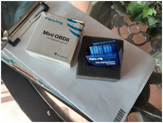

    I use the Torque Pro app with the below scanner with the attached PIDS.
    Tacoma 2021 DCLB v6 automatic trans, pinned external cooler.

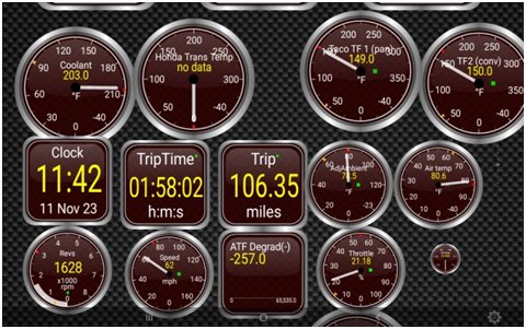

    Some results with pinned external cooler. Notice the TF1 and 2 results and the Ambient Outside Temp, speed and mileage of the trip. Truck was packed for camping say, 600 lbs including me on mainly flat freeway driving.
    bgavin and atc250r[QUOTED] like this.
