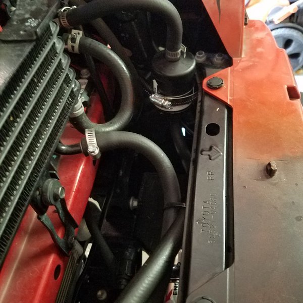

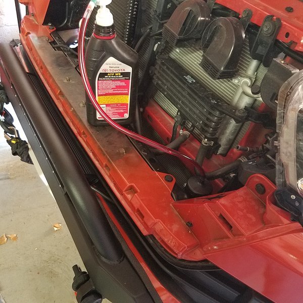

    Thanks to @GPsevinSixx for the magnetic filter idea.
    I ordered and mounted a wix filter this week. It was a really easy, inexpensive and most likely very useful install. I used a couple of hose clamps and affixed it to the drivers side grill support. I chose this spot for 2 reasons.
    1. I didn't have to cut the return hose so if I develope a leak in the filter on a road trip I can easily bypass the filter with the return line.
    2. Dripping ATF on the synthetic winch line will be avoided.
    Hose clamps aren't exactly the cleanest install but they work very well, make swapping filters a breeze and are %100 unnoticeable when the grill is on. 20170612_105323.jpg20170612_105805.jpg
    I was feeling a little OCD about the ounce of fluid the filter would take up yet I was too lazy to do the full fluid check procedure. I just added several pumps into the cooler lines to make up it:thumbsup:
