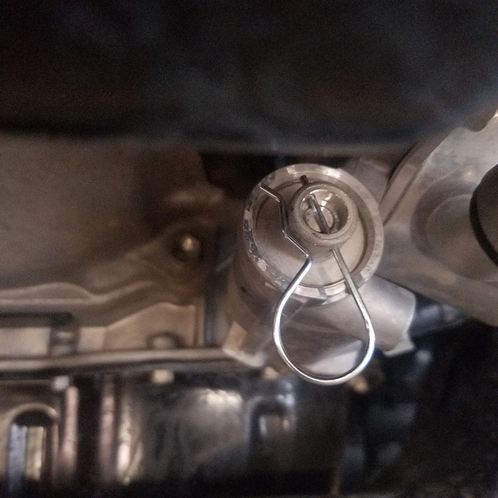

    I forget the exact size but I use a small hitch pin I picked up from a local Ace hardware store. Bring the drill bit with you and see what's about the same size.

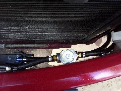

    Seriously this is important for the V6 discussion as well, if you have your transmission lines run through the radiator I don't see why a tstat is even necessary. Running through the radiator should heat the transmission fluid to operating temps (over 150) as long as your motor is up to temp.
    I don't even see a tstat on my 4 banger:
    Cooler lines come out...
    Mosey their way on forwards in a manner similar to a power steering cooler (I wonder if you could put fins on these for extra cooling??)...
    And then bam, right into the cold side radiator tank.

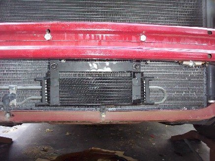

    On my 2004 odyssey i installed 13 row earls cooler which despite its small size is rated at 24,000 GVW. when i ran it as it the ATF after a long drive in 90F+ stop and go traffic was only luke warm to the touch so i knew in the fall, winter and spring the ATF would never get up to proper operating temperature. so i ran a thermostat that bypassed that cooler if temps where less than 180F..
    Worked like a charm after that and despite the issues with 3rd gear clutch burnout on the odyssey 5 speed it still going strong. And also have magnefine filter in their as well.
    Had my one minute of fame when i wrote to Road and Tracking asking about ATf temperature and my decision to use the termostat and they actually published my email in their technical questions sections :yes:
    gearcruncher likes this.
