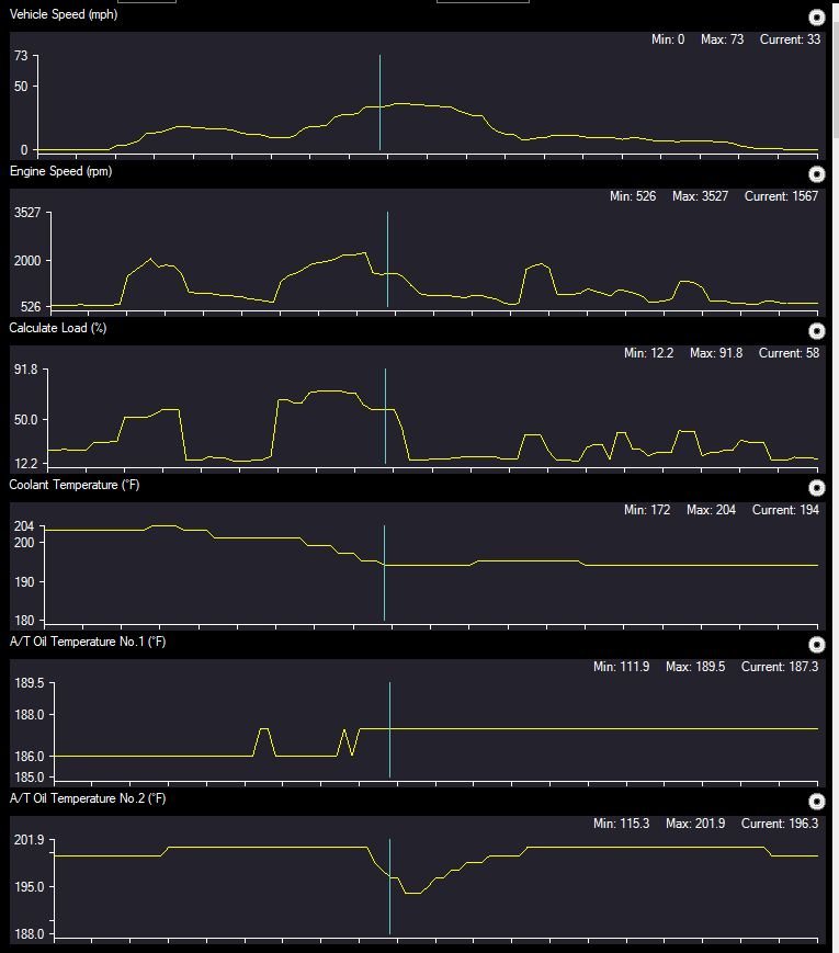

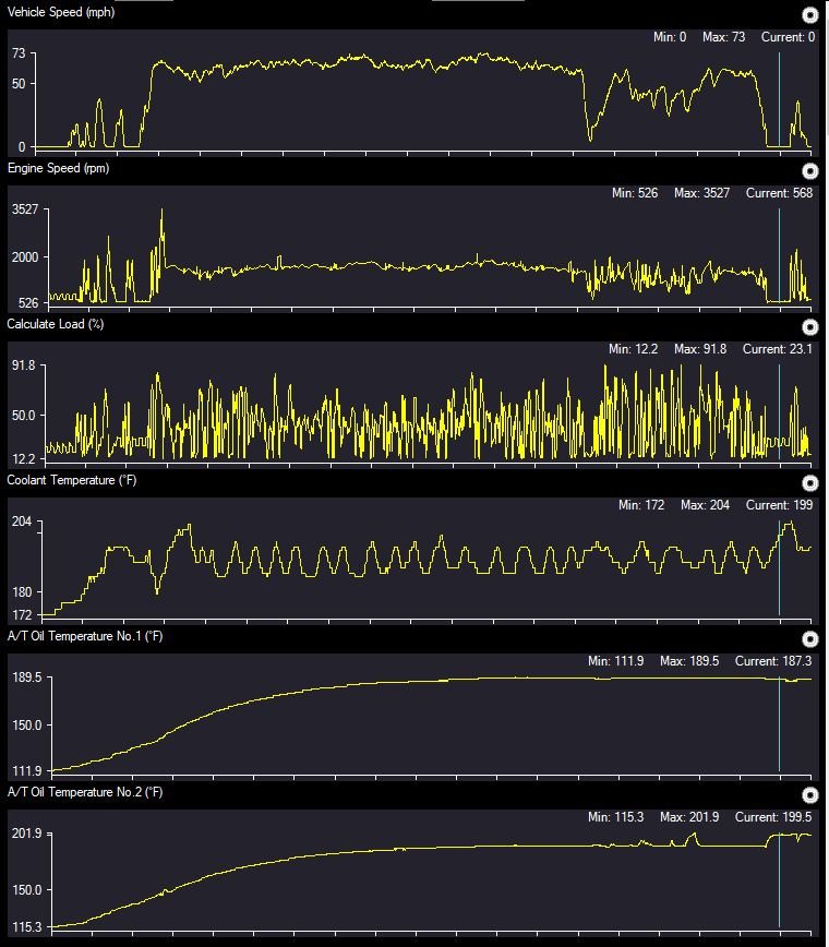

    I don't know if anyone is interested in these captures. This is from a 30 mile drive mostly on the freeway with no hills. I have a trailer towing package. Everything is as it came from the factory. I have picked certain PID's out. There are a lot of others if anyone is interested.
    Zooming in on when there is an increase in No 2 Temperature (blue cursor). This is coming off of the freeway at a stop. Is increase in engine temperature the reason for the temperature increase in Temperature 2 or are there other variables?

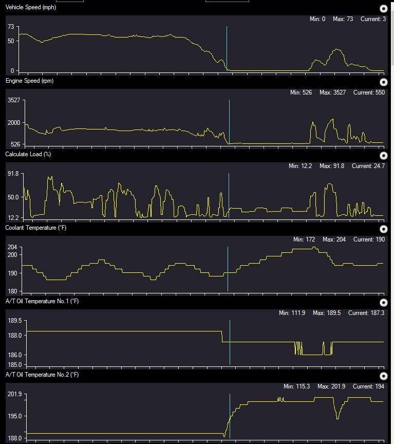

    Zoomed in when Transmission Temperature went down.

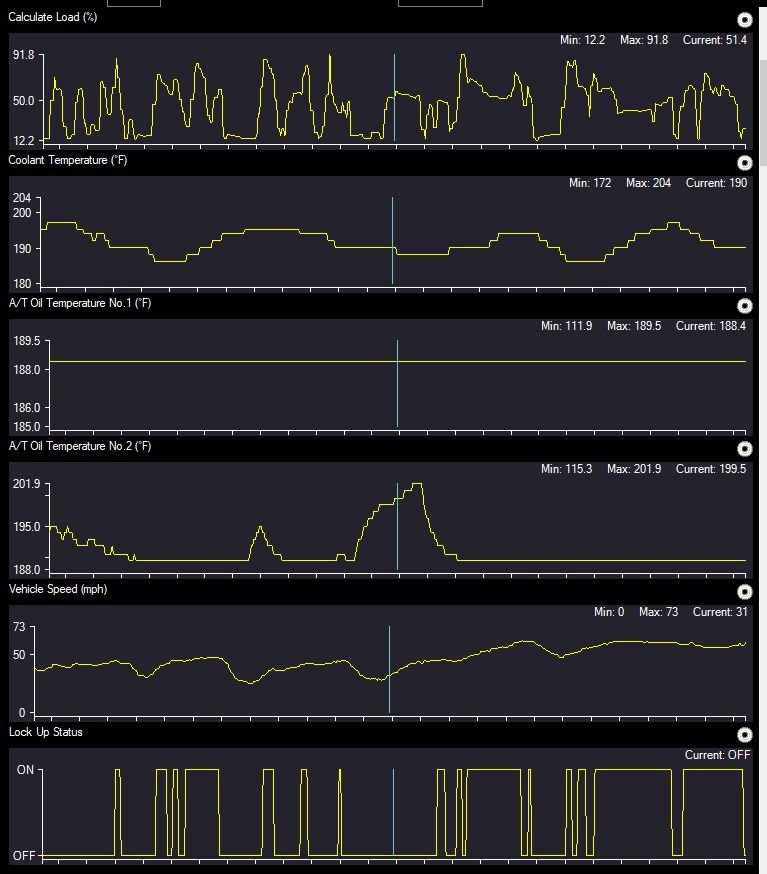

    Temperature increase from Lock Up OFF?

    Personally, I think the rise when you come off the freeway is due to the downshifting. I see the same when I get off the interstate.
    This is really cool data!
    I pinned my transmission cooler open last night and I saw a spike when I pulled into work at 163°F compared to 192°F yesterday, so I'm liking the cooler temperatures. I did not notice any difference in the shifting patterns, but then again, I'm mostly on the interstate for the majority of my commute. I wasn't looking too much at the SGII while driving, but the few times I glanced down, it was in the mid 150s.
    The transmission fluid temperatures did not heat up as fast as before and I also noticed that my water temps were a few degrees cooler. Not sure if that was due to the trans oil cooler pulling some heat off or not, but was an interesting note.

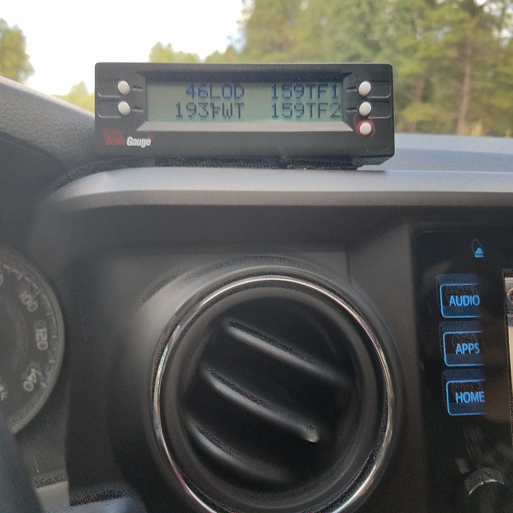

    We've had a few towing trips now with the cooler setup and have noticed some consistencies.
    When on the flats and cooler weather (ambient temp 85° and below) my temp never drops too much lower than 160°F. As seen in the pic Tf1 and Tf2 had the same exact readings for some time in the conditions described above. This info tells me the the torque converter is locked up here at 159°F.
    Now, does the trans not fall far under 160° because the torque converter is being prevented from locking up by the ecm or because the of the viscosity bypass on the Hayden cooler:confused:
