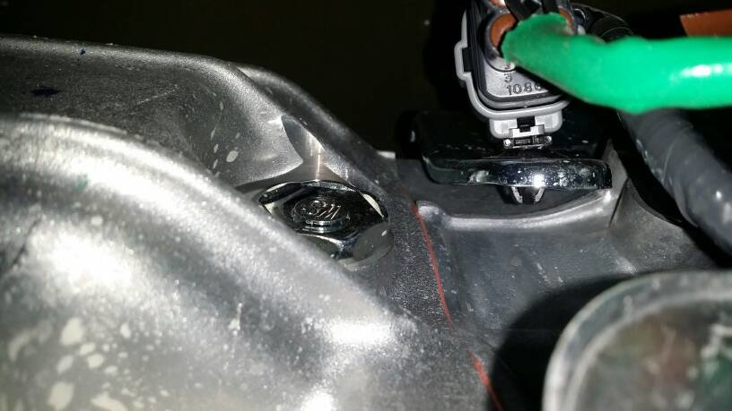

    Is this the fill hole? The rear facing bolt. I'm having a hard time finding it from the diagram in the service manual.

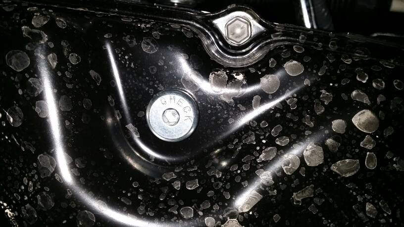

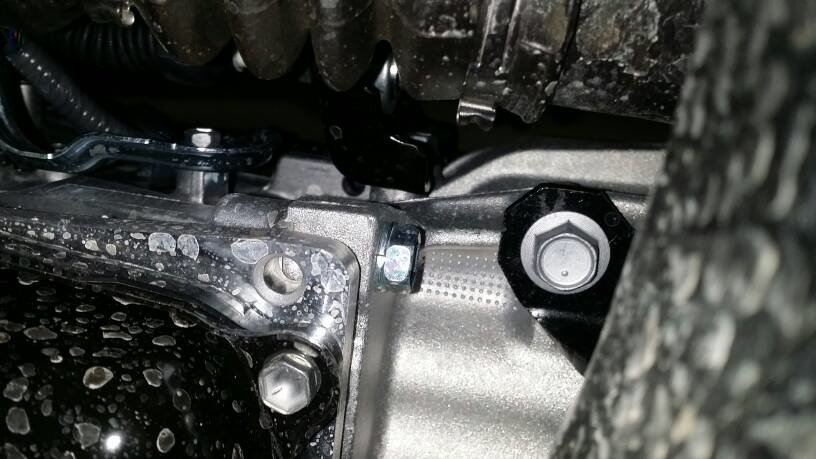

    That's the fluid check hole (5mm hex head removed). Assuming a 4WD, the fill plug is on the passenger side of the transmission and is stamped with "WD" on the outside of the plug.

    Thanks. I see the fill on the passenger side now. Here are pics of the fill hole and the check plug.5da4610b1379b50cbb38bab5ee34815d_d9b5f4cb7647310207270bd73eabc09e040f37d3.jpg061a4770ddad6e13850f8ca320a28875_b1881b77682cf644cd0ef8be87504f057ea3b028.jpg

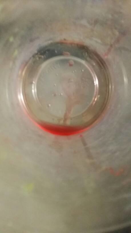

    I tested mine tonight. At first when using the jumper and the N-D sequence 6 times the D indicator was off while the truck warmed up. I was using an infrared thermometer on the pan as well. About when the pan got to 95 the D came on solid. By the time it was blinking (at least 5 minutes) the pan read 106. At first when the D was solid I removed the check plug and got about 2 drops. Later as it got to around 100 on the pan I got another couple of drops. So mine is not extremely low but it is not steadily flowing like the training videos show. I'll call my sales guy tomorrow and see if he can get me scheduled for them to have a look at it. In the meantime can I drive it since it wasn't bone dry at the plug.

    Here is what I caught from opening it 3 times. All while the D was solid.

    From the manual;
    NOTICE:
    If only a small amount of automatic transmission fluid (approximately 5 cc) comes out of the overflow hole,
    then only automatic transmission fluid remaining in the overflow tube of overflow hole has come out. This
    is not considered to be overflow.
