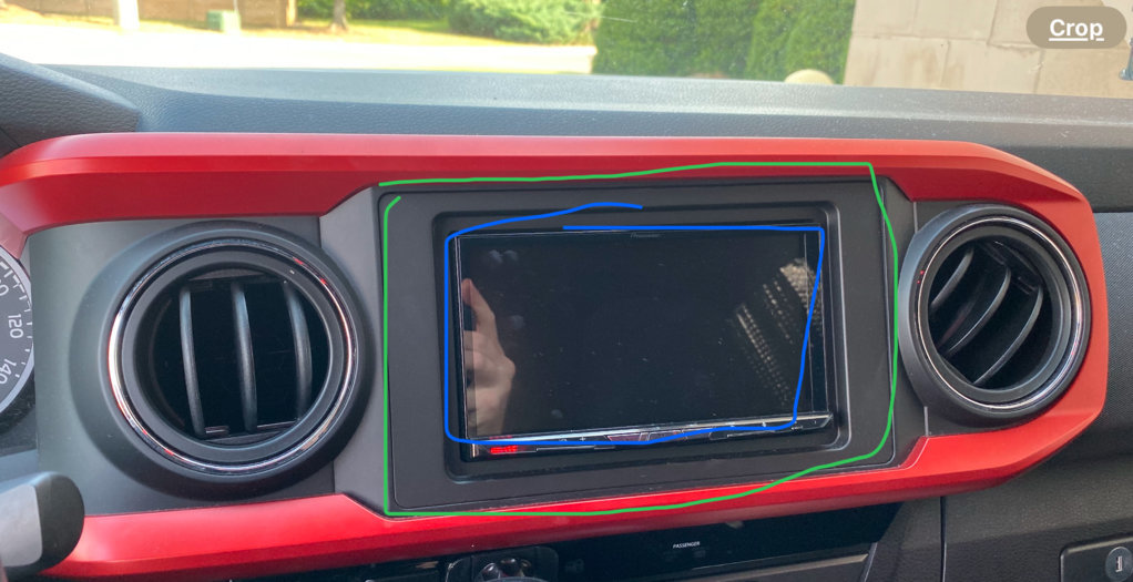

    I am referring to just a mounting kit. For example, I’m using the metra 99-8251B. It will include mounting brackets and the trim piece

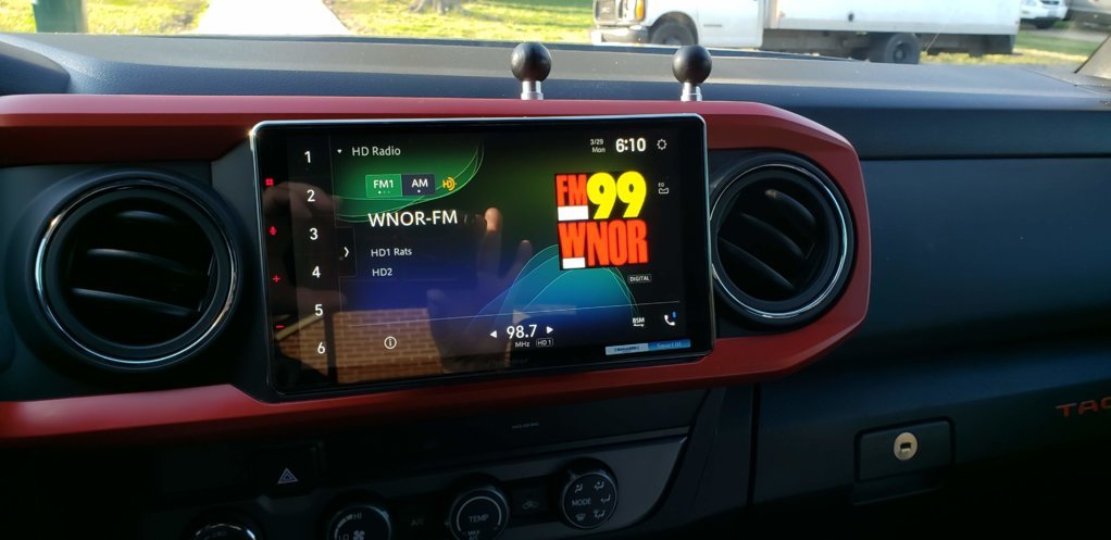

    the answer is 'yes'. the oem radio's screen is larger than the 2-din opening the 'guts' fit into behind it.
    that's best understood looking at used radio listings like this one on ebay.
    https://www.ebay.com/itm/235776080957
    you will need an aftermarket radio installation kit for the brackets to adapt the aftermarket guts to the factory radio opening no matter what. that said, i don't believe anyone else here has ran a radio similar to that, so aren't going to be able to speak to it's size and how it covers the factory radio opening. iirc, the wrx has a more typical 2-din opening, where if you check the pictures of the example factory unit in that above ebay listing, the oem screen has an unequal-side-rectangle with a nearly 3-din-tall, and 1.75-din-wide opening.
    so you may need still need to use the dash bezel kit for the radio to account for covering up the rest of the area, despite getting the larger screen that covers the majority of it, but won't cover all of it because of the oddball dimensioning they did.
    just be sure to check the different players in dash adapters. there's at least 4 variations, and they all place use the 2-din opening differently within the space, as well as each has a different intentional finish texture that can add or subtract from your desired final install.
