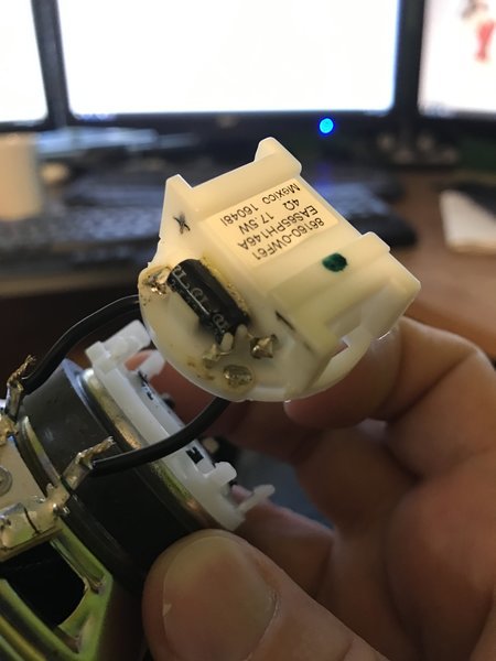

    I have looked for an answer but cannot find. I am trying to install a new tweeter in the dash. I want to keep the dash speaker running parallel with the door. As you can see in the picture they have changed the connector for the tweeter on the 3rd gen. It would be difficult to remove the inline crossover/ capacitor. Would it hurt anything to leave the capacitor even though the new tweeter already has an inline capacitor?

    It will increase the value of the cap if parallel. This will lower the crossover frequency.

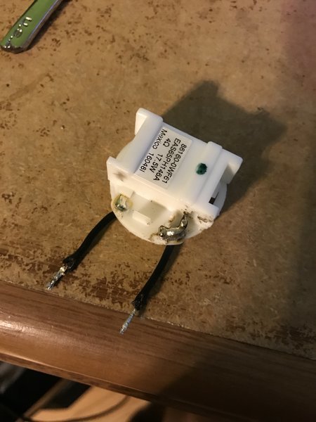

    Thanks for the info. Well it’s not pretty but it has been removed and it should work. I could not find this 4-pin connector anywhere. It would have been easier to just make a new male connectorIMG_2206.jpg
