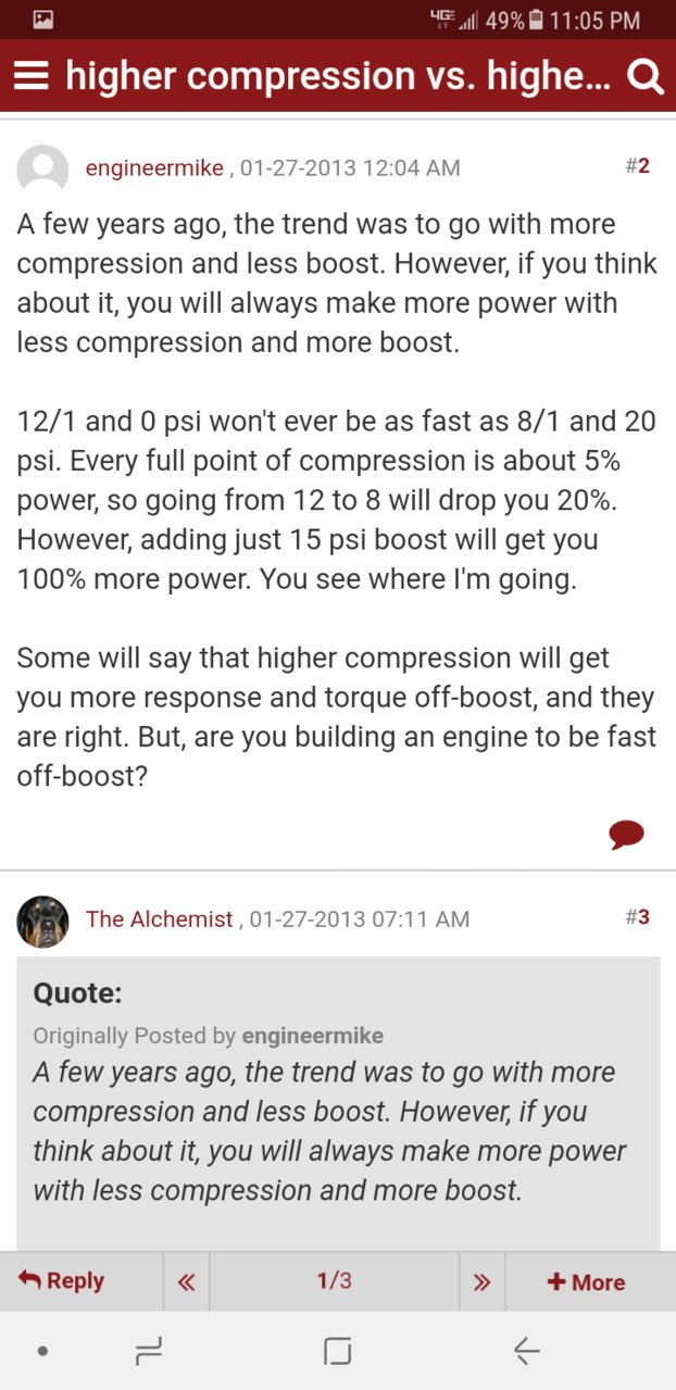

    The 3.5 is Dual VVT and can simulate different compression ratios by hanging valves open during compression. Also, the main problem with high boost on higher compression engines is pre-ignition Knock. This is mitigated in modern high compression boosted cars with direct injection, which the our 3.5l has. The 2015+ WRX has high compression 2.0l, and a turbo boosting at around 18-19 psi with direct injection. The internals on the 3.5l are forged. This engine was made for a boosted application. We got the NA for a reliable version for the truck.

    This is all very good information with promising outcomes. The integrated headers may be slightly problematic but they can be cut and a v band could be welded for the rest of the hot side to be modified

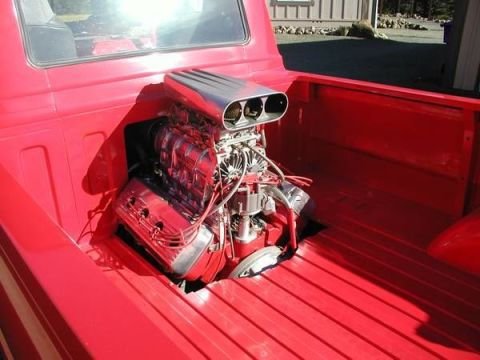

    Welcome to TW OP. As others have said, there is no turbo kit available yet for the 3rd gen. Not sure how unique you are looking to get, but you could try mounting an engine in the bed ala the little red wagon. It would give the additional benefit of weight over the wheels. Hope this helps.

    bobrown14
    bobrown14 Well-Known Member
    Oct 3, 2015
    #165752
    4,474
    Bob
    Philadelphia
    Gen 3
    bunch of stuff - Bro Pro style
    :rofl::rofl::rofl::smack:
    Lexus LS is a thing. So it's already been done bro.
