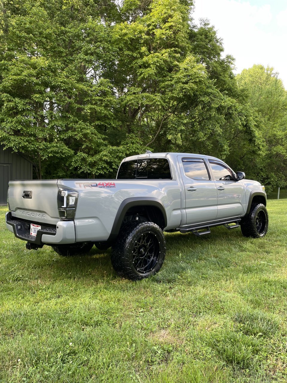

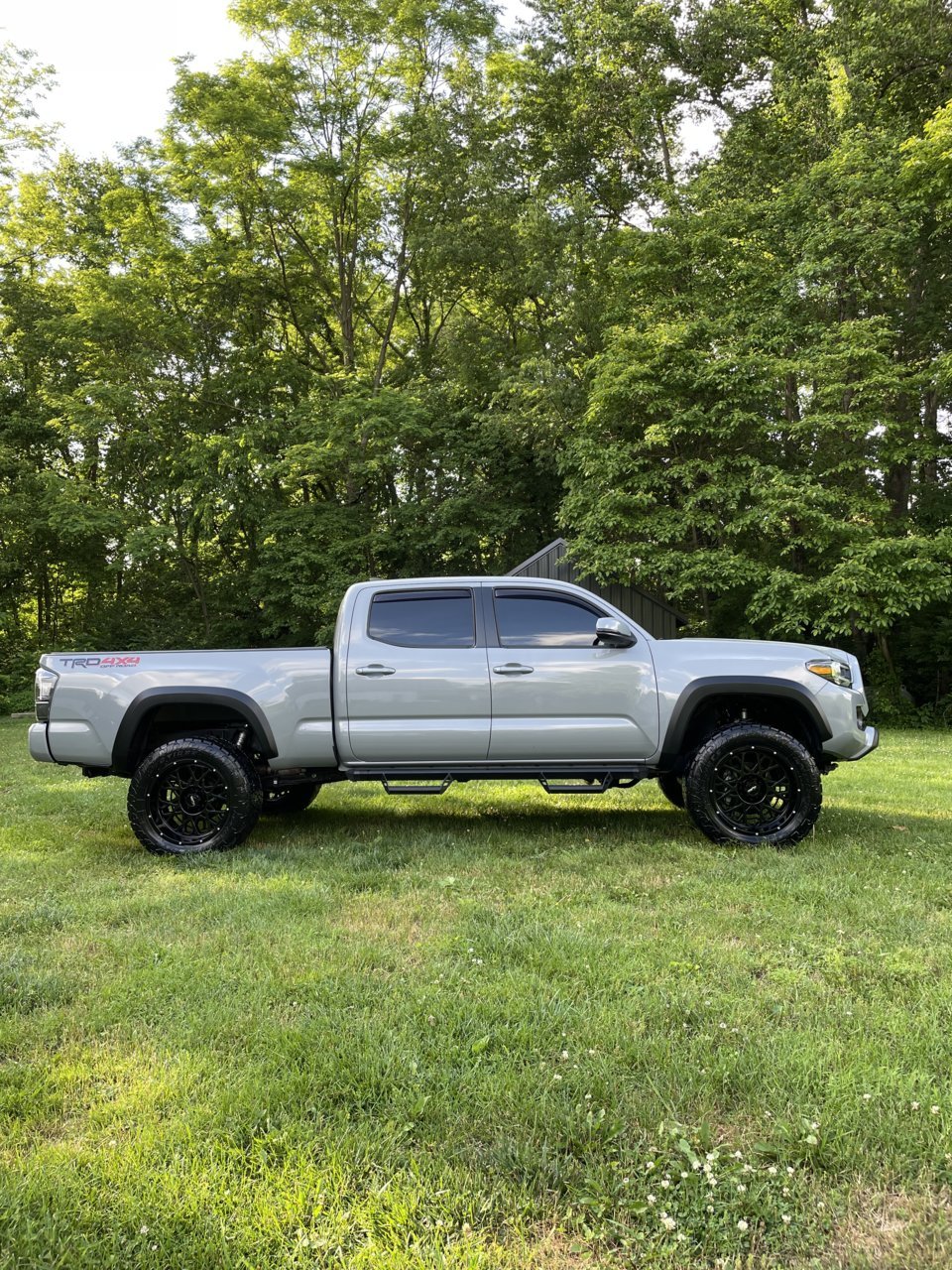

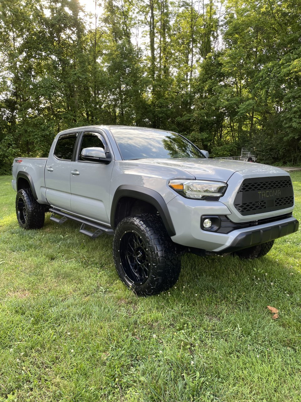

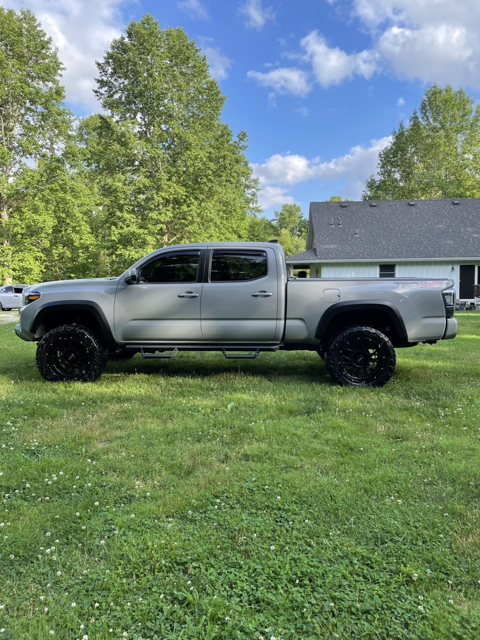

    20C16235-E6BF-43FE-9F12-A90E8FD0BE0A.jpg 0196F2CF-AF4E-486C-B498-DFA90E7EFC45.jpg E0716129-F371-4550-903F-A0463D82A278.jpg 5BC3D2DF-043C-48A8-BB2A-6AB23686B63C.jpg
    3 inch lift, 20x10’s -25mm offset and 33x12.50R20

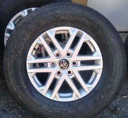

    Follow up - I didn't end up getting the Tundra 20" wheels & tires for my 2022 stock Tacoma SR (too risky) but I was able to get a set of brand new 2022 Tundra 18" alloy wheels with 265/70R18 Bridgestone Duelers at a great price (see attached). I'm guessing I should be fine to run these on the 2022 Tacoma SR but let me know if anyone has history (they're not that far off from the 265/60R18s which come standard on the 2022 Tacoma Limited). Also, I believe I need to get new lugs & TPMS sensors, please let me know if anyone has any recommendations for these as well. I know I can take the sensors from my existing stock wheels but I prefer to leave those as-is for resale or re-use. Thanks in advance for the advice.

    The new Tundra 6 lug factory wheels will NOT work for Tacoma
    the hub size on those new Tundra wheels is 95mm, too small for Tacoma

    Can you still return these for a full refund? They aren't going to fit Tacoma 106mm bore

    Malatx, thanks for the heads up. I never thought about the hub size & assumed they were identical. It looks like the 2022 Tundra moved from the old 5 lug 5x150mm/ 110mm hub size to the 6 lug 6x139.7mm/ 95mm hub size. I'm guessing the 3rd gen Tacoma has been 6 lug 6x139.7mm/ 106mm hub size from the get go.
    I bought these on Marketplace so a refund is a no go. I got such a good deal that I'll just list them & hopefully make a few $$$s. I'm back to square one with the Tacoma wheel search but will stick with only Tacoma replacements.
