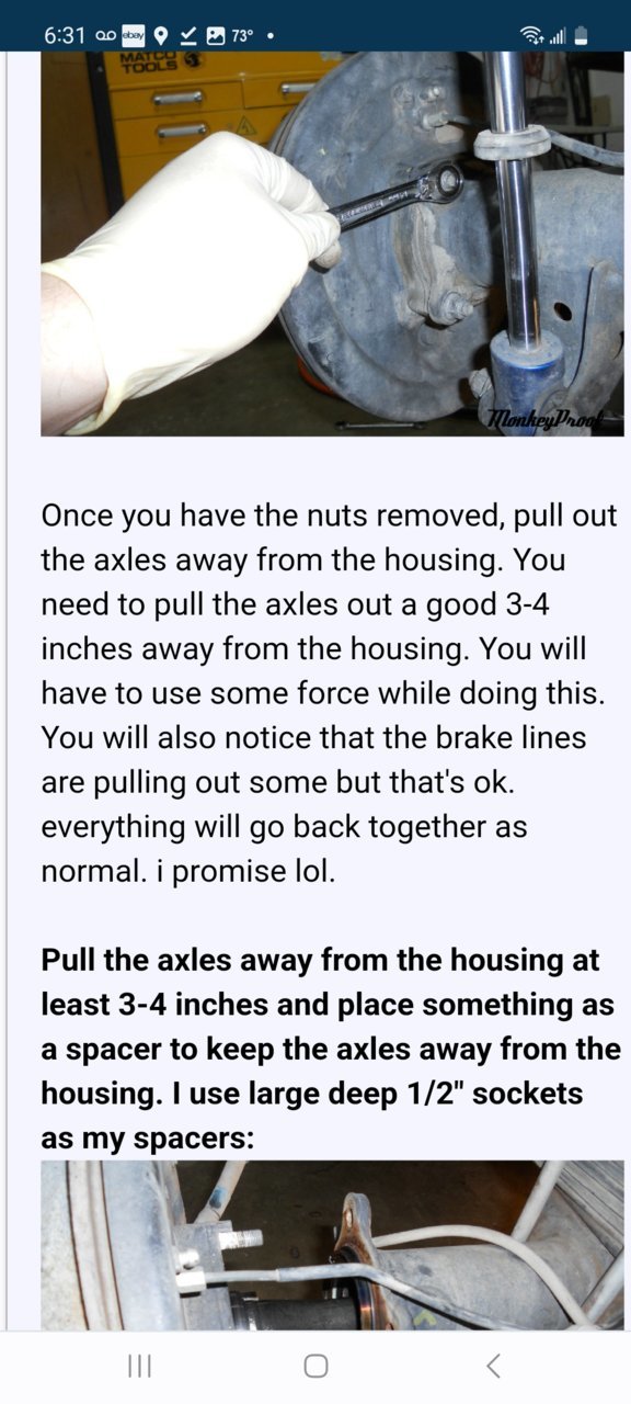

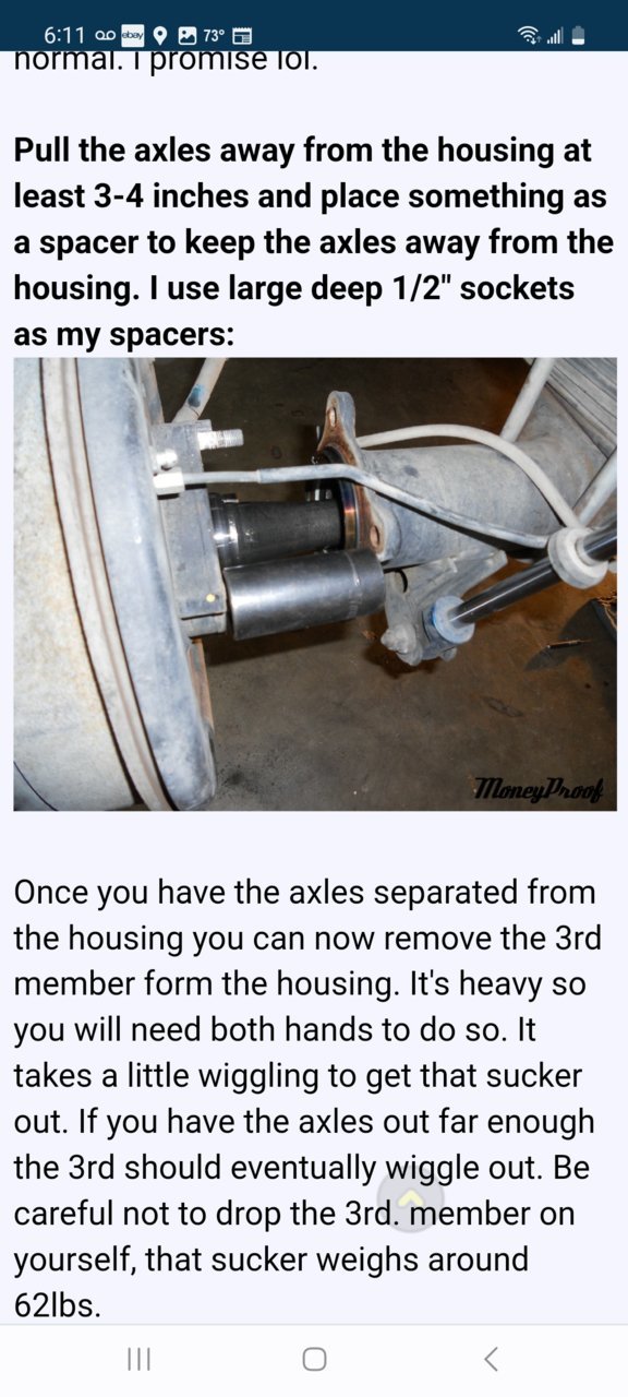

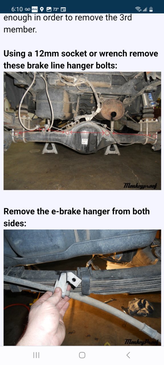

    For those that have done this, were you able to leave the brake lines connected and removing the brake line mounting bolts and stretching out the lines enough?
    I see it’s possible on the 2nd gen Tacoma so wondering if it’s possible on the 1st gens.
    I hate dealing with happening to bleed the brakes

    This guy shows you how BUT it's for a 2nd gen, that why I was wondering if it's possibly on 1st gen.
    https://www.tacomaworld.com/threads...d-installation-of-e-locker-3rd-member.193828/
