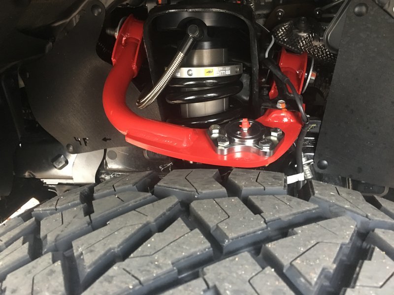

    Truck looks mean man!! Super sick! What UCA's are those! And 285's?

    They are the JBA HD UCAs. Yup, 285/70R17 Ridge Grapplers
