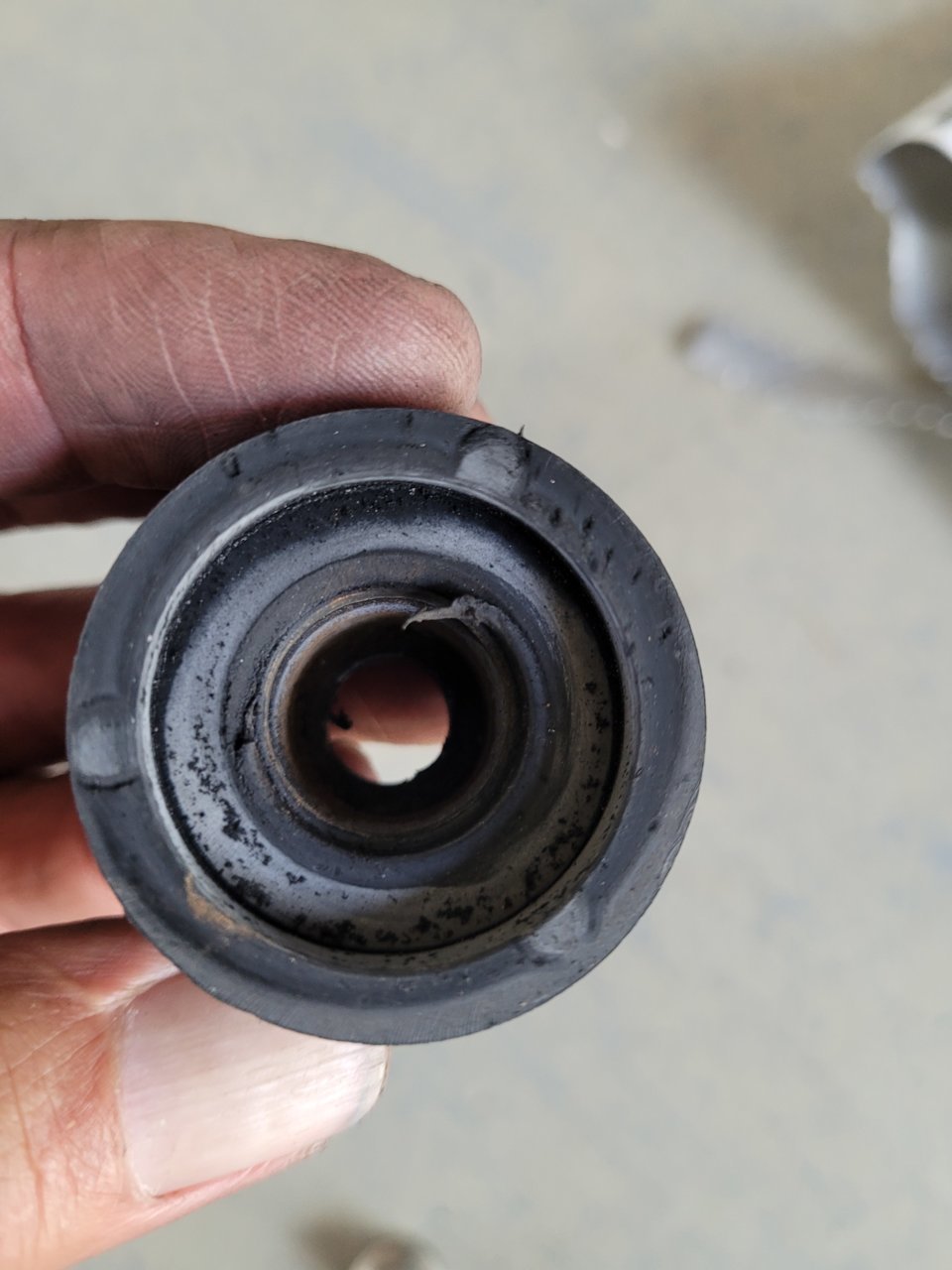

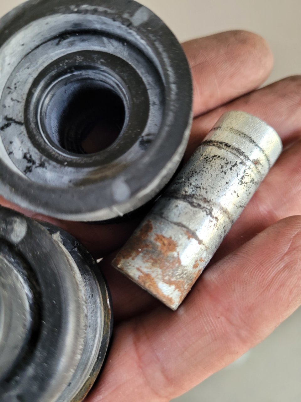

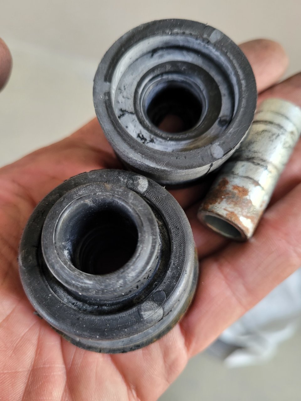

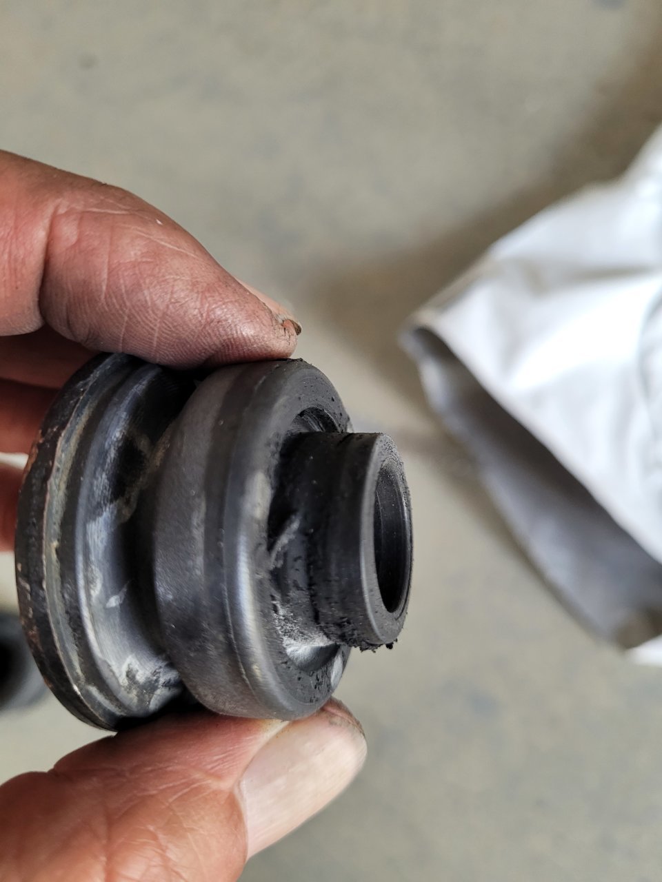

    I just removed the OEM bushings from the front of the my truck. They are approximately 1 year old with approximately 10,000 miles on them. Overall, they don't look bad.
    I replaced the OEM bushings with a set of Energy Suspension bushings (from kit 8.4109) that are noted/ described in one of my earlier posts. After driving over every speed hump in my neighborhood, twice, I can report that the metal-on-metal noise is gone from the front end. A few of the speed humps I hit harder than usual just to further test the Energy Suspension bushings.
    Over the next day or so, I will attach the Go-Pro to the power steering cooler and make a second video showing how much the body moves around on the frame mount with the Energy Suspension bushings. The OEM bushings video created earlier and Energy Suspension bushings video with be joined together for a side-by-side comparison.
    In short, the Energy Suspension bushings have totally eliminated the metal-on-metal sound while traveling over speed humps.
