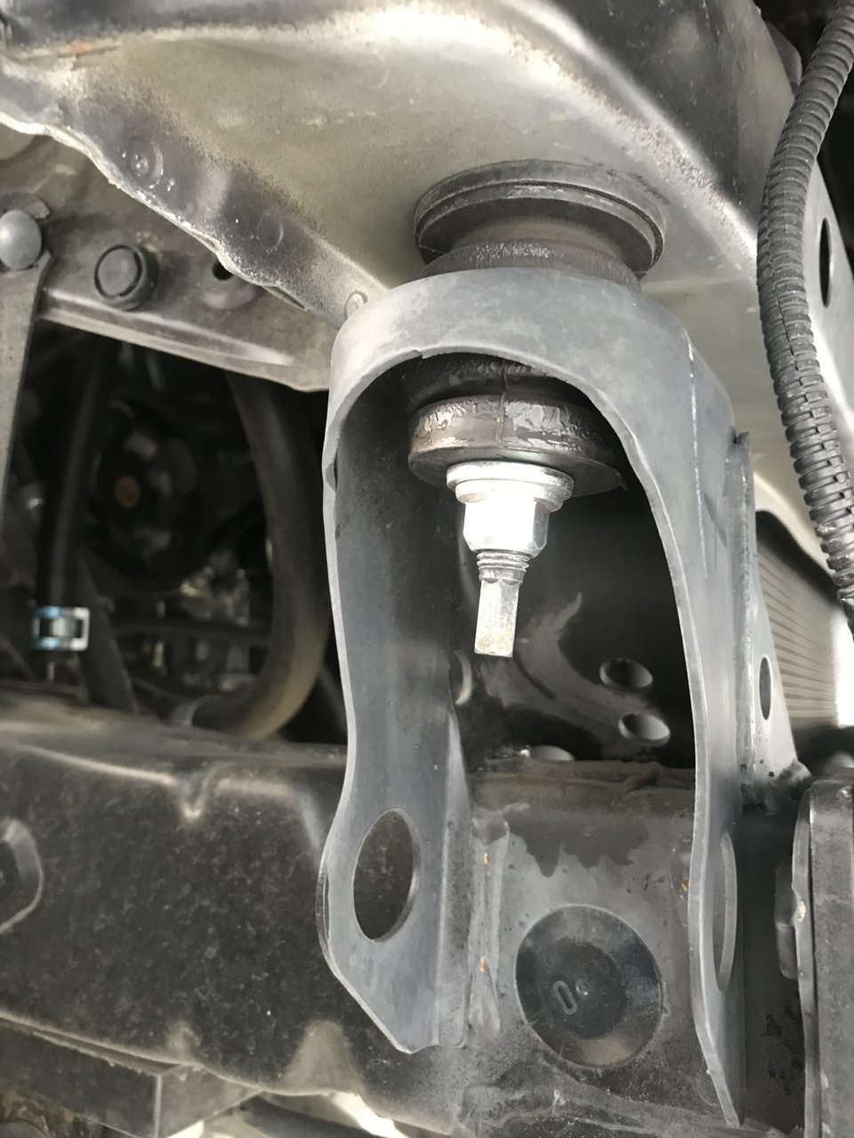

  11. Mar 4, 2023 at 4:46 PM
    #71
    Vol4
    Vol4 Well-Known Member
    Oct 27, 2020
    #345110
    69
    Passenger side looks like it’s starting to collapse. 15,000 on my truck . No noise yet, I’m wondering if I should change them since my bumper is off right now

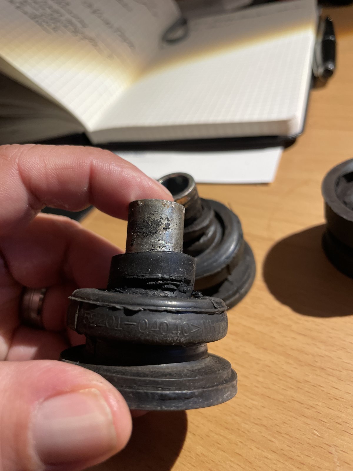

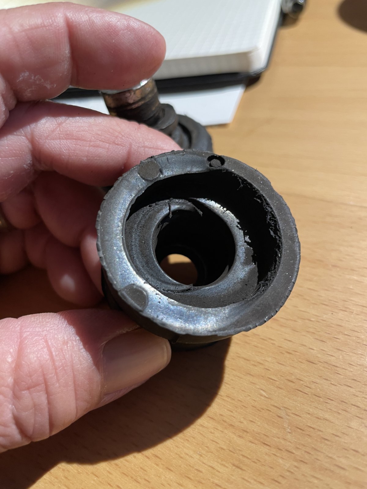

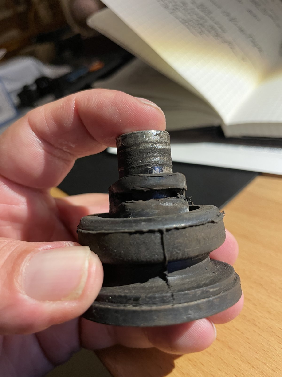

  14. Mar 17, 2024 at 4:38 AM
    #74
    Hogan1966
    Hogan1966 Well-Known Member
    Mar 5, 2018
    #246378
    215
    Kevin
    Loveland, OH
    2021 DCSB TRD OR - Army Green
    Blackout package - planned: black bed logos, black wheel vinyls, front seat window tint, tires.
    Mods, I posted a similar post in another thread, so if that is an issue, delete as you wish...
    Everyone...thanks for this thread.
    I had been having this squeak for several weeks and, I wasn't able to get the truck into the dealer until last week...5 days from my warranty expiring. I did some research here and found several threads, including this one, so I took it to the dealer to have it diagnosed and fixed.
    The video is from last Tuesday evening....you can hear how bad the squeak is. When I took it in Thursday morning, it couldn't be duplicated. I rocked and rocked and nothing. The dealer kept the truck and couldn't duplicate it either. I gave them the links to the threads here and told them it is a fairly common issue, but they said that since they couldn't duplicate it, they couldn't just tear that apart to check because Toyota wouldn't pay them for warranty work. I kept telling them that this was the issue, but, we all know how much respect they give to the self-diagnosing "Internet Guy".
    I kept pushing because, from the video, we both knew there was an issue...they kept looking. Finally, late Friday I got a text saying they found it...they called them the "Cab" mounts...not the body mounts...is this them just renaming it to save face, or are these different mounts? If different, those with the issue might want to mention these, too.
    Anyway, they left me with the old bushings that prove the issue that so many have identified here. I'm posting pics of the failed bushings, and one photo that clearly proves they were installed off-center. I hope this helps those who run into this issue in the future.
    https://youtube.com/shorts/OassUNEwb0U?si=CJFH4MfT-W2OFPb5
