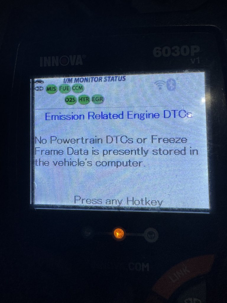

    Well I took a 10K resistor and put it where the EGR sensor used to be plugged into and there it is, No CEL for EGR!
    Now to drive it some more to get the readiness monitors to be all green. EGR is no longer a problem.

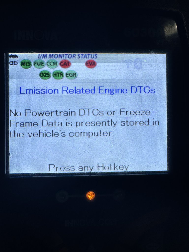

    “EVA” fixed ! On the ready monitors , it turned out it was a loose vacuum hose going to the charcoal canister. Got to love this boards ! I have learned a lot from everyone here. Thank you for your inputs.

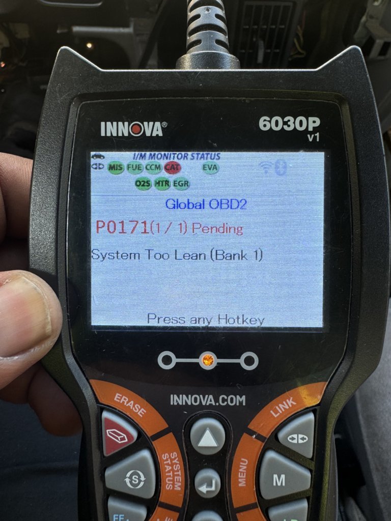

    So it turned out that I have a BIG exhaust leak on my TURBO manifold ! That is why it says “CAT” on the readiness monitors
