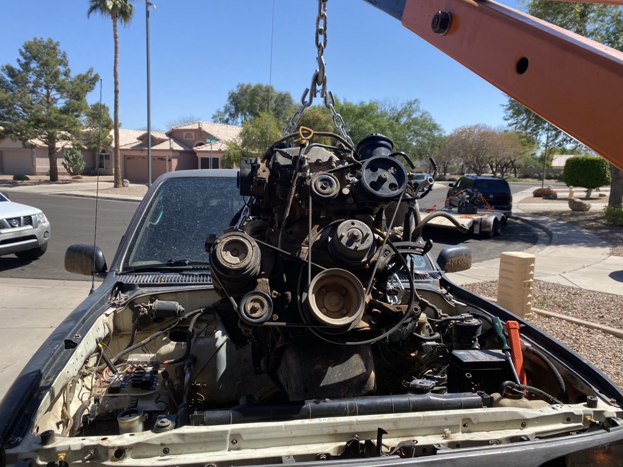

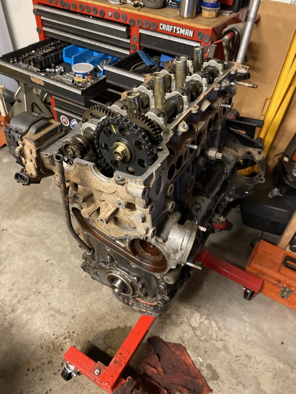

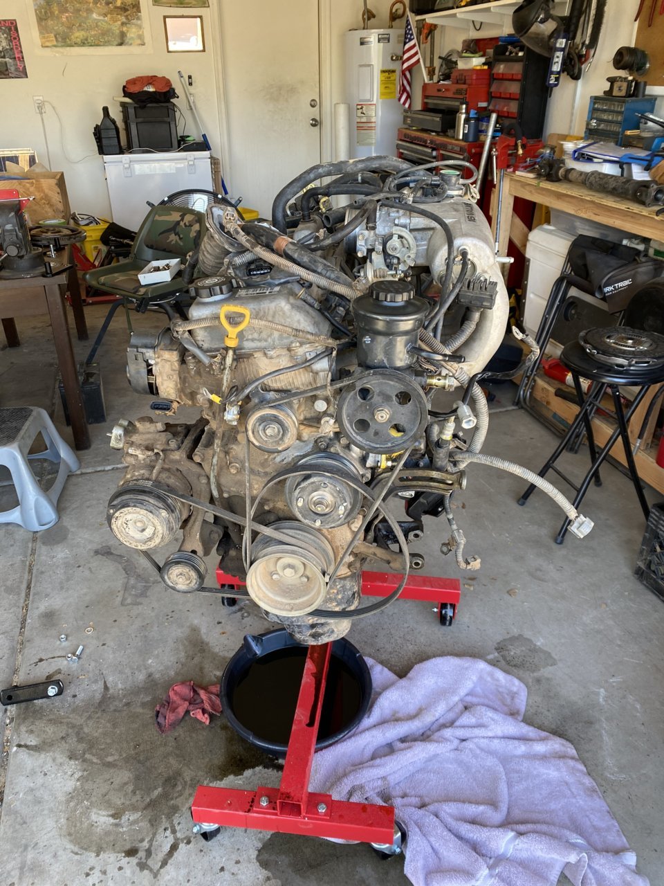

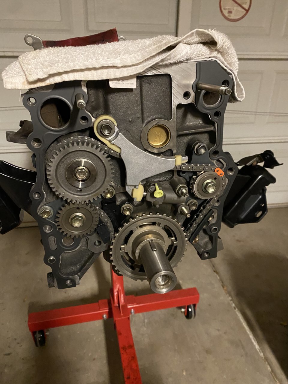

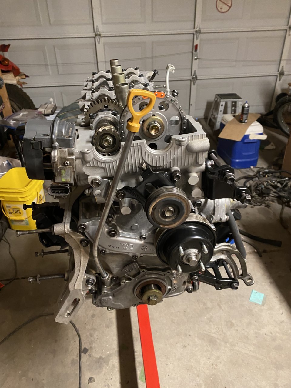

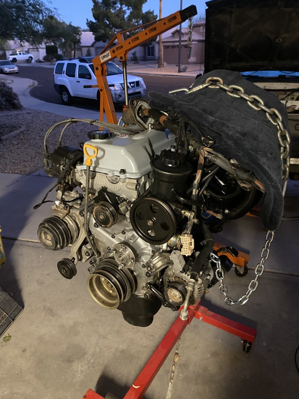

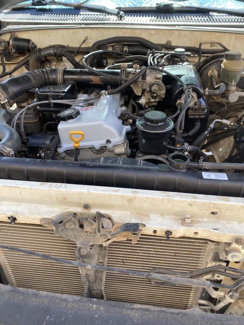

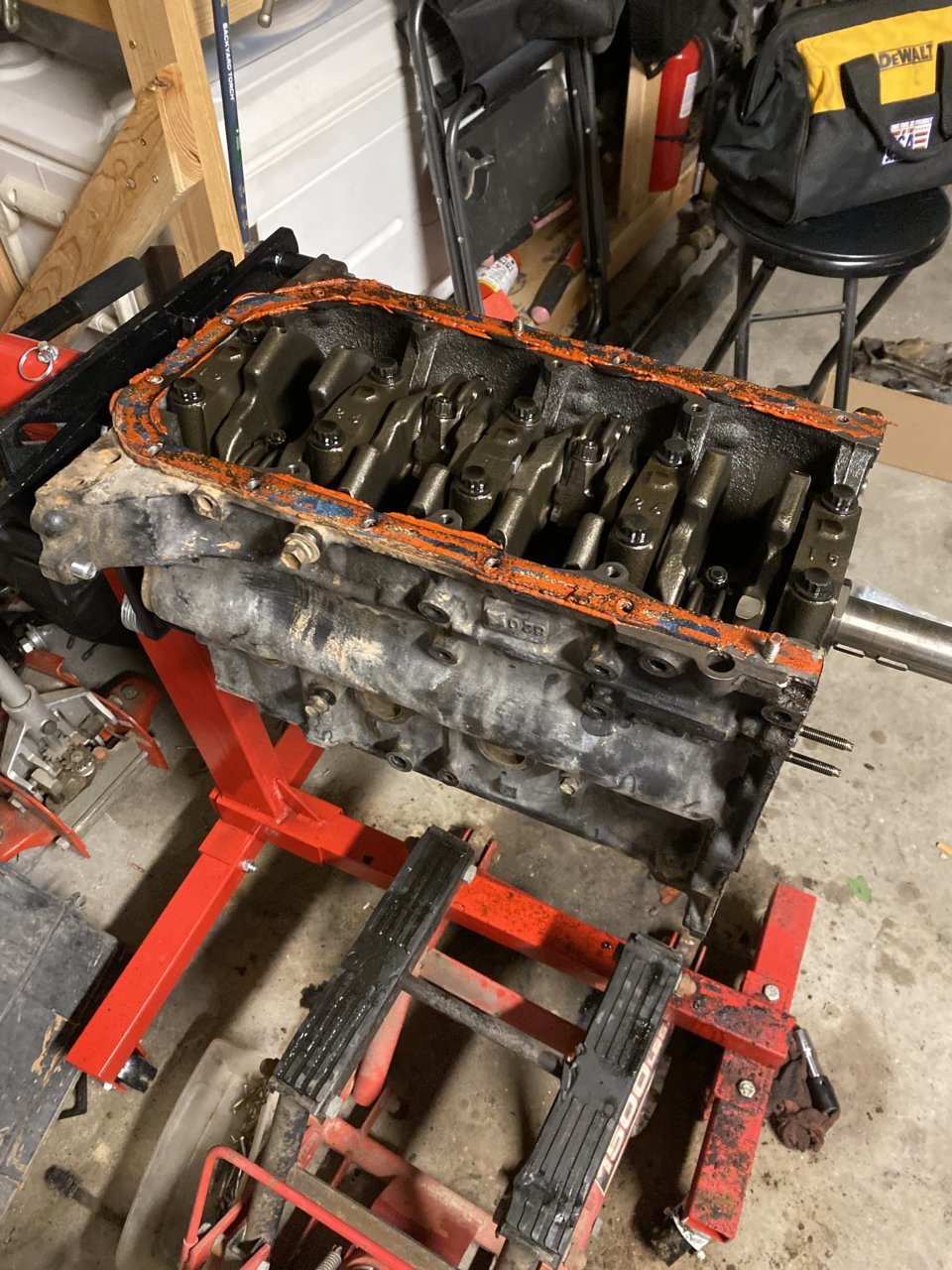

    After a year in the making, I finally finished my 3rz rebuild. I replaced every part and sensors with the OEM equivalent. It was pricey, but well worth it, IMO.

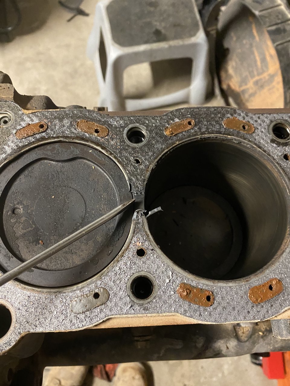

    The head gasket failed here, and instead of doing a head job, I decided to rebuild.

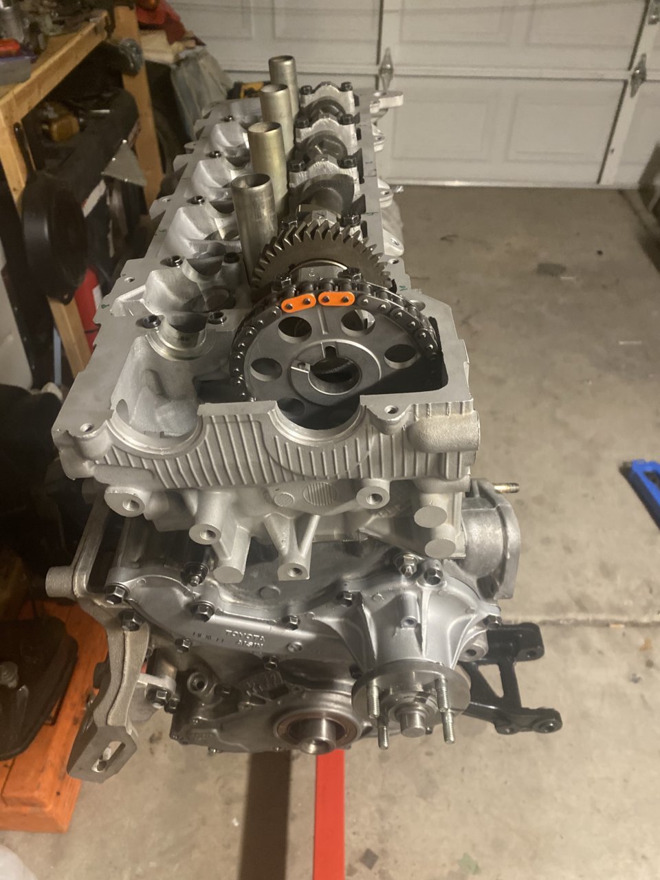

    Cleaned up, with all new parts!
    68D0B3D0-979F-4F9A-B6D9-41F06E2855CE.jpg 54E32B82-F64A-4030-A72B-5DBECA17811D.jpg

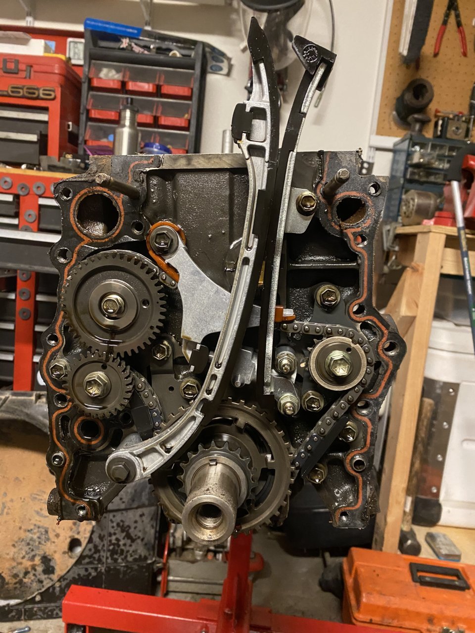

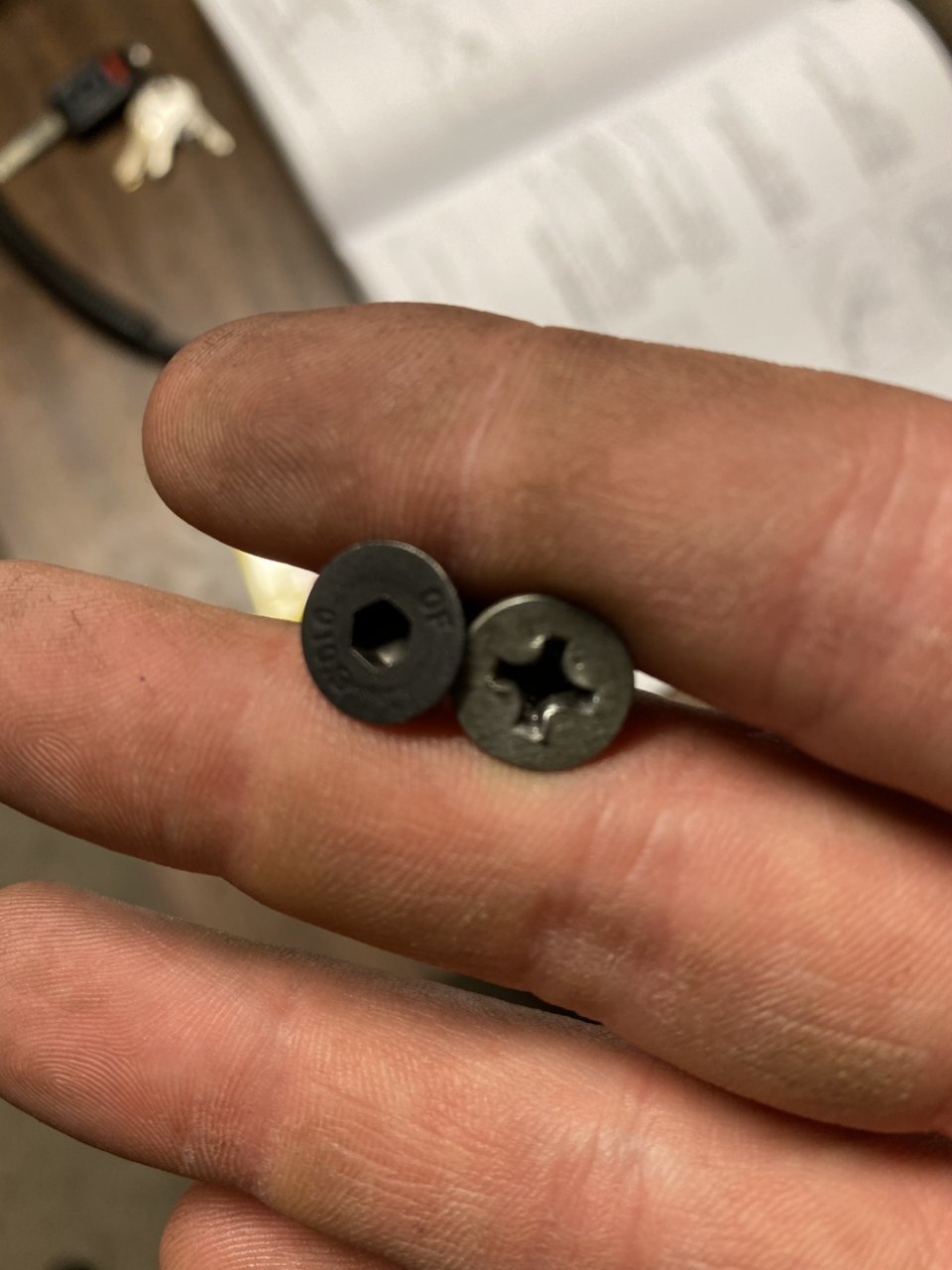

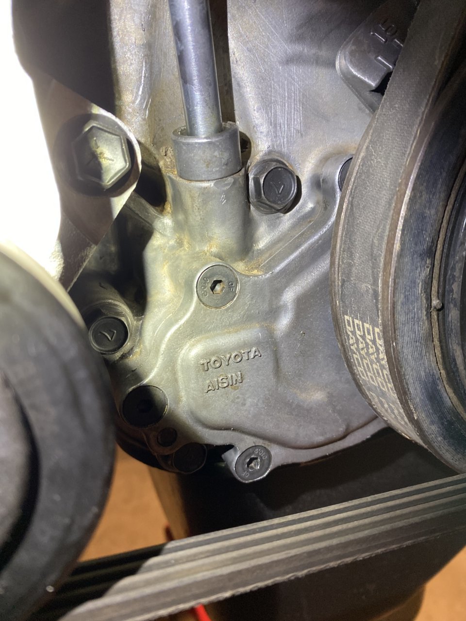

    I replaced the oil pump cover screws with Allen bolts. Looks better and easier to remove in the future.
    Ready to install!
    After priming the system it started up strong! The best thing is, no check engine light!
    The engine was the last item I rebuilt on the truck. Everything mechanical has been rebuilt now. It’s like a brand new truck with a shity paint job! But hey, it’s my adventure truck!

    Good move placing the oil pump cover screws. I had to drill out almost all of them when replacing my Dad's timing chain on his 95.5 3RZ. It had around 160,000 and the chain got loud. I know that's the exception, but it happened.

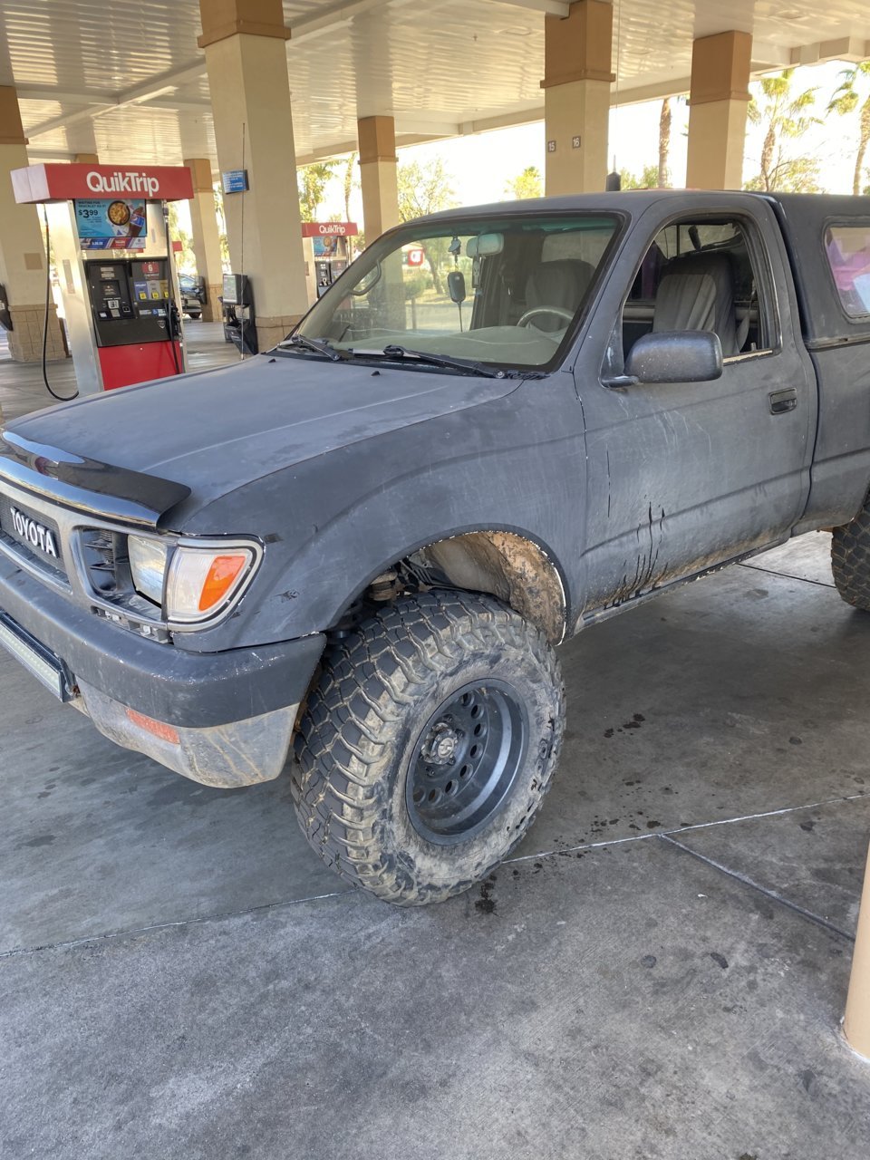

    Nice! How did you make or where did you buy that front grill?

    I had some trouble with those screws as well! Probably won’t have to take the oil pump off again, but it will make it easier.

    Patina! Very hip.
    Maybe a DIY Monstaliner refinish is in your future? Not for glam as much as for a bit of sheetmetal weather protection.

    After looking at those pics of the rebuilt engine again, that motor is really clean looking, nice job.
