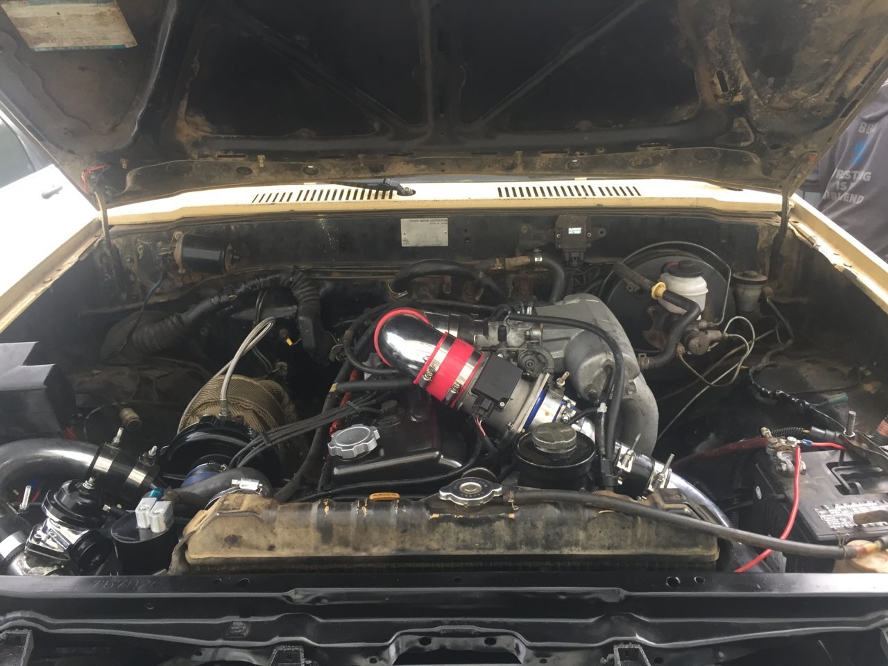

    It's less Tacoma and more mod
    Doesn't look like his MAF housing is the right diameter
  2. Dec 15, 2018 at 8:21 PM
    #42
    Cam_85yota
    Cam_85yota [OP] Active Member
    Dec 14, 2018
    #275845
    28
    Cameron
    Roseburg, OR
    85 Toyota Xtra Cab
    3rz swap with a turbo
    Yea I stepped mine down to a 2 inch pipe. That might be where I went wrong. I might have to run piping the same size as stock then neck down on both sides like madtaco did.
  3. Dec 15, 2018 at 8:23 PM
    #43
    Speedytech7
    Feb 20, 2014
    #123587
    58,338
    FCQM+VG Cheney, Washington
    You can step the piping around the MAF housing down but the housing itself must be the right diameter and ideally there should be a straightener in front of it. Stupid old things are very picky. I wish we could use speed density metering

    Yea I’ll have to build another where it sits into a 3 inch diameter pipe. What is the straightener you guys are talking about? Just kind of a like a strainer from what madtaco posted? Have never heard of this until now.
  5. Dec 15, 2018 at 8:28 PM
    #45
    Speedytech7
    Feb 20, 2014
    #123587
    58,338
    You might think of cannibalizing your stock maf housing to make it, it is chambered to make the meter read properly, and you'll notice the stock housing has a piece of mesh to straighten the airflow.

    Diameter at the sensor is important. The rest doesn't matter.

    This was how I had it before but I hated the look of it. Maybe it’s best that I just put that back on until I can make a housing comparable to stock.

    Might have to order that and give it a shot. Looks better than what I had before. That otta put it back to somewhat normal size.

    Well I had started having the idle problem before I changed the intake so I had thought the idle and load issue was correlated. I’m about to go out to swap that intake and see what I come up with. Yea I should’ve thought about that quicker lol I appreciate the help in finding my own stupidity :crazy:

    So I put the old one back on and it idles with a load reading around 23%. I think it’s just a tune issue now. It idles for a little while at about 15.5:1 then slowly leans out and will stumble. I might have this figured out now. Been chasing this for 2-3 weeks now. Could be real close to some winter wheeling! I know it’s not a taco but I figured I’d show what I’m working on. Had it since I was 15 and it’s been my project ever since.
