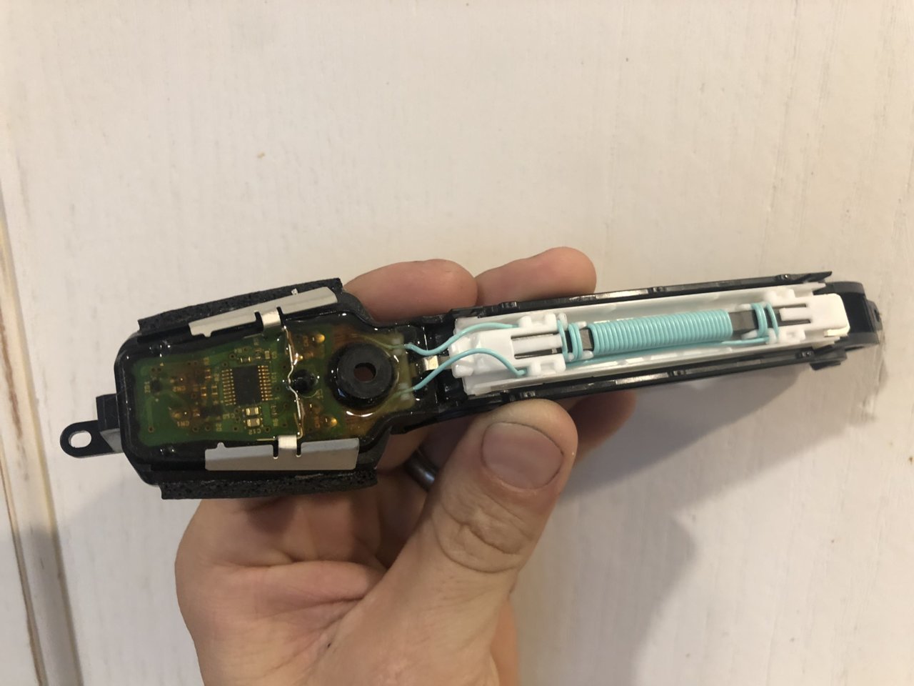

    Look promising?

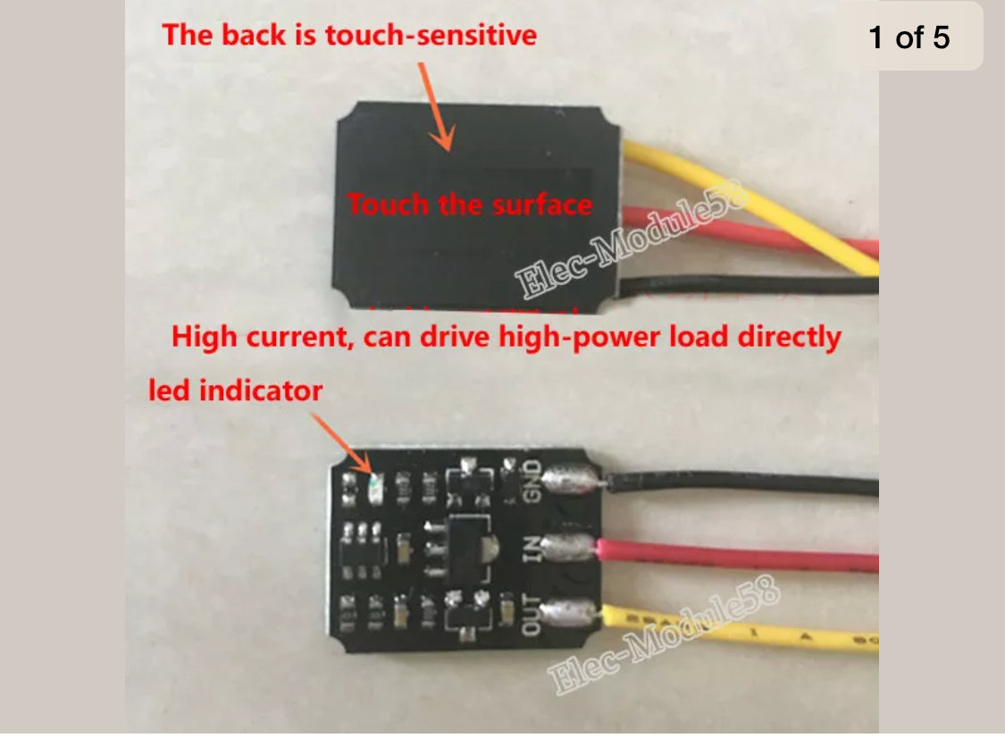

    Not really Without alot of hacking. The light green coil(see pic) is wrapped around a captive sensor which you touch on the backside. The lock is the 2 metal tabs on the top.
    In my case I’m more worried about just dropping the tailgate without a fob.. so it would essentially be isolated from the pop-n-lock, and from the truck itself. I think a universal touch sensor mounted up inside the handle to activate the solenoid would be the easiest. Like this
    Smart handle
    But still at the part of only letting it drop if near proximity
  14. Apr 28, 2019 at 7:18 PM
    #54
    DSIM
    DSIM [OP] Well-Known Member
    Feb 5, 2018
    #243518
    887
    Daniel
    Raleigh, NC
    2017 MGM Tacoma TRD Off-Road
    Is it all one board? Or is there a separate piece that is the responder to the key fob. Just really need that then a universal touch sensor could work.

    Ya the PCB is a satellite. Might be able to wire in your own sensor to activate it, would just need to test that there’s no weird resistance values the board is looking for. Having a touch to lock wouldn’t be a bad idea. Wonder if stock proximity works that far back.. I haven’t checked.
