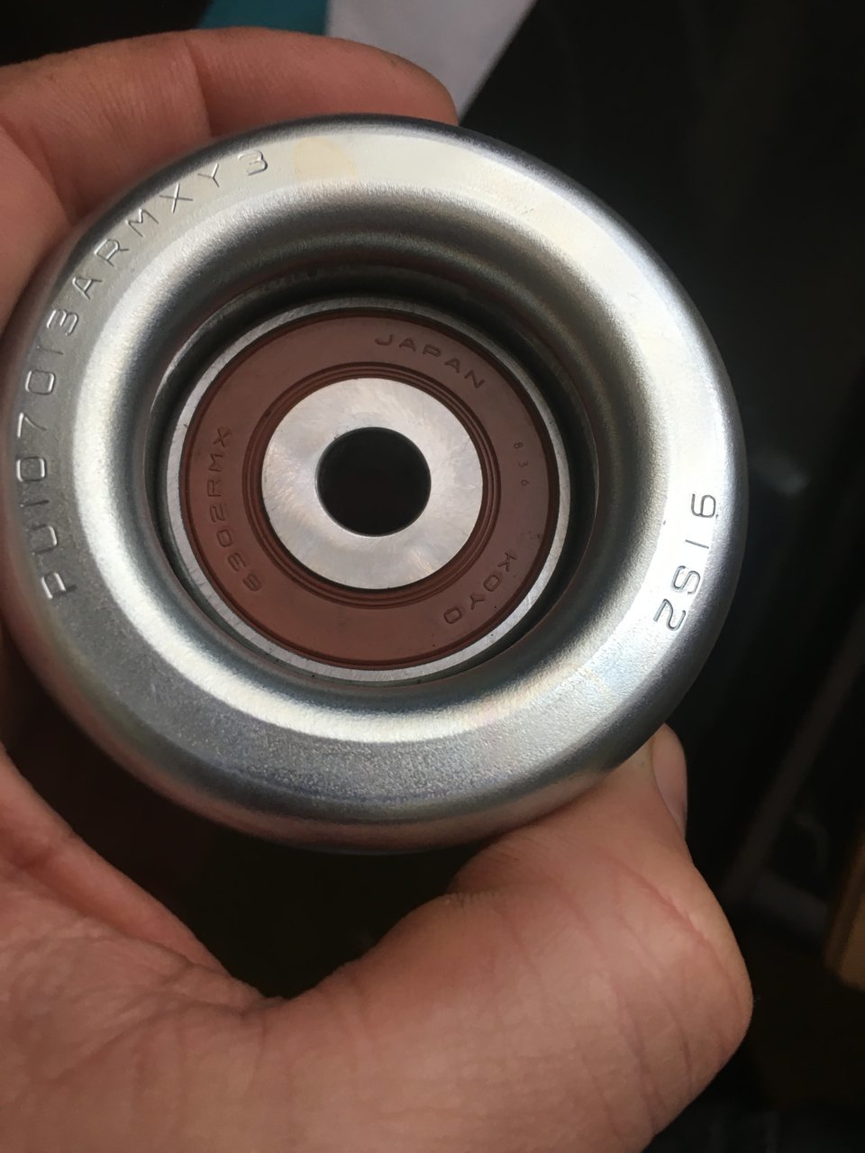

    I just got OEM pulleys from Toyotapartsdeal.com. I agree that the “K” on the eBay bearing does not look like genuine Koyo. I believe the eBay bearings are fake as hell.
    pic of genuine OEM:

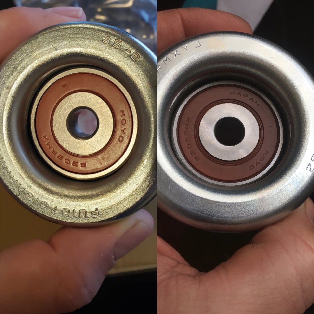

    eBay (left) vs OEM (right)

    Note that genuine Koyo says “Japan” on it, but eBay bearing does not. Also the genuine Koyo bearing and pulley just looks like it’s machined nicer than the eBay version.

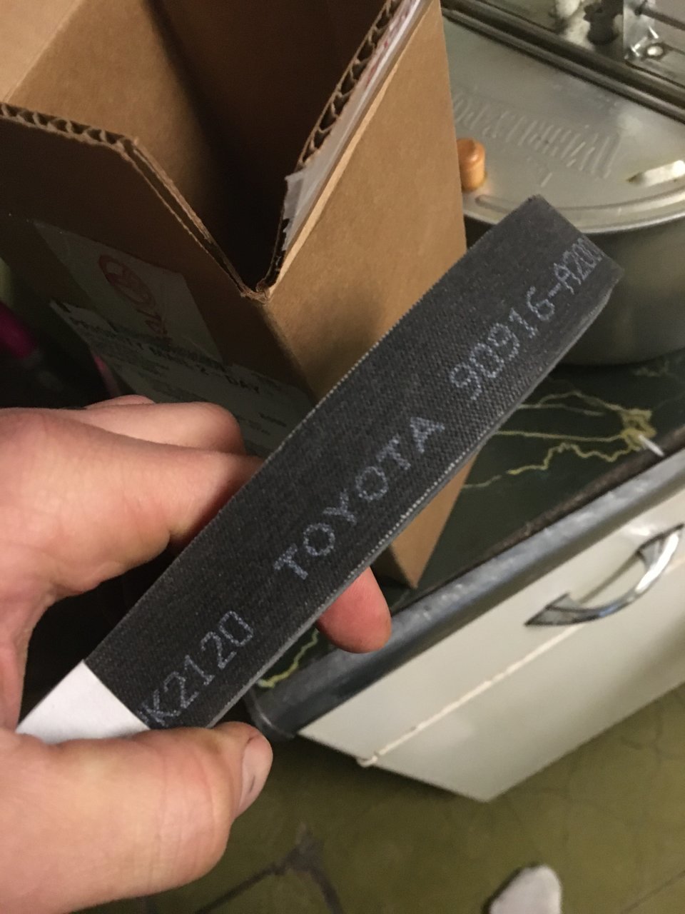

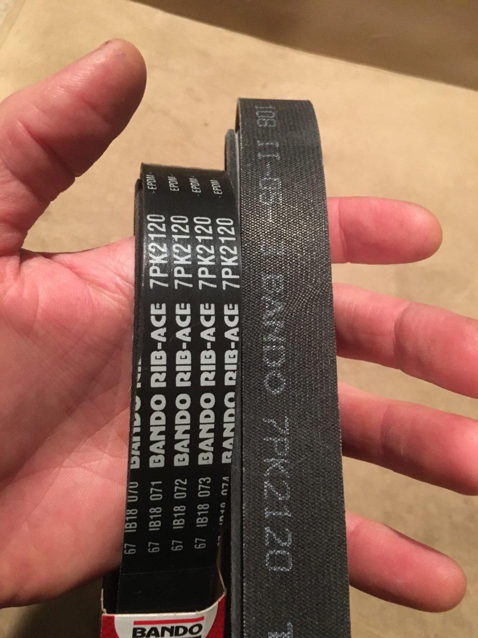

    Keep in mind the Toyota branded OEM parts may be different than the same brand part made for the aftermarket. The Bando belt is a good example of that. Toyota sometimes has higher standards for parts with their name on it than what the manufacturer normally produces. The term “OEM” can get a little murky sometimes.
