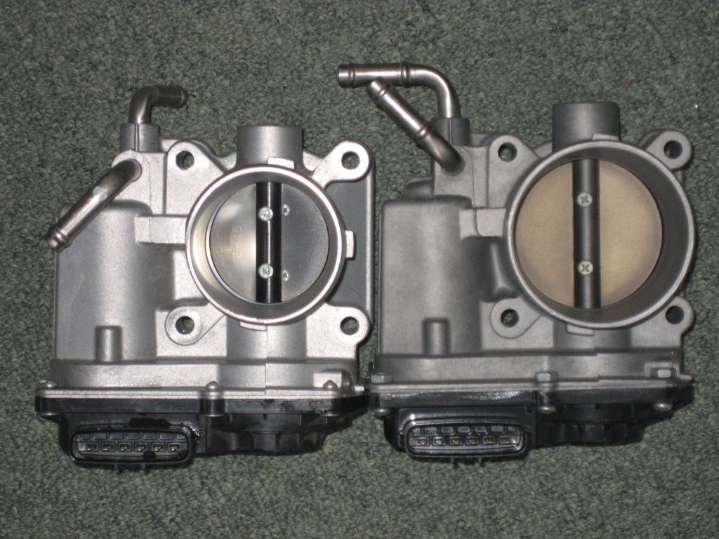

    Could any of you 4.0 guys tell me what the bore diameter is on your 4.0 throttle body? And also do you know the distance between the studs? I'm exploring the possibility of adapting a 4.0 throttle body to fit onto a 2.7 engine.

    For comparison, the 2.7 throttle body bore is 61mm and the bolt pattern is 65mm square.

    4.0 ID bore is 65mm

    It's good that the difference in only 4mm which raises the chance that the bolt pattern might be the same.
    Does anyone know the distance in millimeters between their throttle body bolts?
    That measurement could be also obtained from any 4.0 manifold, flat gasket, or throttle body spacer.

    Bump. Is there anyone here who can measure the distance between the mounting bolts on their 4.0 throttle body? It would be a great help.

    Roughly 6.9 cm top - top, and ~6.7cm top - bottom.

    Ok. Thanks for your help, Tor. :)
    So the bolt pattern isn't 65mm square. That rules it out. :(

    Just a few mm's. The 65mm 4.0 would be a logical candidate because of the same wiring and ECU controls. That's key to making it work. I'm going to my local auto wrecking yard to measure the bolt pattern for myself to find out for sure whether or not it's 65mm square like the 61mm 2.7 throttle body is. :thumbsup:
    My 1.5 Yaris had a stock 46mm throttle. A 51mm Corolla 1.8 throttle body works great because it uses exactly the same electronic controls and has exactly the same bolt pattern (60mm square).
    I had an adaptor plate CNC designed and machined so that it would work. I believe that exactly the same approach that worked on my car would also work on my truck. Besides a header there's absolutely nothing else to enhance the normally aspirated performance of the 2.7. So it's a wide open uncharted land that is already lots of fun to explore. :)

    not sure if this was mentioned, but URD has a tb conversion for the 4.0 in our trucks to mount the slightly larger tb found on the newer 1gre's with dual vvti in the fj/4runner. if you could get in contact with them im sure theyll have numbers and pix for you
  20. Aug 21, 2013 at 11:29 AM

    There's an auto wrecking yard for Toyota pickup trucks and SUV's not far from me. And when I go to measure, if the bolt pattern is 65mm square, I can pick up a 4.0 throttle body when I'm there. :thumbsup:
