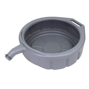

    What can I do for my 4.0 when pulling the drain plug to keep it from being so forceful. Mine hits the pan and bounces right out for the first few seconds??

    That's a good thing. Fast flow helps to flush solid metal particles out of the engine oil pan.
    Use a taller pan like this one: http://www.autozone.com/autozone/accessories/FloTool-5-gal-oil-drain/_/N-25yj?itemIdentifier=134895&_requestid=2496257
    Put a splatter pad in the pan if it isn't enough: http://www.oreillyauto.com/site/c/detail/LIS0/38780/N0027.oap
