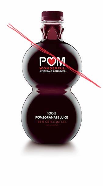

    I used a POM 48oz bottle under my oil filter fits perfectly all I had to do was cut the bottle at an angle and place it directly under the filter.
