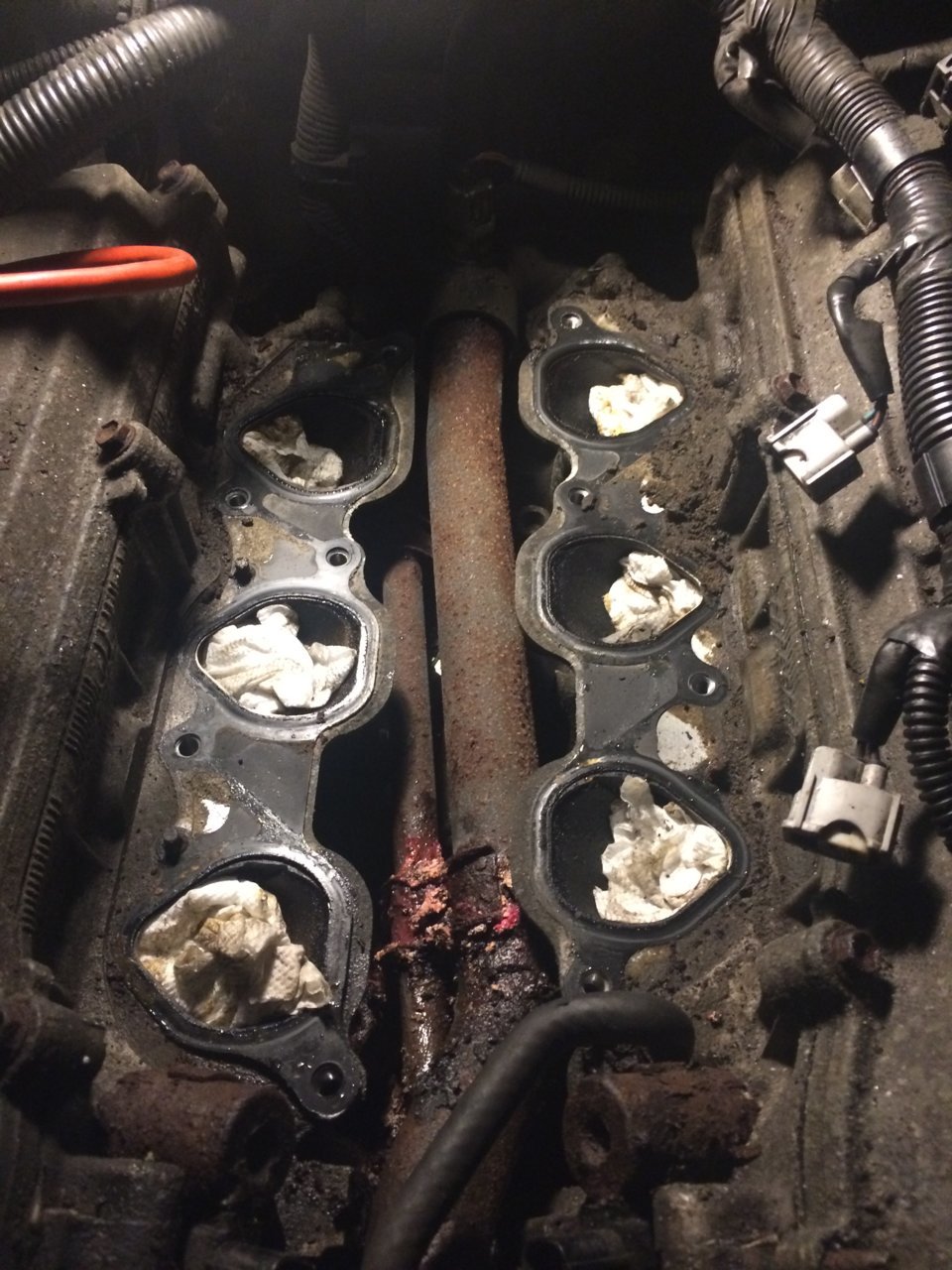

    New motor is out as they are non existent where I live and if I was lucky to find one it would have been living in the same environment as this one did.
    @Bishop84 can I have clarification on your above comment about pipe failing ?
    You have only heard about the pipe failing, how does it fail ?

    So there is no white smoke from exhaust, and no smell of Coolant or sign of it in oil. It goes down over a period of time and there are no signs of it in the driveway.
    I do smell the sweet smell of antifreeze every now and then

    The pipe could corrode and leak from the valley. I've only heard of it, I live in Calgary, land of wind and sunshine.

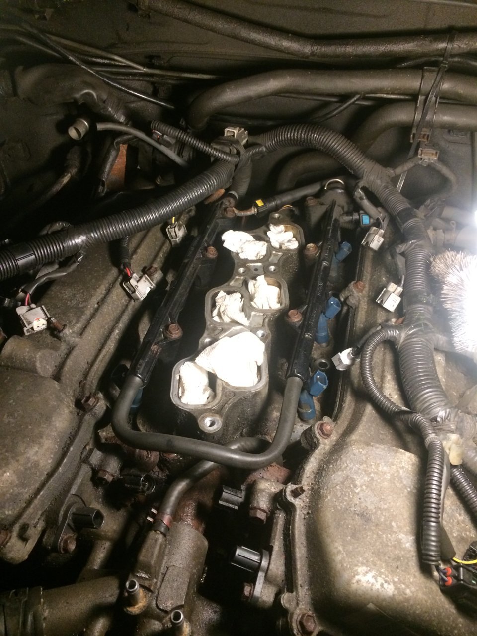

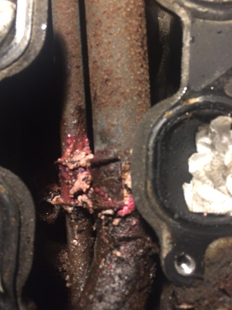

    I will get some better pictures tomorrow
    I do not want to poke at it and make it worse
    I am willing to do water pump and o rings t stat, but can’t pull head and remove pipe not at this time

    Am I fooling myself by saying this is a just a o ring leak ?

    @Taco'09 Thanks i posted it in our local Toyota fb group and a guy came back saying that it can be removed without taking off the head :)
    I think mine was a failed o ring on this pipe
    IF it still leaks i will be going back in

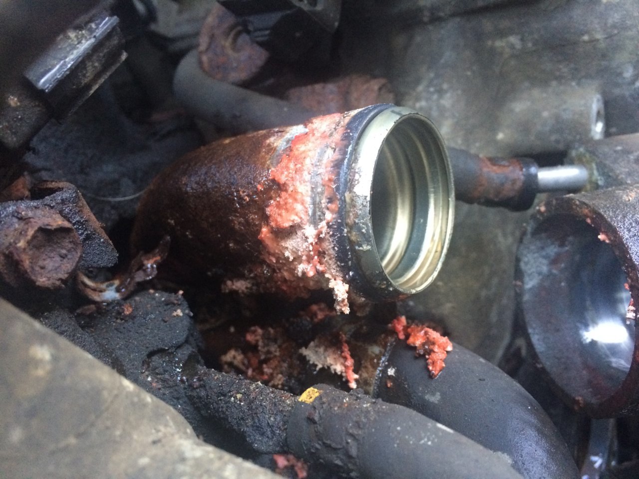

    So it leaks worse then before ffs !

    Did you lubricate the o-ring prior to reassembly?

    @Torspd I did :)
    I was underneath and looking up at the back of the motor and the end of the pipe assembly the (small one) has a J turn it in and it looks pretty rusty and flakey and wet.

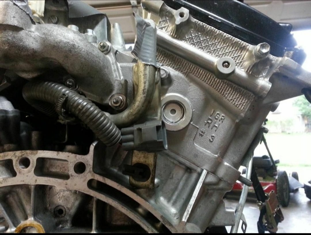

    This one.
    Is that due to the heater hose, at that connection, having a poor seal? As if the hose has aged too much and needs to be replaced?

    @Torspd i will have a look but i don't
    think so .........

    Damn it man. :pout: Swapping in a new one this time it seems? Should that be the case, coat the new one with some enamel paint first.
