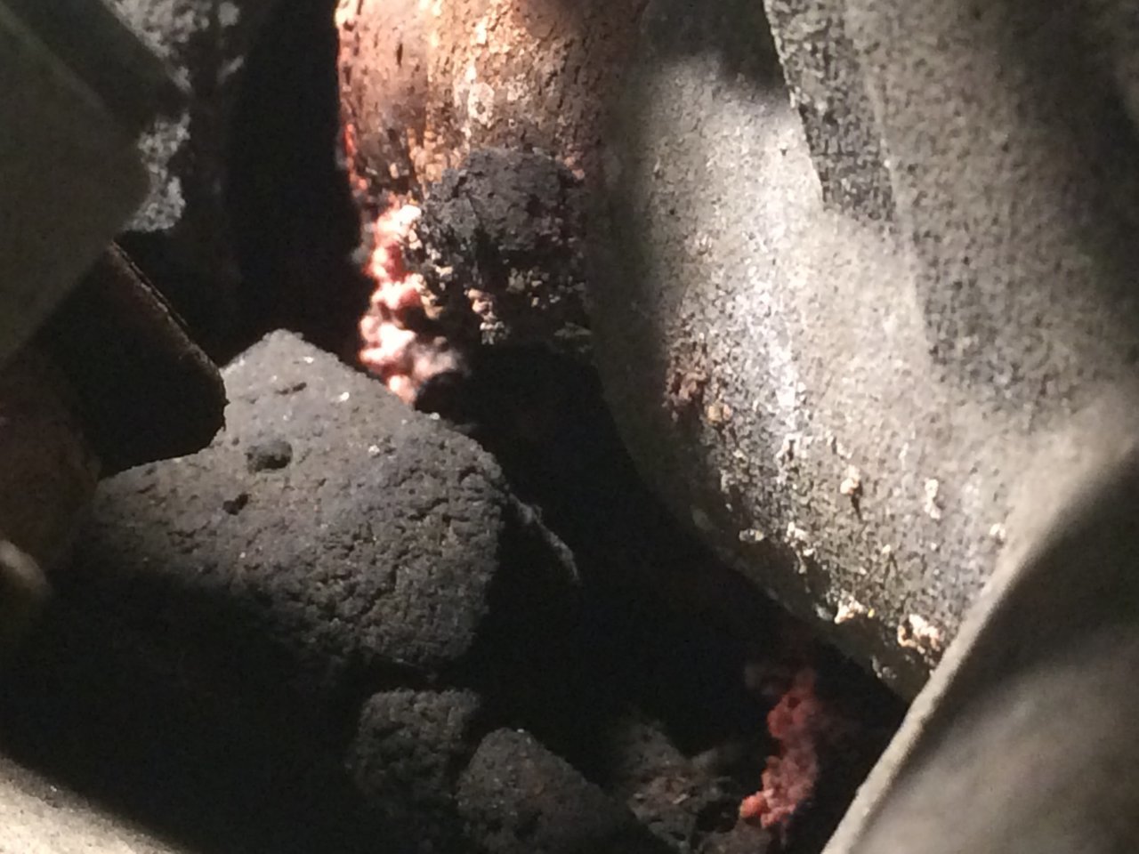

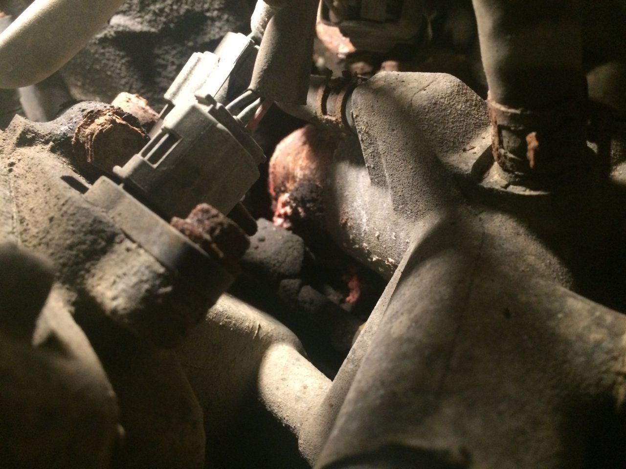

    This is the front of the motor red crystal is antifreeze around that pipe Where it goes into the aluminum housing

    Wow, you have to remove the cylinder head?

    The coolant is very corrosive and that pipe is definitely leaking.
    I'd suspect the water pump is leaking as well, which includes the orings for that pipe.
    I'd also check the radiator for a leak.
    Lastly the headgaskets leak coolant, its easiest to see the leaks from underneath looking up at the headers.
