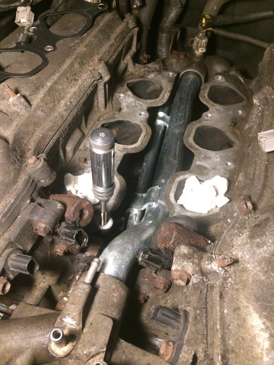

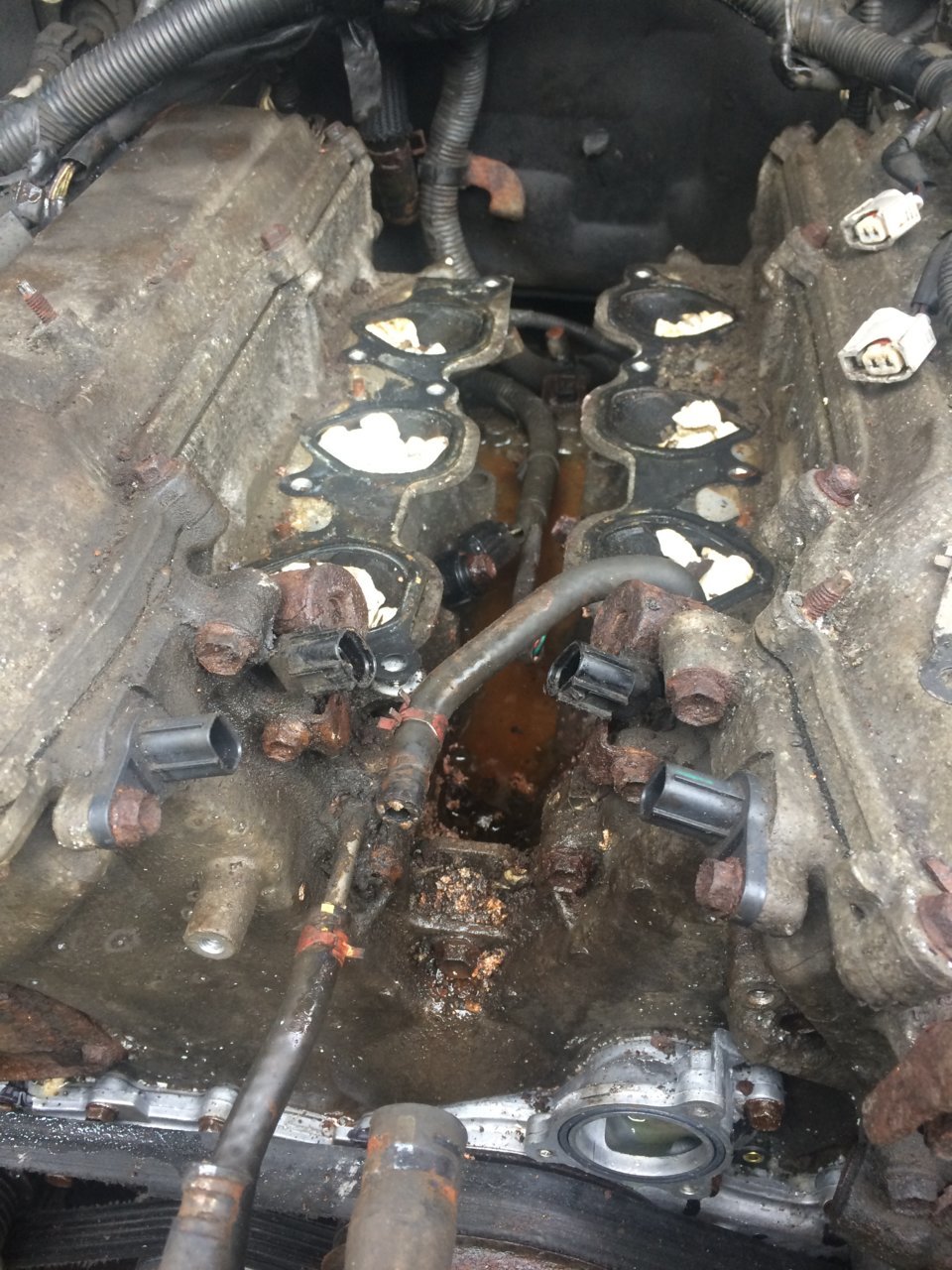

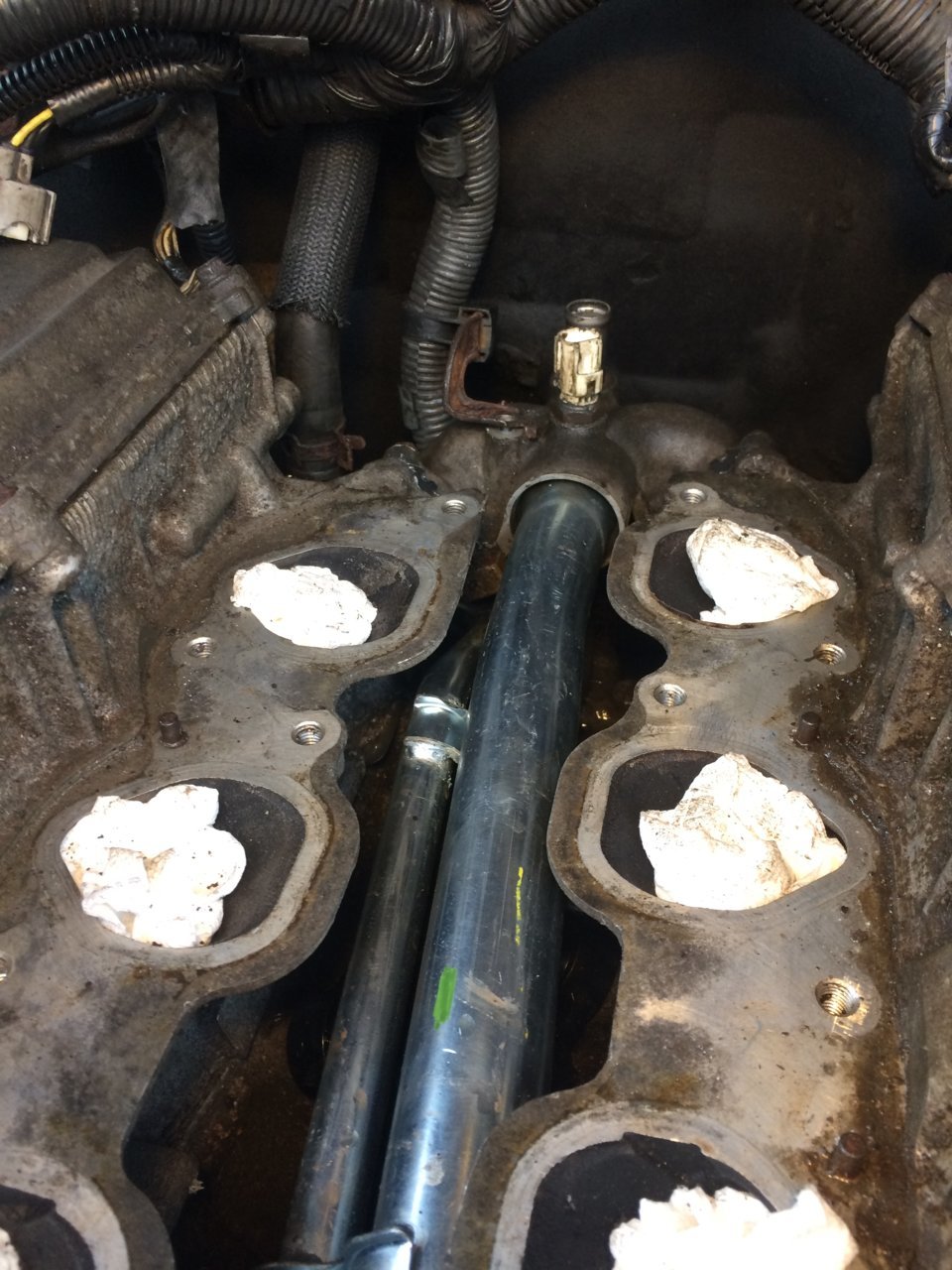

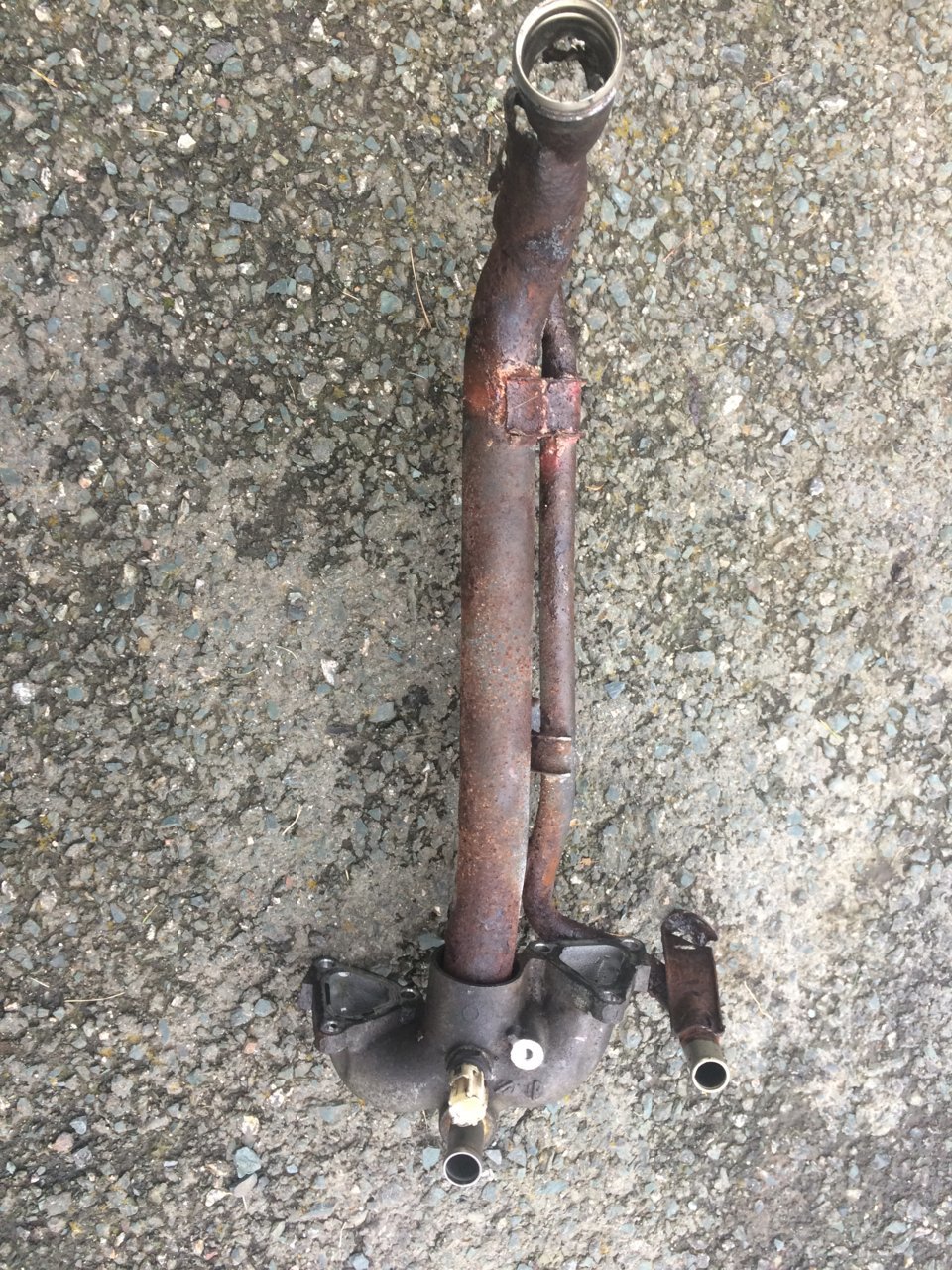

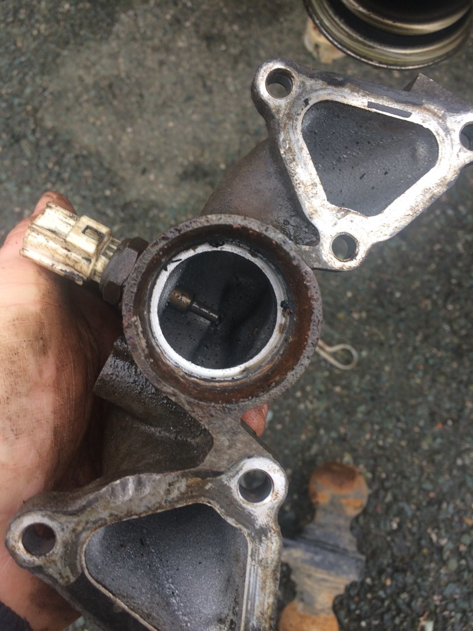

    That sucks, I had an issue with the knock sensor wires that are just below that pipe and had to splice the harness to avoid removing the pipe.
    Be careful with the brittle wiring connectors on the knock sensors below that pipe when trying to remove it. And yes a head has to come off to do it right.
    I read an article here where somone cut the bracket that holds the 2 pipes together with a hacksaw and was able to remove one by one.
    search knock sensor problems/replacement articles.
    but that left the front and rear orings as the only thing supporting the pipe once assembled again.
    Best of luck

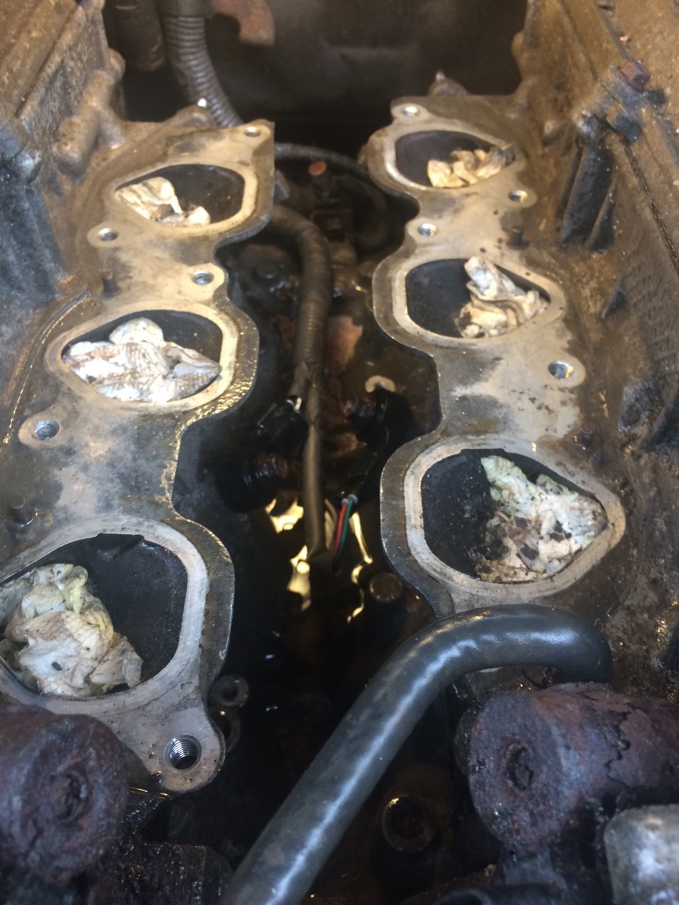

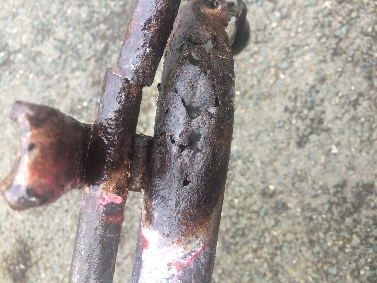

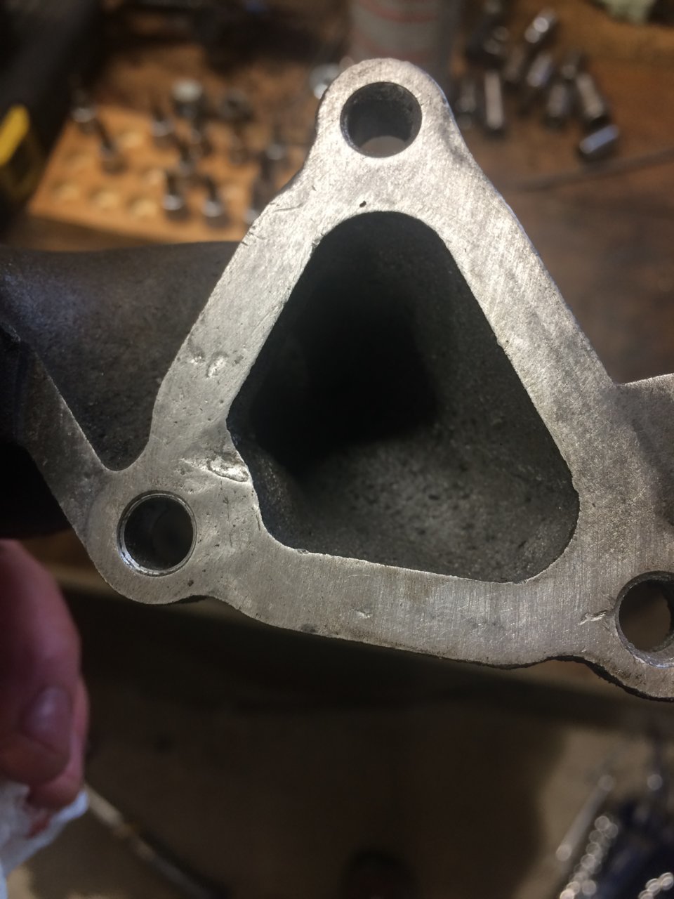

    Those pictures make you wonder if it didn't develop a hole(s) where the bracket is attached. It's hard to tell but it looks like the bracket is riveted on in that second picture?

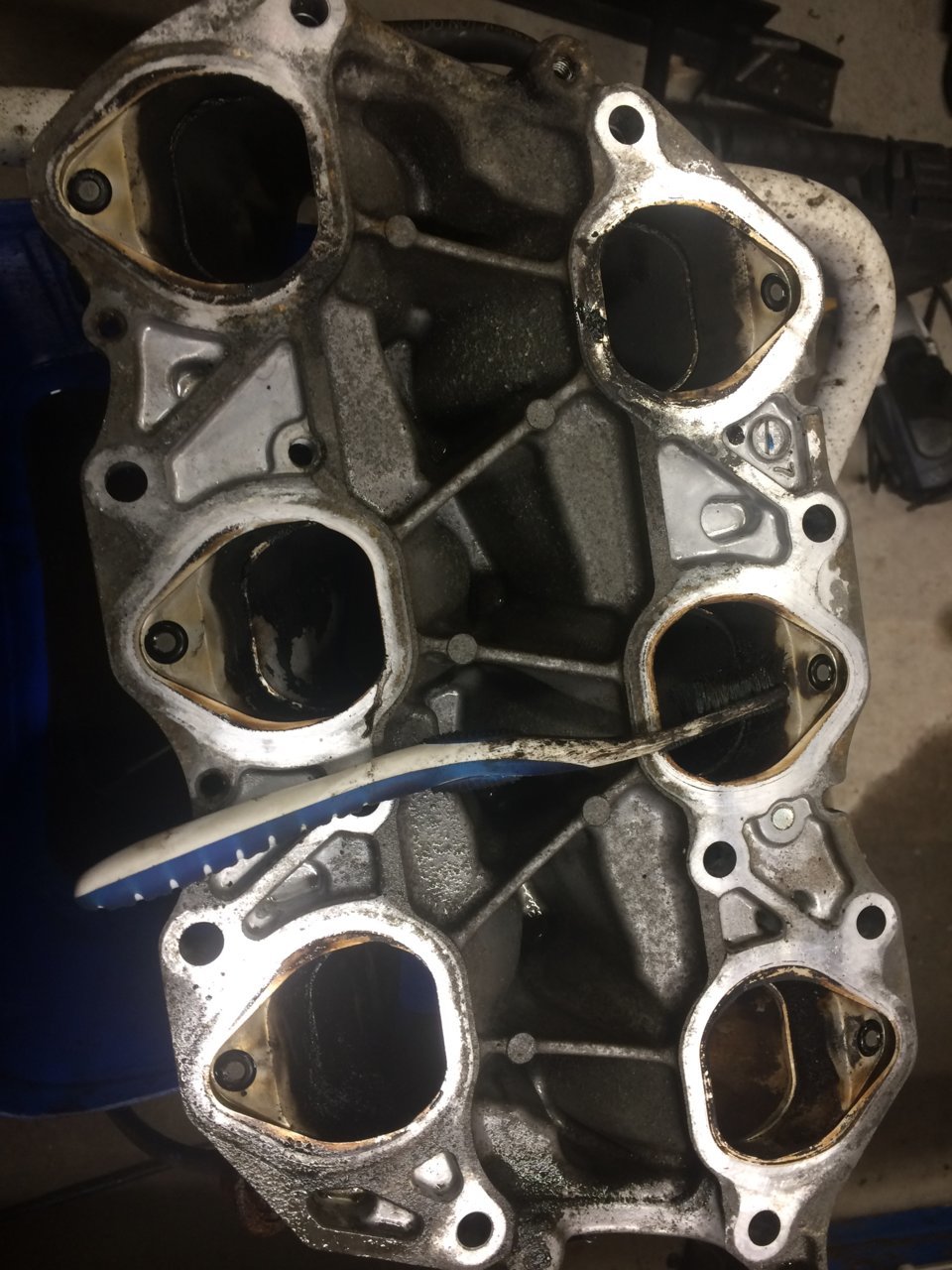

    FB06986C-E4C0-4D0A-961C-63969A474ECE.jpg 95CC4944-32CD-418B-9AF3-F69B3041BE97.jpg 8E249510-FCA2-4802-8B20-1AD7197CBA15.jpg 7FBBB910-C47D-478F-81B1-1CB4F787F718.jpg C3C6AED3-BBA4-47FA-9A72-A8D618FEE090.jpg F5094340-C7F4-4F82-A0F4-C350007CB614.jpg C095FF82-90C3-46EE-9C2A-0CC57D6F5F42.jpg 5EF5EC93-A2ED-44DD-B9CF-F0F434CEF2E9.jpg 234B819B-5729-4C9B-8F42-BCE35B29A56A.jpg F56009B2-DF29-4479-BDB2-1CE18D6AC5C9.jpg 339C7602-0081-49C0-88A1-5EA11567C2AF.jpg 3E5E6DB5-3FBF-42AA-916E-C4FA86B928C6.jpg 8FF5BC7A-1973-4940-919A-C149A3DA15B6.jpg F7DC1571-8BAB-468F-8094-D08E9F26BD95.jpg 5C5E2AA0-F19F-4296-A341-628BCD656420.jpg

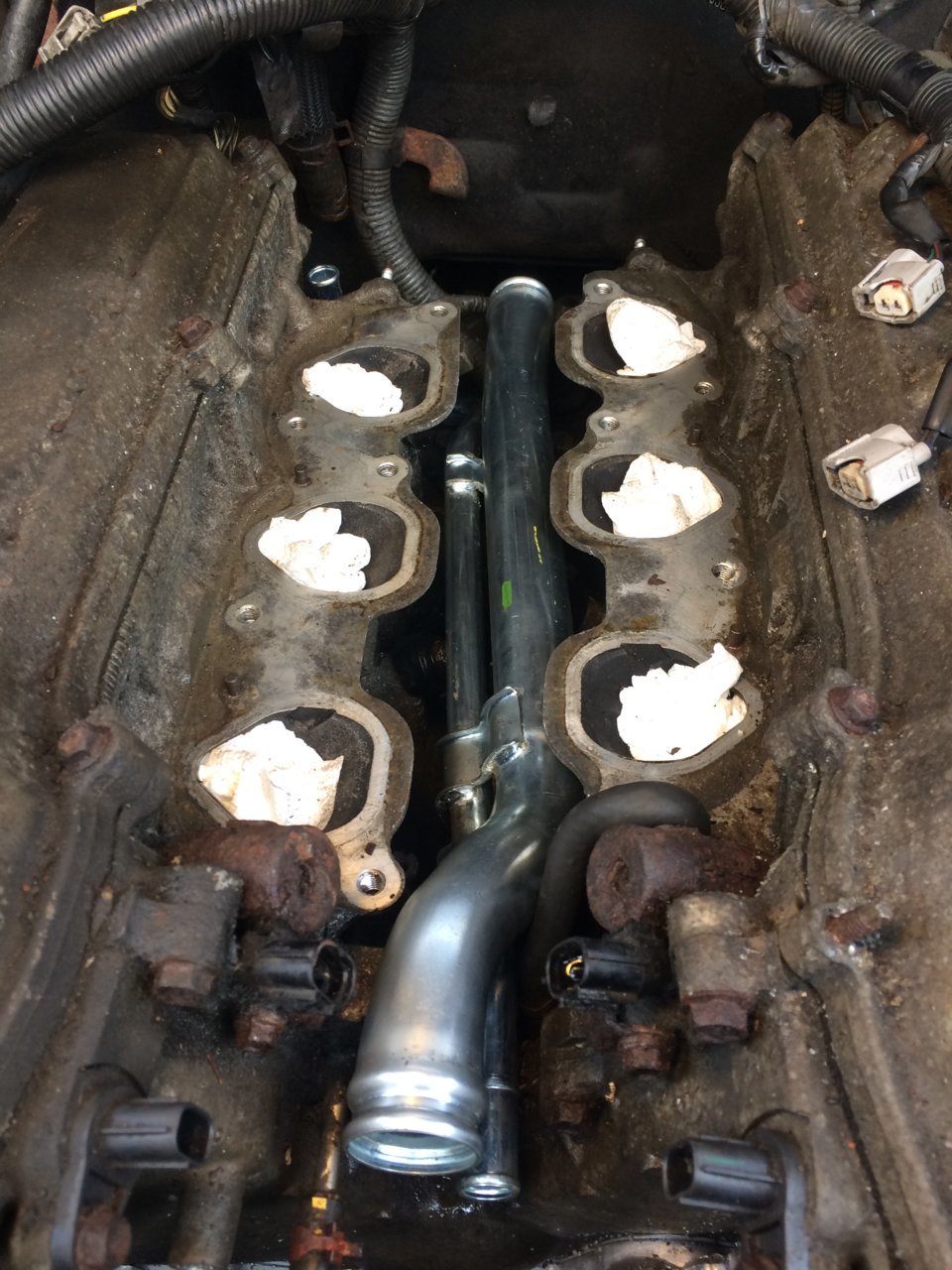

    Just waiting on intake gaskets now. And for next week I will still car pool with my wife as we will be doing rear axle bearings just for fun !
    Or because they are shot
    Stay tuned.......... I need a drink

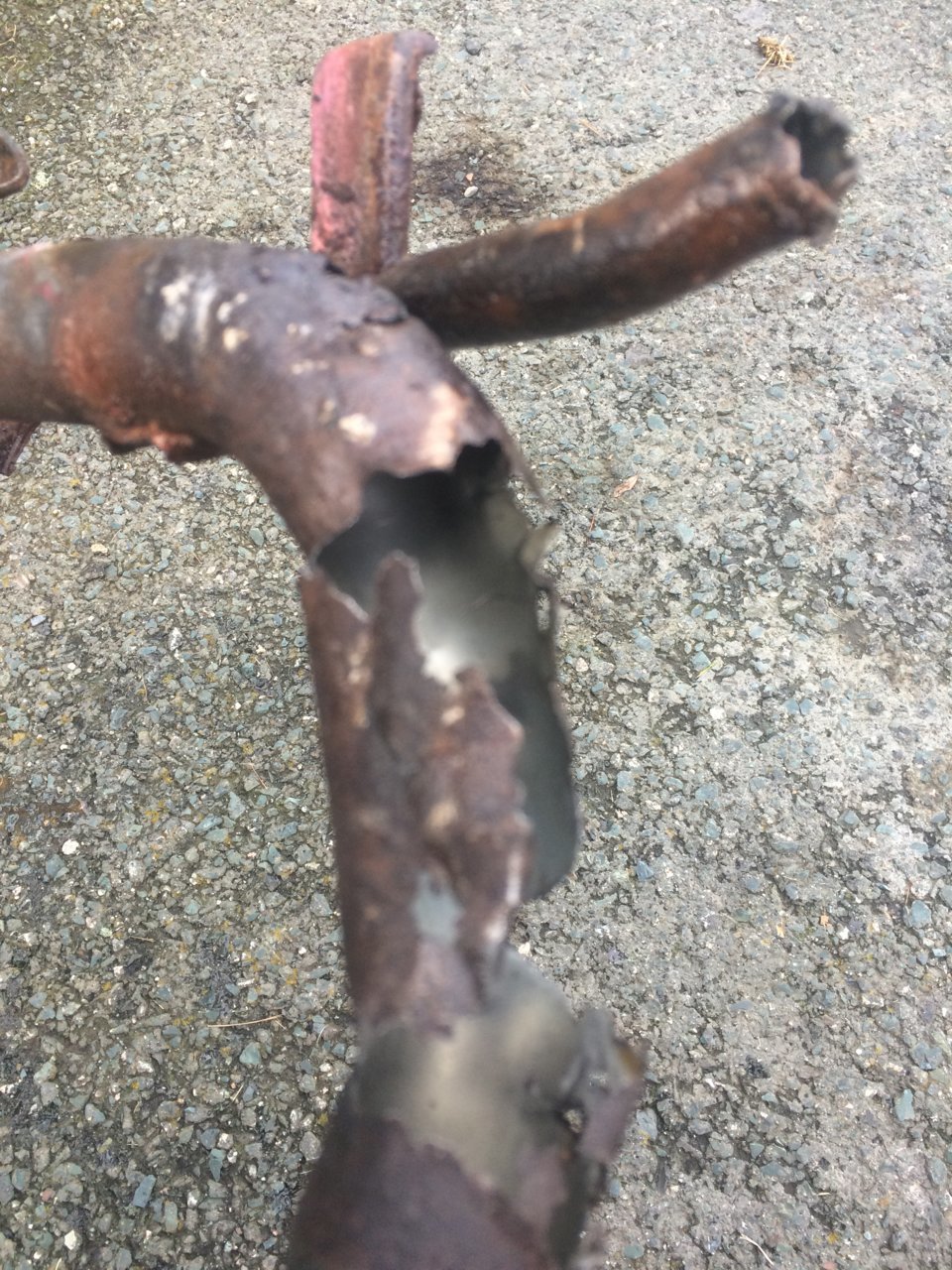

    Wow! What a mess. Almost makes you want to send the new one out to be ceramic coated.

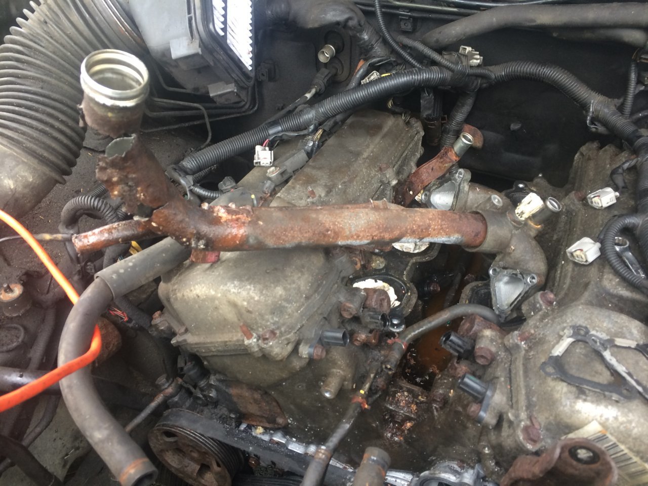

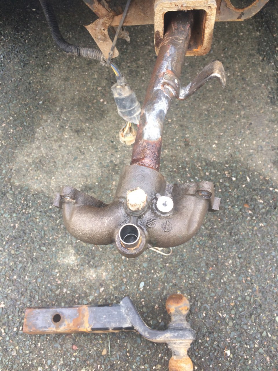

    Needs to go on a cardiac diet. That salt is killing it. Lol.
    Glad you got the new one in though.

    If you have any access to some form of marine salt away ,or something of that nature, that would really help.

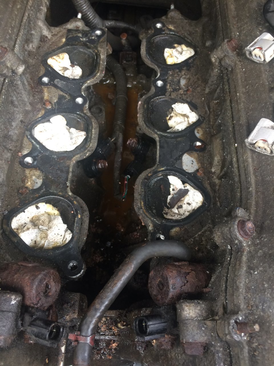

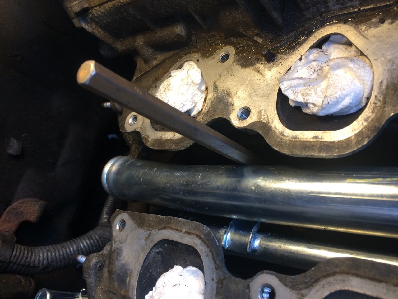

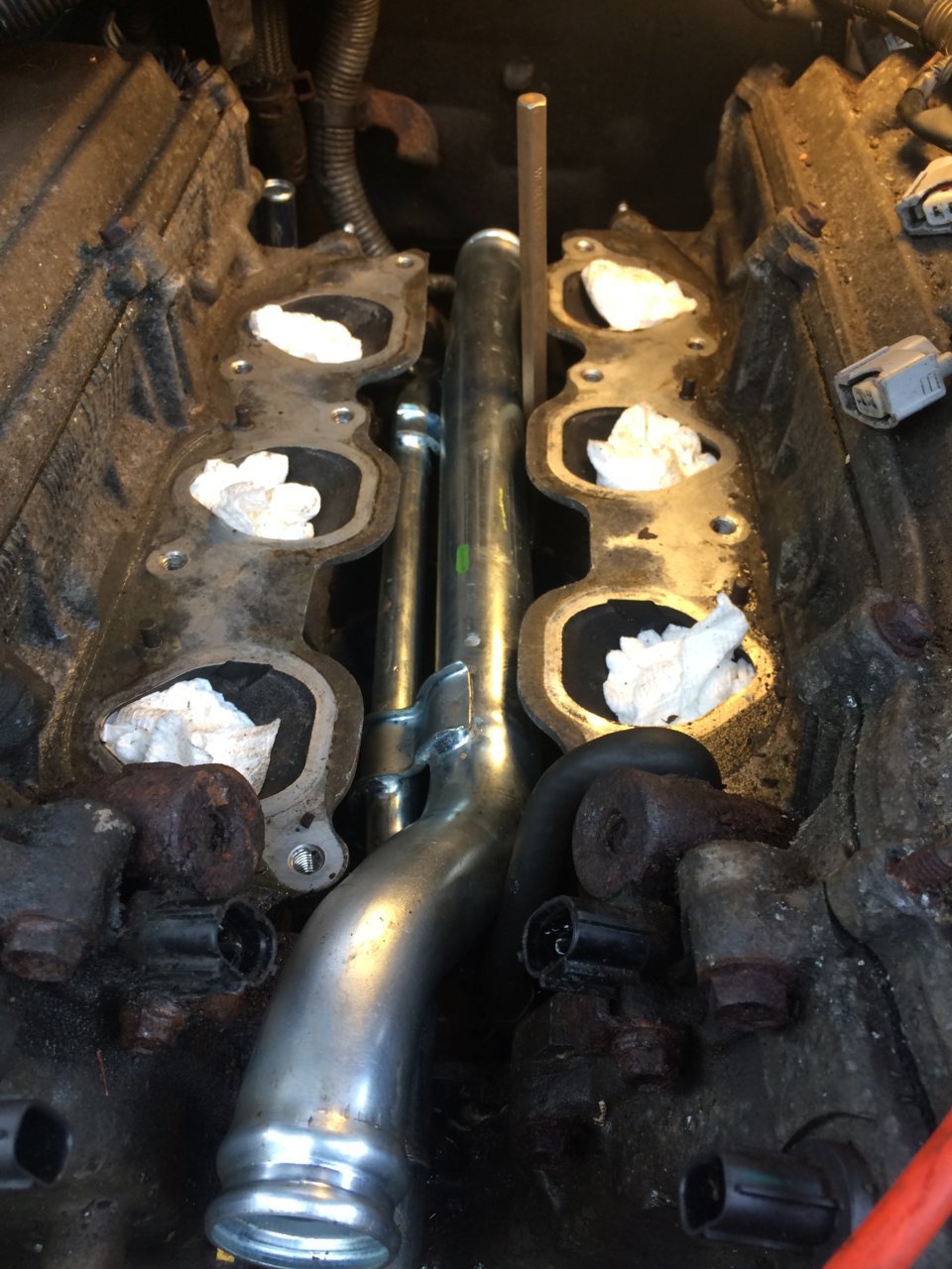

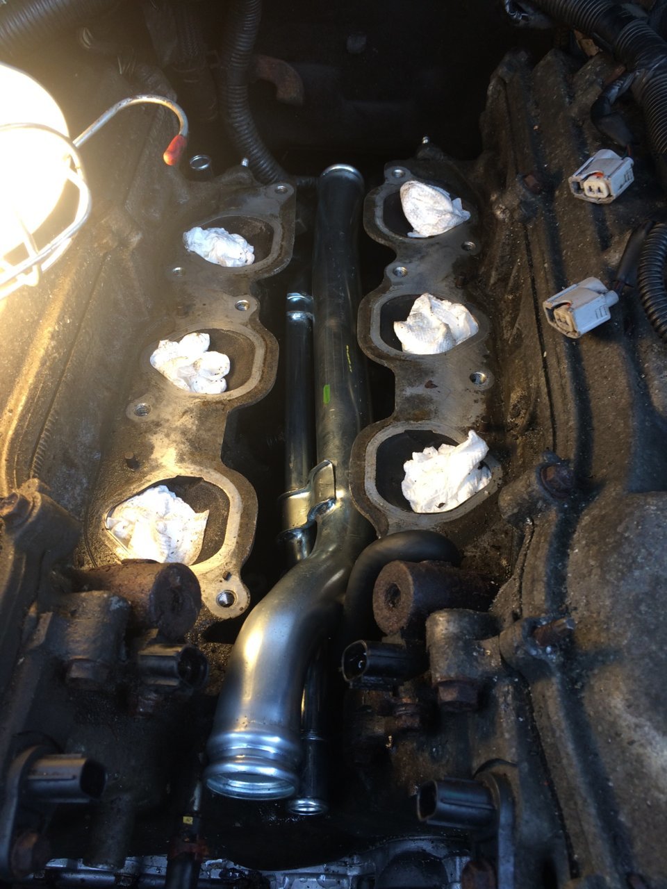

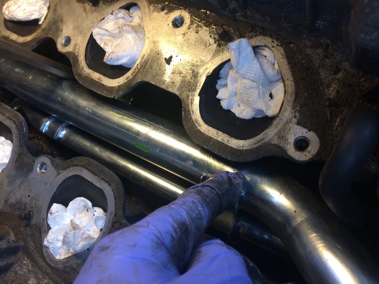

    Someone in this thread has been insisting the head had to come off - which you obviously didn't have to do. How did you install the new one?
    Jon G[OP] likes this.
  12. Dec 6, 2020 at 11:47 AM
    #52
    Jon G
    Jon G [OP] Hoarding Tacomas one at a time,
    Jan 25, 2017
    #208594
    1,851
    Jon
    St John's Newfoundland Canada
    02, 04 & 07 Tacoma
    Magnaflow 2.5 Catback Exhaust K&N filter
    @Fullboogie

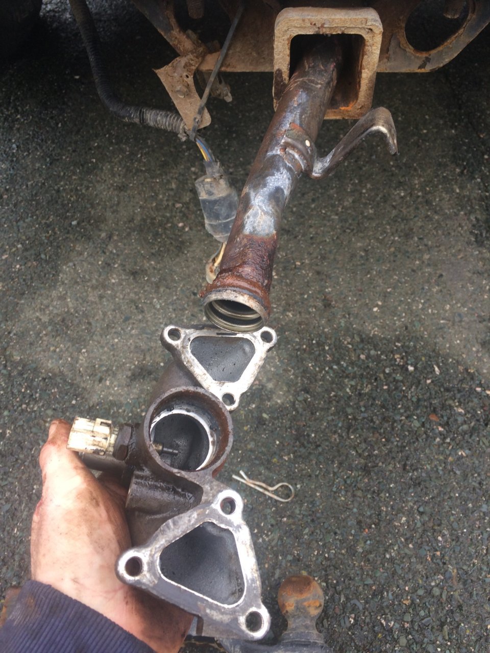

    The Fsm says you need to remove the head and to do it 100% the right way
    But this was not a route I wanted to go down as it is a huge job as most of if not all the components on the front of the motor need to come off as the timing cover needs to come off for the chain. Then the cam then the head and with 436000km it would turn into a can of
    My pipe was so rotted that I took the bolts out and was able to twist it to get it out. I stuck a pry bar in the pipe and bent it the old one.
    Putting the new one in is tricky I bent the mounting tabs to allow the pipe to be placed in. I also used a pry bar to finesse it into its location. This put a small dent on the new tube under here 29D00944-8BCF-4C0C-AA2E-7DBC0B7CA7B0.jpg
    If I had my time back I would of bent the small pipe closer to the big pipe on the front as a hose only goes over it. Do not deform the ends just a light bend
    I used a punch to put in the hole of the bent bracket to straighten it to the proper location and slid the punch into the bolt hole in the block.

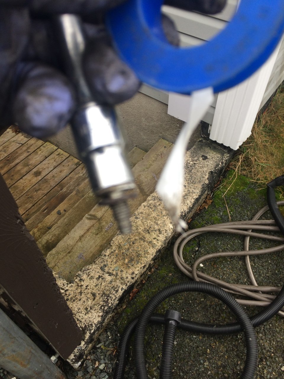

    I also used some plumbers tape to wrap the heads of a few bolts so they would stay in the socket
    Would I do this again 100% yes !

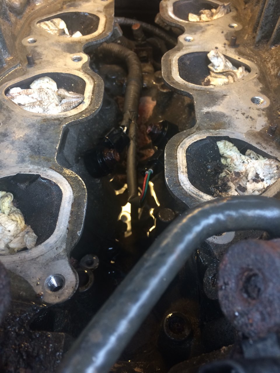

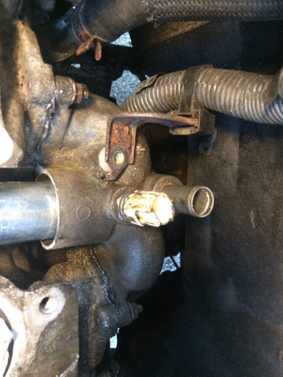

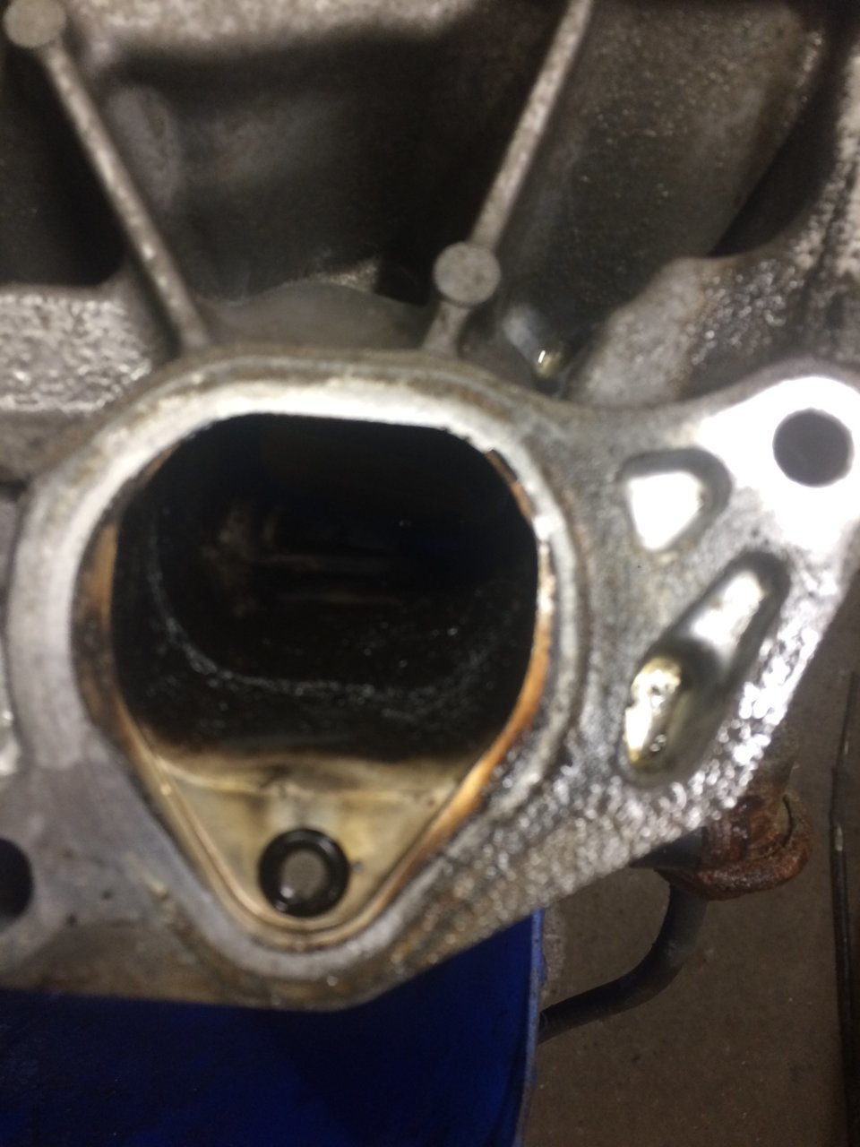

    Tapping fun. I think where the two front ones are open on the bottom when I pulled the bolts up the rusted end messed the tread?

    Corrosion X every freaking thing. Sheesh.
