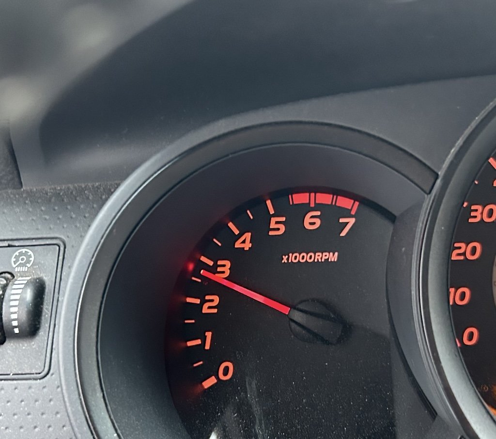

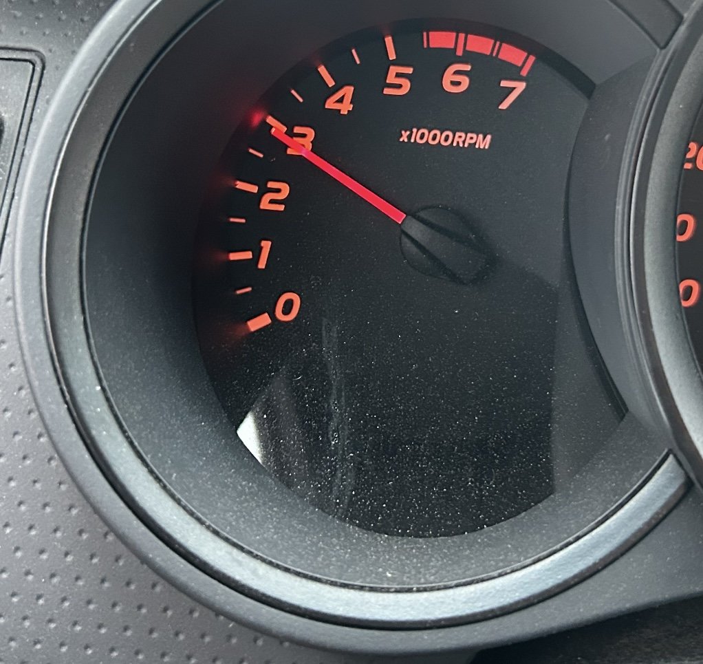

    went 4.88
    Makes me wonder if I should’ve gone less like 4.56
    snapped dash pics from highway RPM
    GPS 65mph
    GPS 70mph
    not sure exact RPM due to no scan gauge.

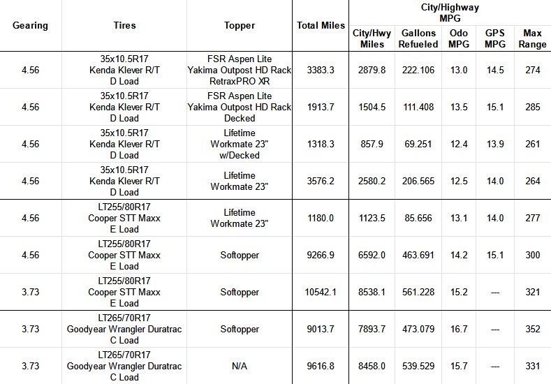

    As a point of reference on the relationship between gearing, tire size, weight, drag, and gas mileage since I bought the truck. YMMV, literally.
